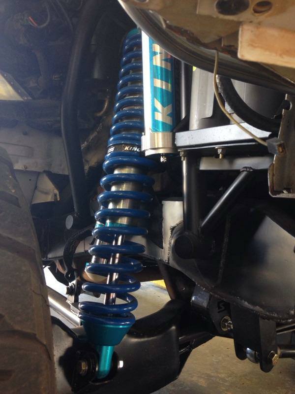

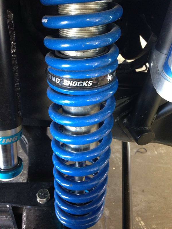

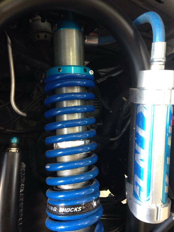

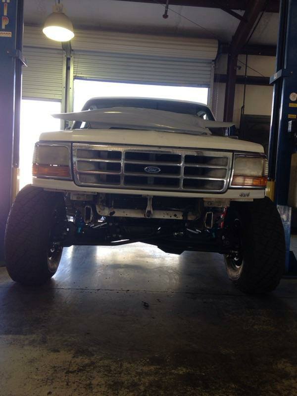

Here's some pics of Tate's set up he sent me. After reviewing I believe his spring rate may be a little soft for his set up. But lets here everybody's opinion. Here is what I propose go up to a 400 top spring and 550 lower spring. Set the desired ride height remember every time you adjust back up and pull forward 10'-15' easy on brake and throttle because you do not want that to influence ride height to settle the adjustment. Once you set that I would lower the cross over rings down to where they are about an 1/8" to 1/4" above the divider your preferance. I would also run nitrogen pressure around 150psi. Were shocks valved for bronco? Maybe try lifting the Bronco to desired ride height measure where the spring divider is from top of the shock then lift all the way up and move bottom of the cross over rings to that location. Then you will be riding on your base spring and your top spring comes into play from full droop back to ride height. But be prepared this may prematurely wear out the divider during hard abuse. This was the only way we could get our Trophylite shocks to work good. We replaced dividers every year and it was all good. On second thought your lower spring is either too short or too compressed for that idea.
Re: Dumb Coil Over questions
Well, you are in no danger of coil bind.
I run this same rate I believe mine may have a 16" coils top and bottom. I run my truck with a pretty low ride height, coil collar maybe .25-.5" front top of threads. Your dual rate collar is way above the slider in these pics I'd guess that's the softness you are feeling. As long as your not going to coil bind before the shock bottoms out I wouldn't worry about cranking down on it till you get the height your looking for.
Id set your ride height where your happy, set the dual rate collar 1.5" above the slider and see how that feels.

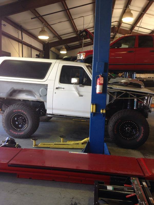

Your rear looks rather high too. What the rear set up? Pics?
XTate
Posts: 97
Joined: Mon Jan 11, 2016 7:11 pm
Bronco Info: 95 Bronco stock not for long
Location: south of the Gila
Post by XTate »
Rear is Q80's on stock front hangers and Soo Low shackles and drop down brackets, I away thought the rear a little high, but the spring are new no miles on them, I am sure they will settle in some. Will take some pic tomorrow of rear and the front drooped out.
Q80's and the Solo shackle drop brackets both cause trucks to sit high. Combine them & you get almost overly high. Do you plan on having a lot of gear with you/carrying a lot of weight in the truck? If not the rear may not set down too much.
