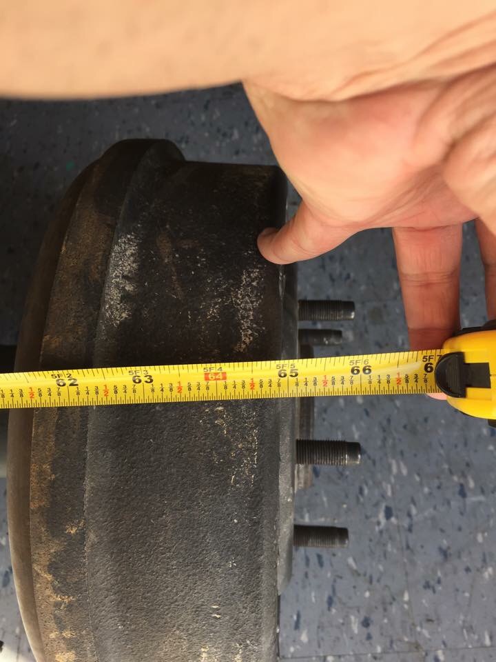

rdcjuanb
Posts: 262
Re: Another rear end option.
Post by rdcjuanb »
This is when I pulled mine
