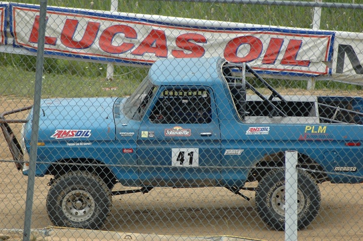

*Cage on the 72 Enduro*
Cutting the roof off, to cut the old shotty cage out and put a new one in, sound like the easiest route?

You have any suggestions for the cage we're about to build on that enduro ^^^
Re: Name to be determined... Race team. Formula 4x4 & Enduro
My business partner had built it before we met so no, I just raced it.
As far as the enduro cage, I would build a main hoop. Put a dash bar in it, keep the a pillar bars sinple with one bend between the two. Throw in a windshild top tube, and one tube down the middle of the roof between the hoop and the windshild tube. On the roof diagnal, I like to have it over the drivers head, running to the intersection of the windshieldbar and the middle roof tube. Nothing on the passenger side. Try to get some protectiong behind the drivers head as well, things get wild out there! Put some roll cage padding on the door bar, and wrap it with tape but don't secure it to the tube. This lets you "roll" into the cage! ha!
