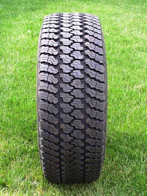

  • 35x12.50-15 tires <-- Goodyear Silent Armors, 35x12.50-15's purchased May 2009

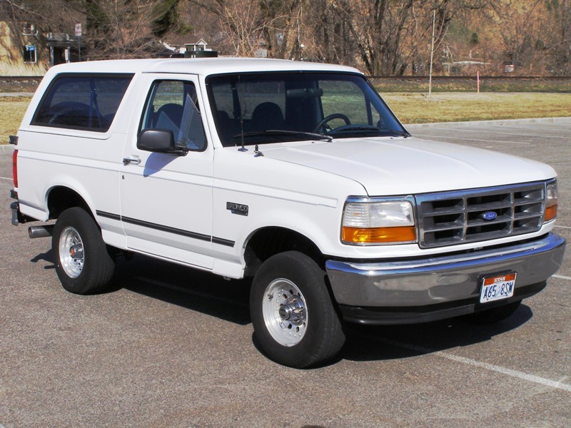

Right front quarter view...
BSF - Exterior - RFQ.JPG (151.21 KiB) Viewed 9529 times

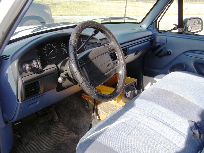

Interior...yuk Ford Blue.  Wish it was the tan color...oh well

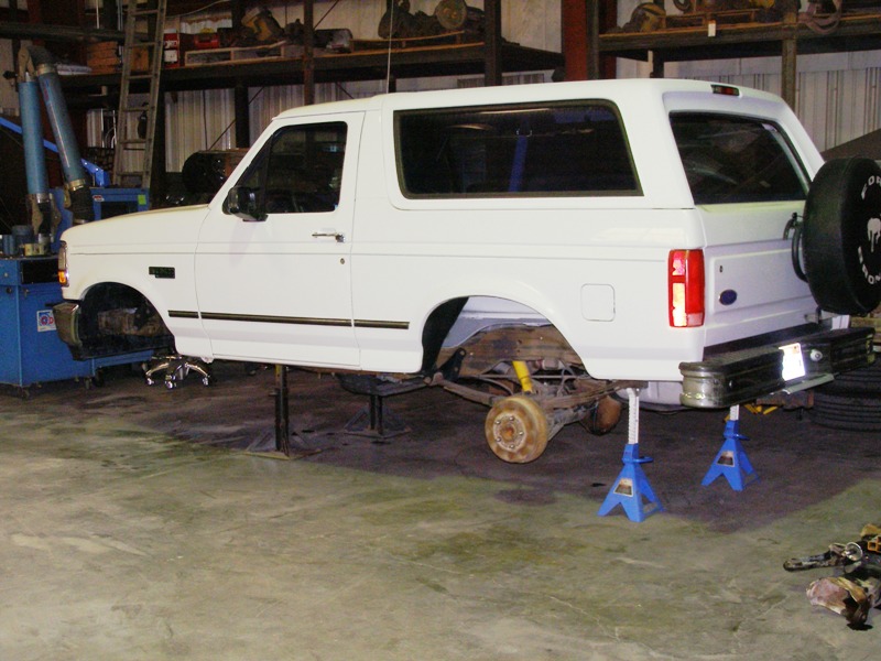

In the shop...
Post by denhabr »

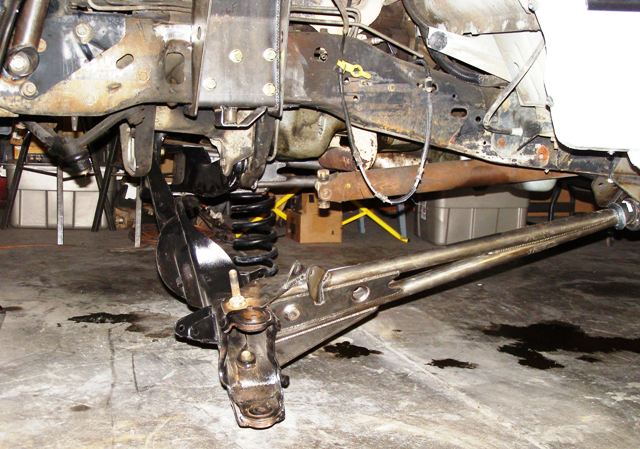

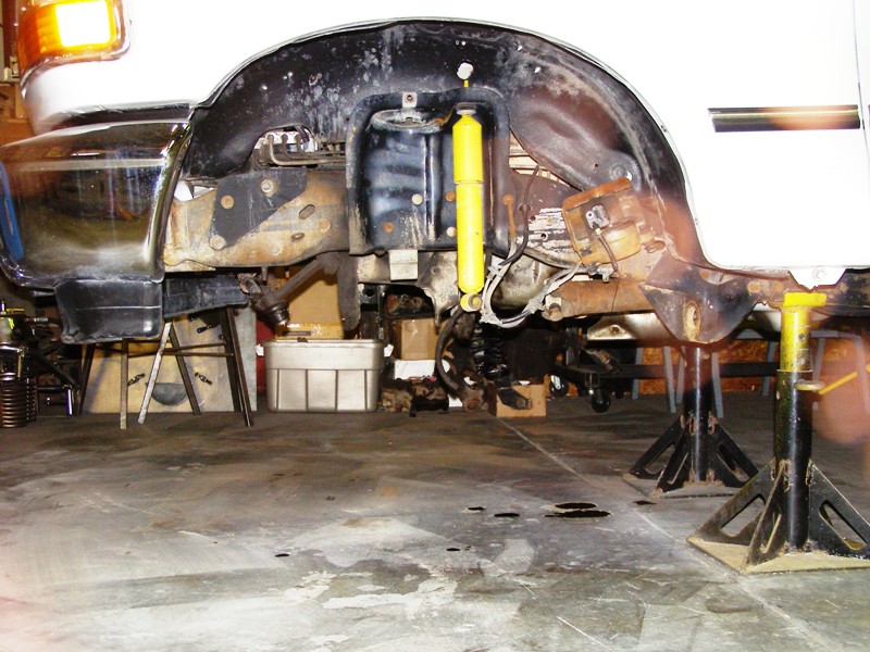

It's in the shop, and the tear down has begun...

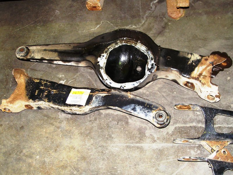

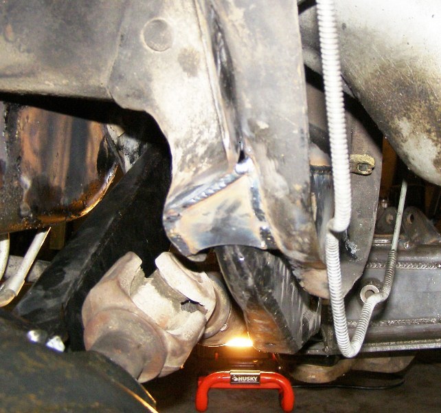

First task involved taking out are the front beams (gotta' get them back to Autofab to avoid the core charge!), the radius arms, axles, third member, etc.
Right front hub had water/rust in it...bad inner seal according to my fabricators. Leaning towards installing the F&R TrueTracs along with the 4.56:1 ring & pinions while everything is out. Just makes sense rather than paying twice to have it all torn out again and replaced.
Any suggestions on how to finish the beams, radius arms, shock tower, etc? Powder coating? Paint? Line-X? Other?
Got one of the original wheels/tires home for further inspection...only to find out that the wheels are Ford products! They have the Ford oval logo and "15x7.5 J DOT" stamped inside the back of the rim. I've never seen these on a Bronco or F-150 before (haven't been paying attention, I guess.)
I HAVE seen the smooth and polished "Alcoa looking" 10-hole wheels w/o the rivets, but my wheels are the 10-hole models WITH rivets (a la American Racing Outlaw II's, which is what I thought they were.) I guess I should have noticed the three small mounting holes that are located around the center hole (mounts the center cap via three stainless screws.) I think these wheels are keepers. Off to the polishing shop here in nearby Murray, UT for an estimate tomorrow.
The DOM tubing has been ordered for the cage and F&R bumpers. On Monday, I'll get the shocks and seats ordered, and the follow-up order with John at Autofab for the rear 18" suspension system.

The Bronco in the shop:
Bronco Fab Set 1 - 4-24-2009 (2).JPG (131.91 KiB) Viewed 9521 times
The old beams...soon off to Autofab for some other customer:
Bronco Fab Set 1 - 4-24-2009 (3).JPG (130.42 KiB) Viewed 9521 times
Driver's side teardown:
Bronco Fab Set 1 - 4-24-2009 (4).JPG (144.4 KiB) Viewed 9521 times

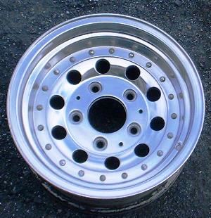

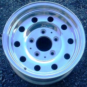

Ford OEM 15x7.5 "Alcoa" wheels (Hollander 3135):
Hollander 3135:
Hollander 3135:
Ford F-150 & Bronco Aluminum Wheel 10-hole 3135.jpg (29.23 KiB) Viewed 9520 times
Ford OEM 15x7.5 "10-hole" American Racing Outlaw II w/ rivits look-alikes...which is what I have now, and will keep until further notice:

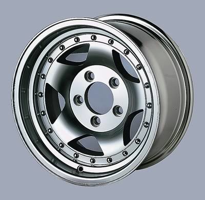

American Racing AR-23 wheels...someday:
American Racing AR-23s:
AR-23 Wheel.jpg (35.33 KiB) Viewed 9520 times

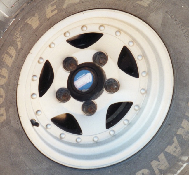

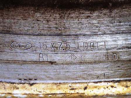

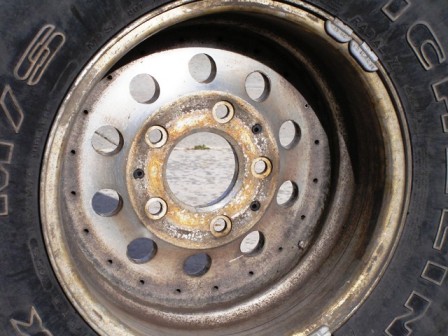

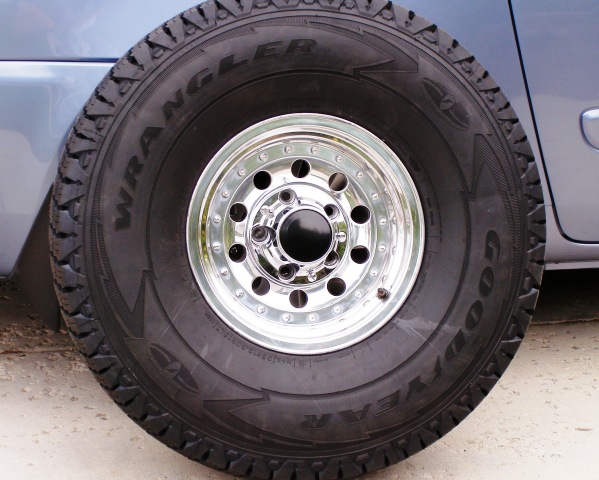

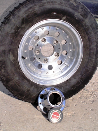

Here is a picture of the one wheel I have home from the shop. They map to Hollander #1701, are 15x7.5", and have 4" backspacing. It has 3 holes in the center hub to mount the chrome Ford center caps, and has small plastic core inserts (where the 3 mounting bolts go,) which can be removed from the backside during polishing/cleaning. The same wheels (fully polished) off the internet go for $195 ea, so I'll put some extra effort into getting these cleaned up.
Ford Wheel Before Reconditioning - 4-27-09 (1).JPG (101.9 KiB) Viewed 9517 times
Ford Wheel Before Reconditioning - 4-27-09 (6).JPG (36.85 KiB) Viewed 9517 times
The 20 "rivets" are simply cosmetic and can be removed by punching them out from the backside for cleaning/polishing.
Ford Wheel Before Reconditioning - 4-27-09 (4).JPG (53.42 KiB) Viewed 9517 times
Since a local polishing shop wanted $75.00/wheel, I'm going to give it some TLC, a lot of elbow grease, and try to clean the wheels up myself. I will start with the removal of the 20 rivets (and the three mounting sleeves for the center cap,) followed by removal of the clear coat (aircraft stripper), and then hand polishing with steel wool and Brasso. Then I'll try a power ball, and some good aluminum polish and go to town. I'll finish the backside off with some scrubbing and maybe a light coat of light grey spray paint (so I never have to deal with the backside again...)
If the resulting finish is not up to my standards...I'll just get them powder coated a nice high-gloss silver (or as close to the polished aluminum look as possible) and call it a day (read: no more polishing!)

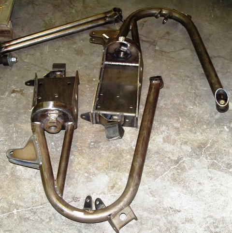

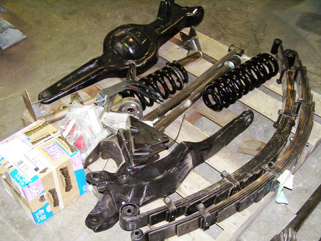

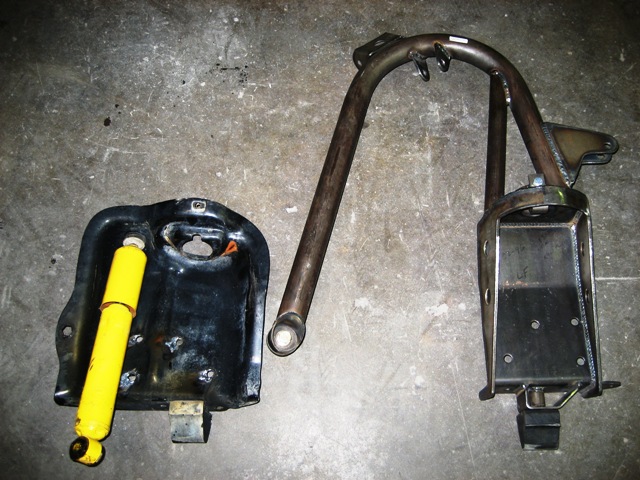

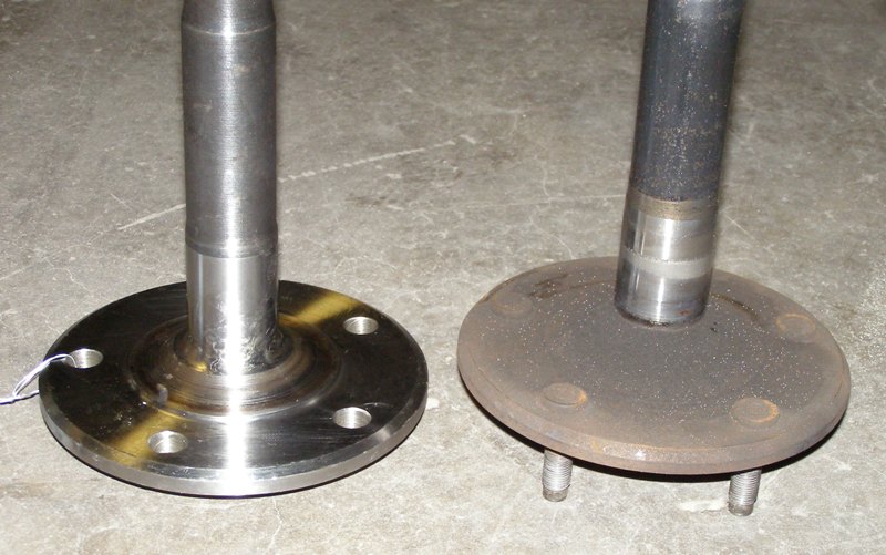

The Autofab front & rear suspension systems arrived at the shop by truck freight on Tuesday. Freight from Santee to Centerville, UT was ~ $405.00 for about 400 lbs. of steel. Ouch.
Bronco Fab Set 2 Autofab Susp & SAW Shocks - 5-6-09 (5).JPG (83.8 KiB) Viewed 9515 times
Bronco Fab Set 2 Autofab Susp & SAW Shocks - 5-6-09 (7).JPG (66.03 KiB) Viewed 9515 times
The six Sway-A-Way's arrived in from Kustom 1 Warehouse also on Tuesday, pictures are below...nicely laid out on the front driveway.

I made a command decision with the wheels. I decided to keep the OEM Ford 10-hole 'riveted' 15x7.5 wheels, and got them polished. I went back to the place that did my engine/chassis steam cleaning last November, and since their specialty is semi-truck detailing (they routinely polish those large 22.5" over-the-road Alcoa wheels on a daily basis,) they did all four of my wheels for ~ $103.00! They turned out pretty nice...not show quality, but this is a off-road Bronco!
I then got them over to the Goodyear shop and had them mount and balance my four new Goodyear Silent Armor 35x12.5-15's. They look sharp!!! Nice A/T tread with broad and square-shouldered carcass. Of course, I had some nice photos of the mounted tires/wheels on the front lawn...and they ended up on that same PC at home... Ugh.

Shock tower comparo:
Bronco Fab Set 3 - F Suspension (dpf) (1) - 5-28-09.jpg (123.29 KiB) Viewed 9514 times

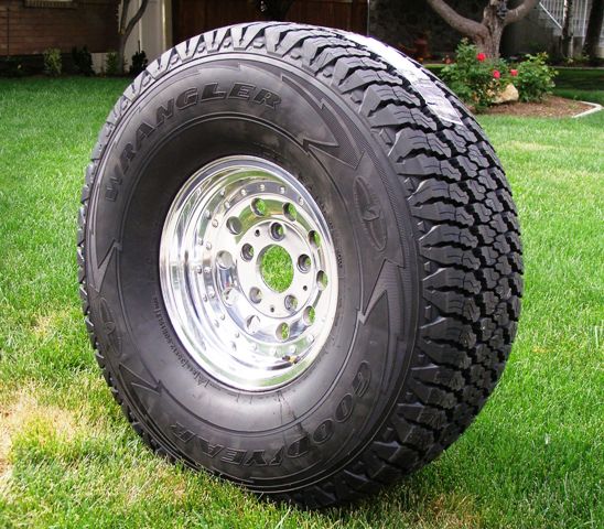

Here they are: Goodyear Silent Armors in 35x12.50-15 sizing mounted on the polished Ford OEM 10-hole 15x7.5 wheels...
Question: Should I mount the wheels with the center caps, or leave them off for the full "race-look?" I'll respond to everyone's comments/remarks later today. Appreciate the questions, suggestions, and feedback...
New tires & wheels:
Goodyear Silent Armor 35x12.5-15 & Polished Wheels (1).JPG (83.35 KiB) Viewed 9513 times
Tread design on the Goodyears:
Goodyear Silent Armor 35x12.5-15 & Polished Wheels (3).JPG (73.38 KiB) Viewed 9513 times
With center-caps installed:
Goodyear Silent Armor 35x12.5-15 & Polished Wheels (5).JPG (98.72 KiB) Viewed 9513 times

I've been looking into AT tires to replace the BFG muds and the silent armors was one I was considering. Post up pics of those when you can I would love to see what they look mounted and how they perfrom.
See pictures above!

Wheels came out great polished! Loose the center caps.
1 vote against center caps!

That's a good looking tire, Brad. The local Park Rangers (Oceano Dunes) use those with pretty good success.
Thanks. I just like the square shoulder look myself. I was really hoping M/T would bring back the old-school Baja Kings in 35" radial, but no such luck.

Keep the caps. That black looks interesting.
1 vote FOR the center caps! Tied at 1 each!

I stopped off at the shop yesterday (June 12, 2009), and inspected the cross bar myself. GOOD EYES! It is a seam. However, my fabricator agreed with SteveG...in that the cross bar is there to simply stabilize the shock hoops from splaying inward (or outward,) and holds light loads as compared to other components. Won't be an issue.
Here are the shots of the Bronco from my visit yesterday afternoon...
The Obligatory Side-Mockup Shot...with the tires rolled into place in front of the hubs (or where the hubs should be...and yes, the rear suspension is still the OEM stuff...the guys will move to the rear later this week when the F shocks, axles, etc are all in place.) Suspect that the actual final body height isn't quite right, however, this gave me an idea of what it will kinda' look like when complete. Good looking profile, IMHO...
Bronco Fab Set 4 - Jun 12 09 (1).JPG (94.26 KiB) Viewed 9527 times
Still not sure, about fiberglass...yet. I've asked my fabricators to put 'er all together, bolt on the wheels, and set it down on the suspension to see where it looks like the tires will hit. Frankly, I like the look of the OEM steel...just wish I could radius the F&R wheel wells ever so slightly to provide the clearance I need. My fabricators say I may be OK with the rear, but the front wheel wells are going to be another story.

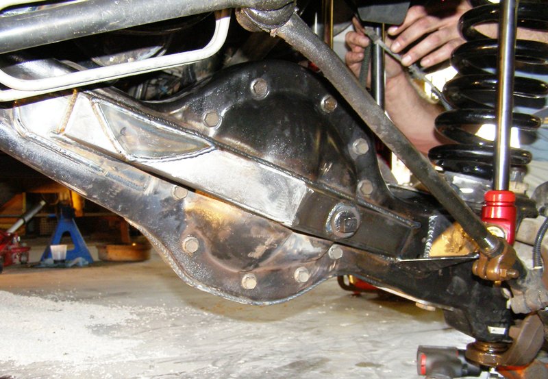

Drooped Driver's Side Beam and Radius Arm:
Bronco Fab Set 4 - Jun 12 09 (5).JPG (73.43 KiB) Viewed 9527 times
TTB/Radius Arm attachment Close-Up:
Bronco Fab Set 4 - Jun 12 09 (8).JPG (97.81 KiB) Viewed 9527 times
There is A LOT of stuff I'll need to get the guys to relocate in the engine bay. The entire air filter box is toast, so is the battery; both need to be relocated...somewhere. It's amazing how all the room disappears when the shock hoops are in place, and the crossbar is positioned. Ugh.

I think I will keep the caps for now. They're all polished up and lookin' pretty, ready for the truck when it gets home. That's right...the sleeper look!
(See upcoming post on my new HD 1/2" lugnuts, Hollander #611-171.)
I like those smooth Alcoas too. They do look nice.
So if I were to convert to 5/8ths lugs, do I have to convert to non-cone style lugs nuts?

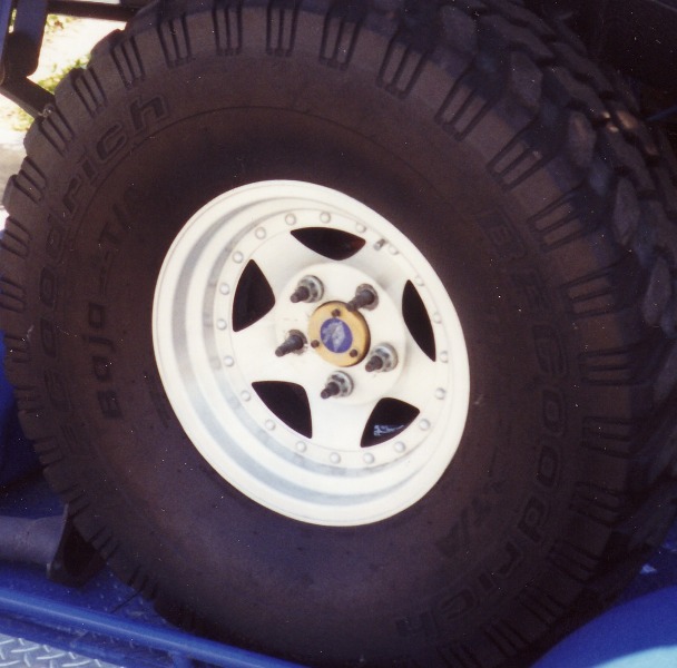

Actually I like the flat-faced lug nuts I often see on race trucks...often gold anodized. If I went that way, would I have to spot face around the lug holes to flatten the surface? Do you use washers with yours? See the two photos below. I took the pic of the AR-23 wheel on the FabTech Ranger back in the mid-90's...it has the racing style lug nuts with the wide mating surface (and yes, two nuts are missing.) The other AR-23 close up is from a Bronco Prerunner I shot at a VORRA Race in Fallon NV in 2001. He too uses the larger flat faced nut. This is the style of lug and nut I want eventually for my Bronco...gold anodized nuts of course!
Picture 1: FabTech Ranger BFG Baja T/A on an AR-23 with extended racing lugs and nuts.
AR-23 Wheel with Racing Lug Nuts - small.jpg (76.25 KiB) Viewed 9511 times
Picture 2: Bronco Prerunner with yellow-label Goodyear racing tires on AR-23, also with extended racing lugs and nuts...seen in Yerington, NV in the summer of 2001 (back when I crewed for the Class 8 "Battle-Born Racing" F-150)
Bronco Prerunner Lug Nuts - Fallon NV 2001 (close-up) - small.jpg (92.78 KiB) Viewed 9511 times

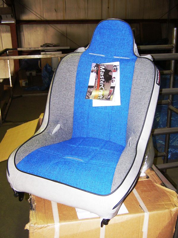

Mastercraft Seats!
Post by denhabr »

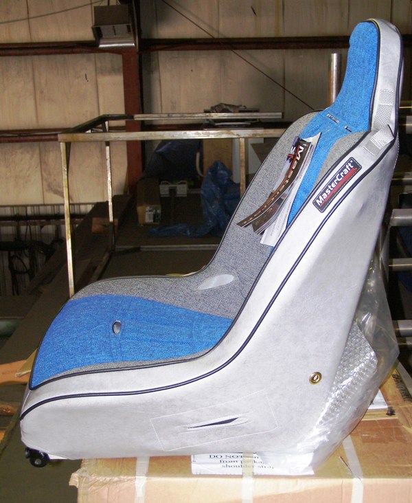

The custom-ordered Mastercraft "Originals" arrive. http://www.mastercraftseats.com/original.php . I purchased these from John at Autofab...and he gave me a good price (Mastercraft is right across the freeway from John's shop...), and he is an authorized dealer.
Two were ordered in +2" width (for the front, to fit my fat 6' 1", 210 lb. frame), and two were ordered +1" width (for the rear passengers...to fit my oldest son's 6' 4", 210 lb. USA Rugby All-American body...to be located between the rear wheel-wells.)
Selected the blue and grey color scheme to match the OEM Ford Blue (bleh...still hate that color.)
Pics: Christmas in June!
Bronco Fab Set 5 - Jun 19 2009 (1).JPG (103.6 KiB) Viewed 9510 times
Front view:
Bronco Fab Set 5 - Jun 19 2009 (2).JPG (103.85 KiB) Viewed 9510 times
Side...
Bronco Fab Set 5 - Jun 19 2009 (3).JPG (101.89 KiB) Viewed 9510 times

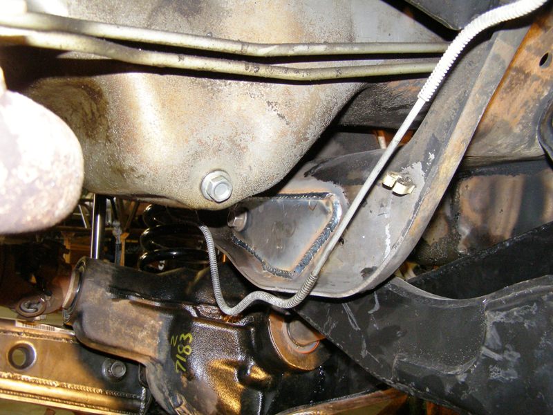

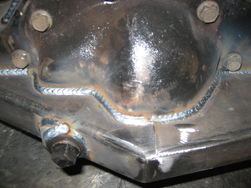

TTB Gusset Detail...
TTB Gusset - Front of Driver Side (18 Aug 09) 1.jpg (157.13 KiB) Viewed 9508 times
TTB Gusset - Front of Driver Side (18 Aug 09) 2.jpg (132.08 KiB) Viewed 9508 times
TTB Gusset - Front of Driver Side (18 Aug 09) 3.jpg (128.22 KiB) Viewed 9508 times

The TTB is in, bolted up, shocks positioned and springs in place...and getting checked for final clearances. Numerous calls back to John to find out the optimal location to mount the limit straps.
Note to potential Autofab dual 2.5" shock TTB system buyers: When you purchase the 10" travel TTB S-A-W shocks (the ones that go behind the spring; see previous posts for part numbers,) order them with a 90-degree remote reservoir adapters. The proximity of the engine compartment wiring (and related crap) on driver's side necessitates a 90-degree fitting coming off the top cap of the shock. And worse, the lower portion of the A/C box (see photo 3) on the passenger side REALLY requires a 90-degree fitting...Big Time! Anyone else run into this issue?
I wish I would have known about that 90-degree fitting when I ordered the shocks.
Also, my fab guys clearanced the front truss slightly where the box-section made about an 1/8" contact with the TTB support. See the close-up photo to see where they scalloped out a section and welded it up. Also note some of the other support plating, doubling, and tabbing they did before reassembly.
The guys are having a lot of fun getting the right seals back on the front hubs and rotors. A real PITA, from what they tell me. Buying the 'right' kit is more of an art than a science...especially when Checkers Auto Parts lists 99 different part numbers for the seals. Glad it's them and not me. I'd be swearing up a storm.

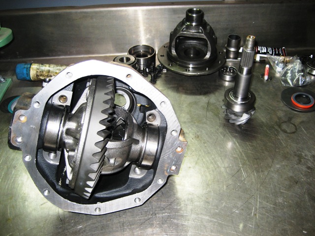

They also got the 8.8" axle and rear leafs out yesterday. Took the center section apart pulled out the two axles. They told me the passenger side axle is 'toast' (I haven't seen it face to face, so I'm not sure what 'toast' means.) Any suggestions for a source for some new 31-spline HD axles to replace the stockers?
What about an 8.8 diff cover? Mag-Hytec? FMS? Other?

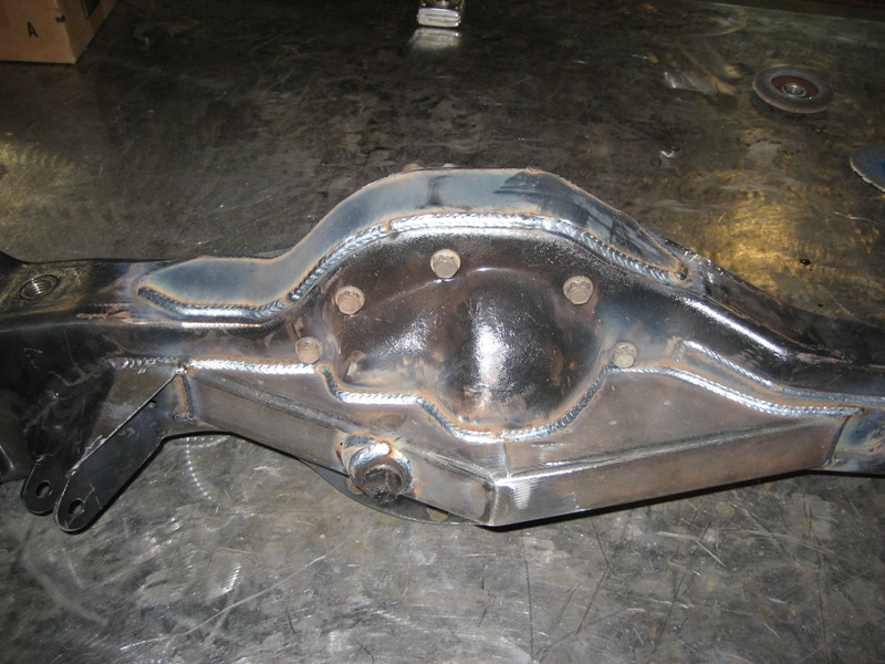

Some shots of the reinforcement work to the TTB mounts...
Bronco Fab Set 6 - 8-28-2009 (9).JPG (107.79 KiB) Viewed 9504 times
Bronco Fab Set 6 - 8-28-2009 (10).JPG (105.37 KiB) Viewed 9504 times

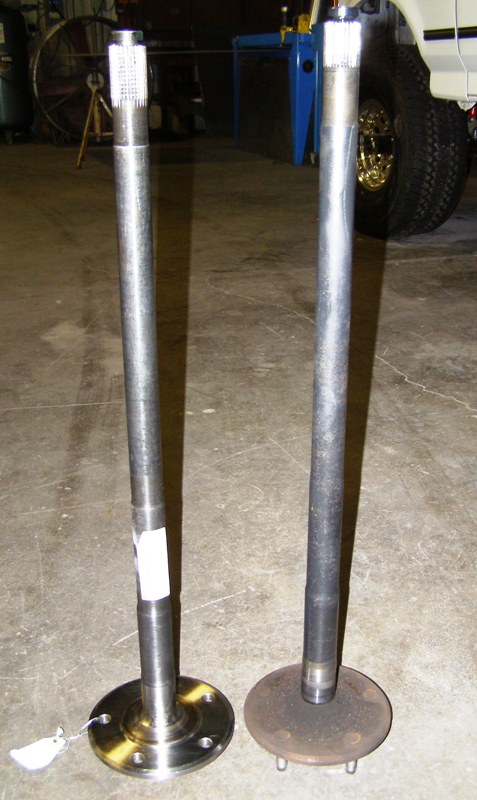

Shock Mounts & 8.8 Axles...
Post by denhabr »
Quote:
Originally Posted by steveG...
That's funny, I was thinking that it was weird that Ford put the A/C Box so close to the Autofab mount. Ha! There's not a lot of room there to begin with. It's just the way it works out. Like I said before, porting the reservoir off the bottom of the shock would be ideal.
HA! Just what the hell was Ford thinking, eh? I spoke to Darren at Autofab yesterday (John's fabricator) and they are intimately aware of the proximity of the rear 10" upper shock mount. He fabricates a special tight 90 degree res hose fitting that resolves the issue, but I'll rely upon my fabricators to figure out something...first step is to contact S-A-W and see what is available off the parts shelf.
Quote:
Originally Posted by Brokenbronco...
I wouldn't be surprised if those are name brand axles, JBG buys in bulk, so they get good prices from top notch suppliers.
You're right. JBG replied the other day and said that their axles are Yukons. So, I checked back with my ring gear/TrueTrac supplier (Wayne @ http://www.alljeep.com) and got a complete set of Yukon 1541h alloy axles (R: YA F880007 & L: YA F880008, wheel bearings, seals, and new 1/2"-20 studs for $190 to the door.)
Next steps are the trussing of the axle housing (yeah, you know us young 49-year-olds love our trusses!), reassembly, and reinstall.
I also purchased some new Ford OEM leaf spring eye bolts, and will use Royal Purple 75W-140 in the front (the owner's manual says "4x4 Gear Oil" F1TZ-19580-A in the D44. The Ford parts man says that has been superseded by XY-75W140-QL...which is nothing more than 75W-140 lube) and some F1TZ-19580-B "Motorcraft High Performance Rear Axle Lube" in 80W-90 for the 8.8, non-synthetic. Apparently Eaton does not recommend synthetics with the TrueTrac diff.
And now for some sexy axle pictures...
Bronco Fab Set 7 - 9-4-2009 (2).JPG (90.59 KiB) Viewed 9504 times
Bronco Fab Set 7 - 9-4-2009 (3).JPG (89.15 KiB) Viewed 9504 times

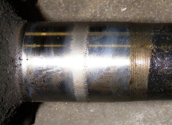

Close-up on the damaged passenger's side OEM axle...
Bronco Fab Set 7 - 9-4-2009 (5).JPG (73.85 KiB) Viewed 9504 times
