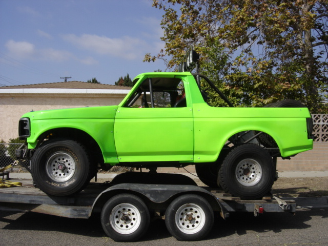

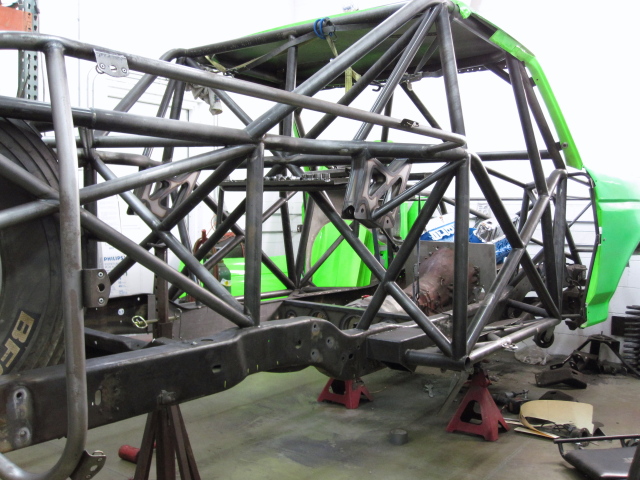

I asked for a place where I could share the build of my race Bronco, here it is.

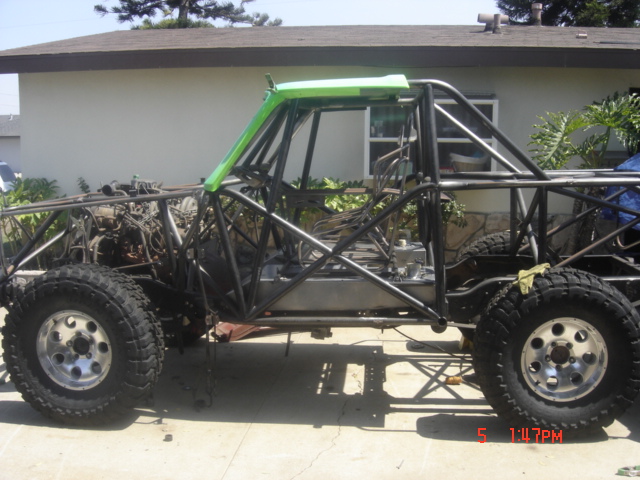

I purchased the project after the basic chassis had been built and the body had been hung so we start from there.

Post by gunit »
more:

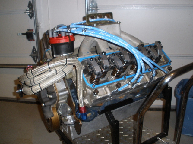

Engine is a dry sump 430 ci Ford with Yates heads by Dougan's Racing Engines. The engine dynos at 659 hp 560 tq and makes over 500fp of torque from 2500 to 5500 rpm.

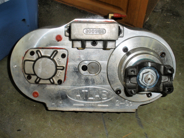

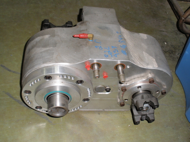

I am using an Atlas transfer case

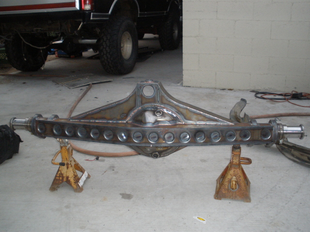

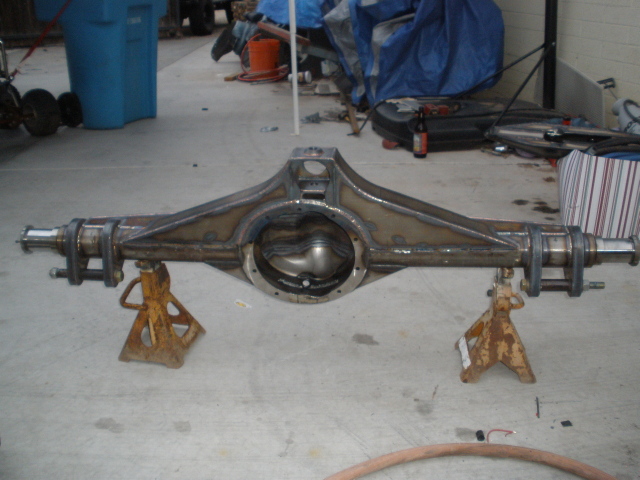

Rear axle
attachment=0]P7230004.jpg[/attachment]
class 3 007 (2).jpg (137.88 KiB) Viewed 35257 times

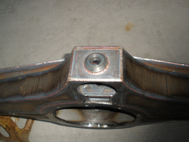

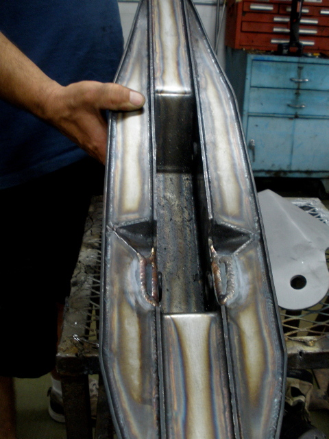

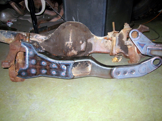

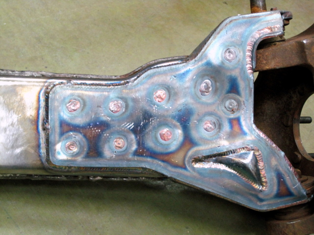

Front beams

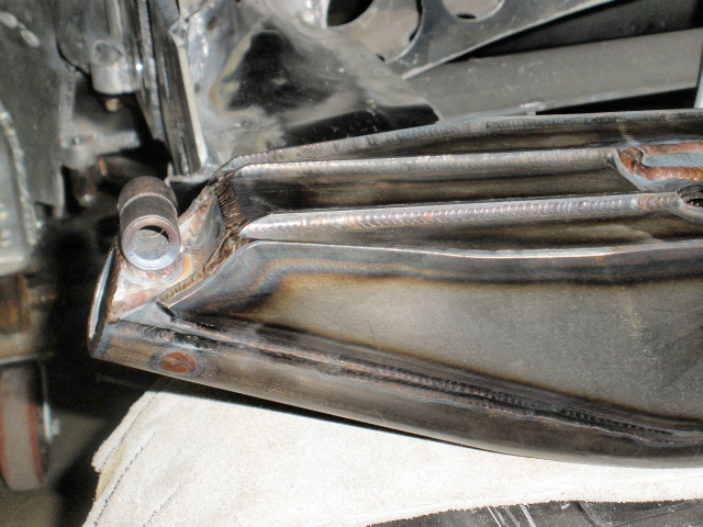

Post by gunit »
Trailing arms

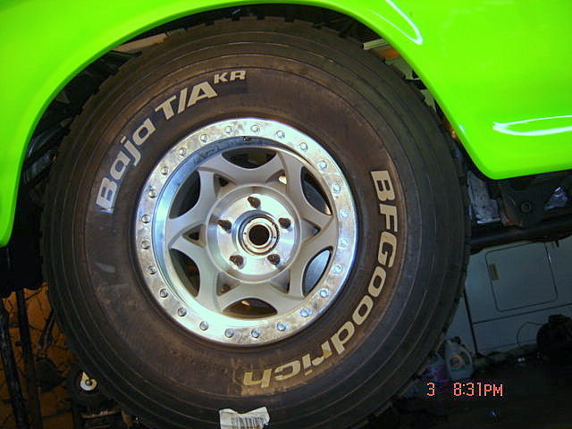

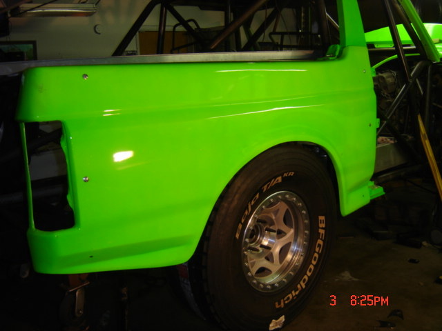

37" BFG Baja TA on Walker Evans Beadlock wheels

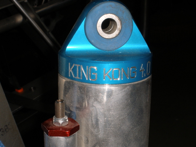

Post by gunit »

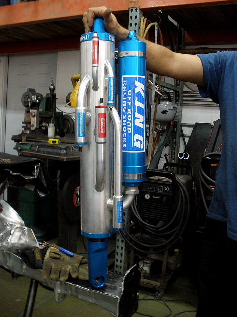

King 4.0 bypass shocks all the way around

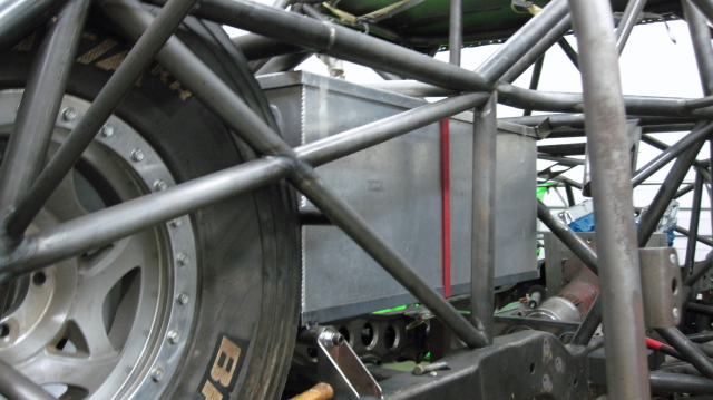

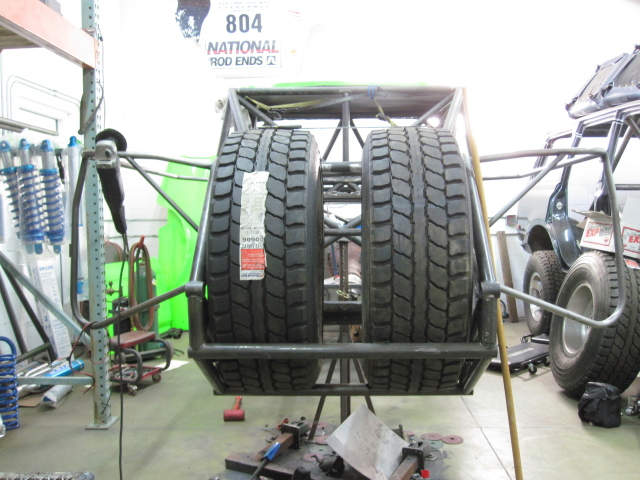

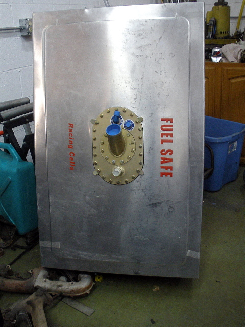

70 gallon fuel cell

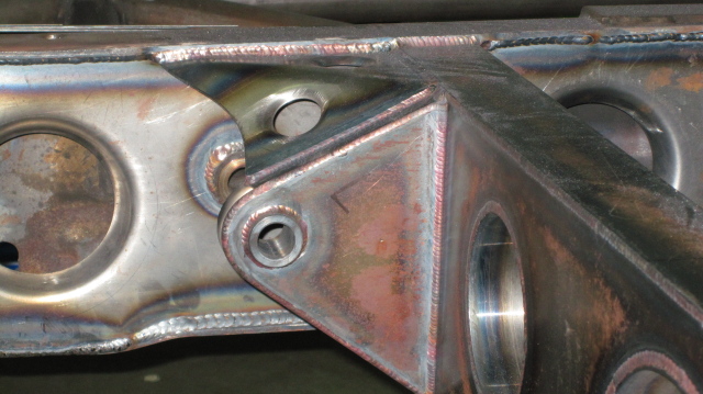

Post by gunit »

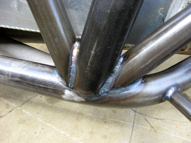

Custom crossmember
Trailing Arm mounts
Mount for upper link

Re: Gunit's class 3 racer build
Wow... that thing is a beast!
Whats up with the interesting geometery on the beam pivots? Did your fabricator use silicon-bronze rod when welding your beams?
