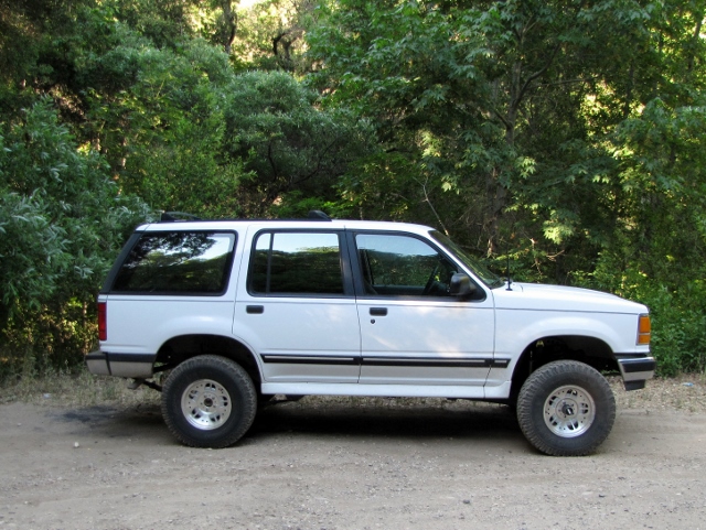

I took a couple photos for a friend and figured I'd post them here, too for the pic-whores. Ha!
IMG_3421 (640x479).jpg (167.45 KiB) Viewed 2046 times
Sway bar not yet connected.
IMG_3425 (640x480).jpg (262.73 KiB) Viewed 2046 times
Re: The 8 Year Project
What happened to your factory tow package and spare?
The spare (31") will go back in once the shocks are dialed. The receiver won't fit with the longer springs. The shackles run into it. I haven't decided what to do about that. Maybe just leave it off and Jeff can just bumper tow... like he has been.
You can't see it in the photo, but I cut the webbing between the two halves of the shackles to allow them to swing back further without running into the bottom of the frame rail. I also heated the cross member and pounded the hell out of it to make room for the shackles to swing back.
