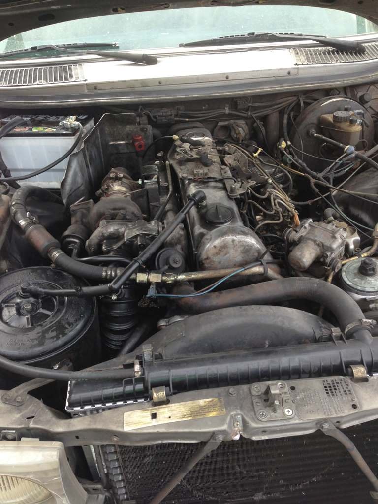

Donor car! The engine needs a valve adjustment, new injector nozzles, and fresh glow plugs. Too bad its not grid heater based...

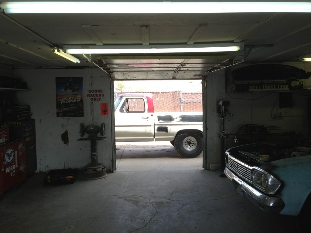

I love the second pic from inside the shop with the F1 outside.
Re: Yup another Philofab Project... 1971 Ford F100

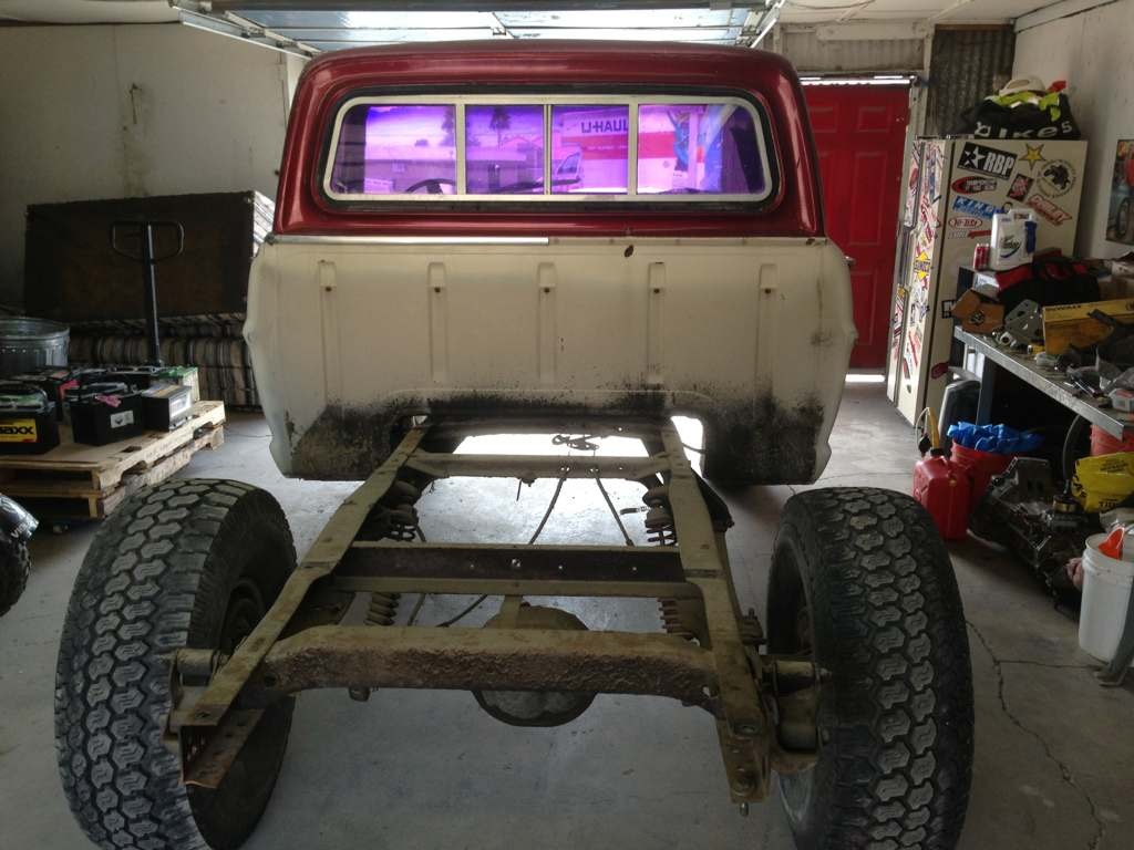

The door is 1" wider then the truck... And my car trailer, the Bronco, and 40,000 lbs of steel is blocking the only other access to behind the rear building.

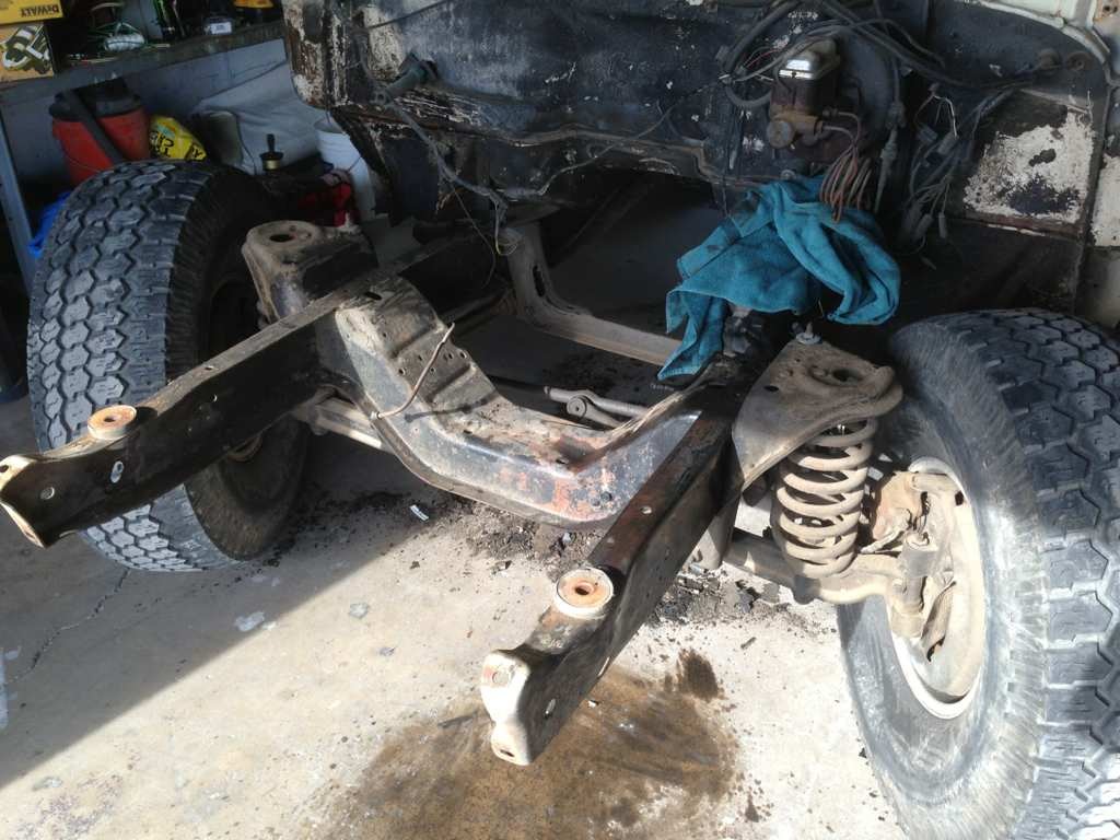

Getting the frame cleaned up for paint and mock up. Also adjusted the valves in the benz, replaced the injector heat shields, and replaced the valve cover gaskets. Starts better but not like my cummins does. Going to do new injector nozzles, fresh filters, and troubleshoot the glow plug system. I also ordered a machined adapter for the transmission flange. I still need to get a oil filter relocation kit for the engine too.

Looks like 4 of the 5 glow plugs are bad. Ordered new Bosch plugs today...

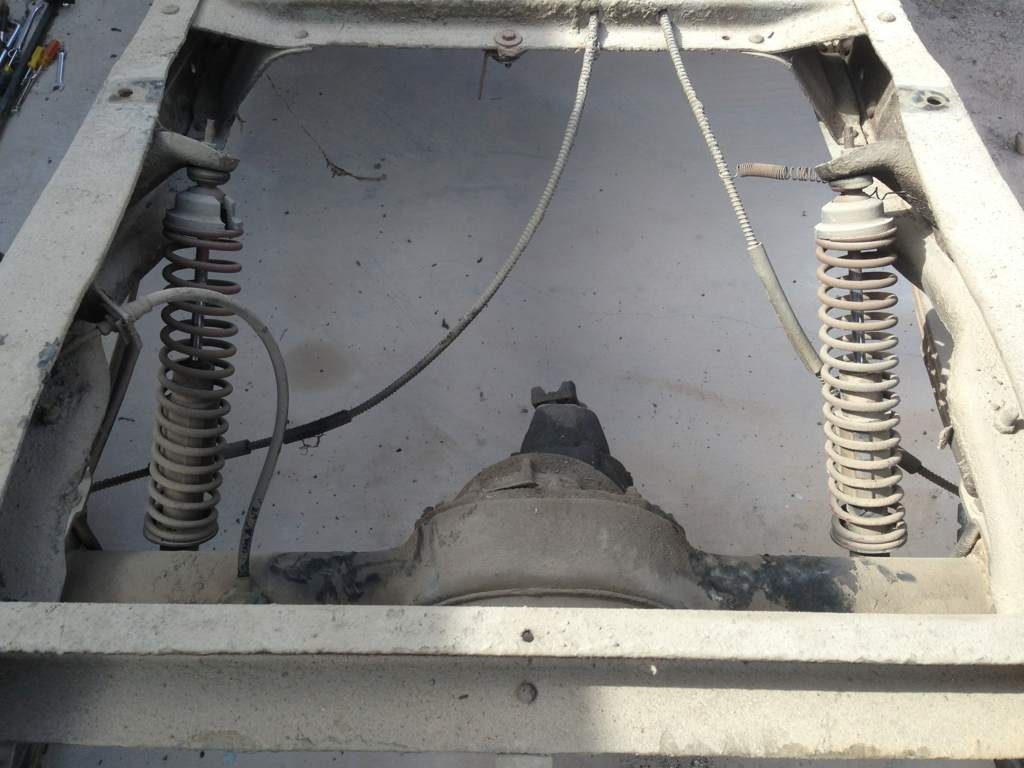

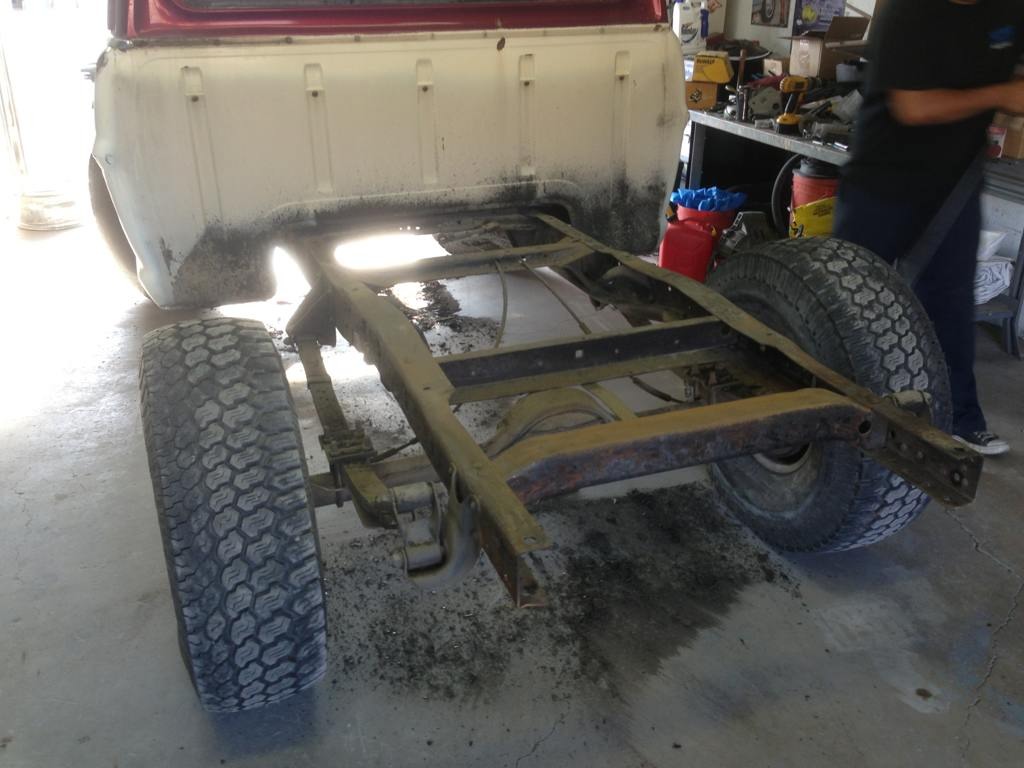

Getting the rear frame section sorted out. I am moving the front leaf spring cross member forward, the rear hanger cross member rearward, and the small support cross member forward and flipping it over. Hangers are all getting trashed for 90s Ford Ranger hangers and a set of Chevy 64" springs. Building a fuel tank for behind the axle, most likely out of Aluminum. Should be about 41 gallons all said and done. I also need to slice the factory shock mounts off the axle and put longer ones on and try to fit a 8" or 10" shock under the bed.

With my tank I was able to get 45 or so gal. My frame is narrower though so you can get about the same while keeping the tank shorter (meaning not hanging down as far).
As for the shocks - I ended up with 8" after trying 10". I've got Deaver springs for a Chevy 2500 --> 4" lift = f87's I think.
Anyway the 10" shock was perfect for droop with the 64's, but the body was too long for bump & the shock would bottom before the axle hit the bumpstop. I went with 8" stroke and have to limit the droop a bit. My shock mount sits on top of the frame and is just barely under the skin of the bed - so it's about as high as you can go without cutting into the bed.
