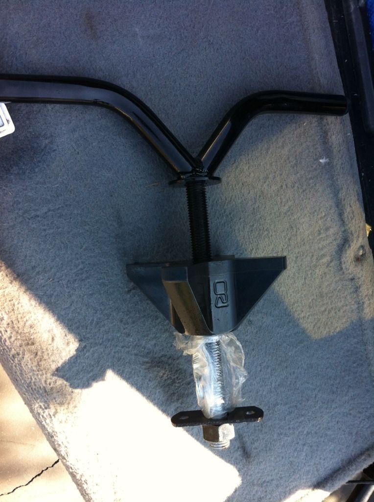

Feeding the monster.... RObert hooked me up big time and picked this up for me from a local eBay seller:
Part of the tire mount.

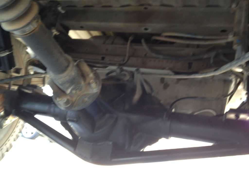

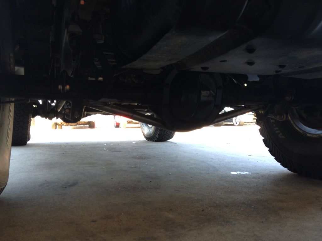

And thanks to Brian scaring me.... did this as well:
Re: Tonys 93 bronco
Smart move. Peace of mind.

Re: Tonys 93 bronco
I see you got your rear end some support to help it sagging in the middle...
And you're more than welcome....was right around the corner from my house...pretty much

This bronco is so clean! I like the simple truss, effective but not bulky with added unsprung mass. I've seen a few failed 8.8s and most failures were from broken plug welds and I have seen one bent pretty bad near the diff housing so I'm sure that by towing the two tubes together and then to the diff it should avoid that type of breakage. Plus looks like it strengthens the shock mounts too which is cool.
- Posts: 7308
Re: Tonys 93 bronco
Thanks Kyle, the purpose was really to keep it together for last weeks trip to Baja. Working on building a 9" for it now.kylesgorter wrote:This bronco is so clean! I like the simple truss, effective but not bulky with added unsprung mass. I've seen a few failed 8.8s and most failures were from broken plug welds and I have seen one bent pretty bad near the diff housing so I'm sure that by towing the two tubes together and then to the diff it should avoid that type of breakage. Plus looks like it strengthens the shock mounts too which is cool.
