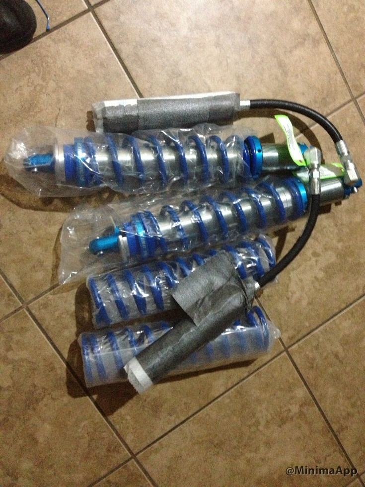

So I finally ordered the long awaited set of new king 14's for the front with new springs. Finally gonna dump these 3rd hand foa's. only a few weeks to wait( kings backlog). So check this out... The shock tech from the company I got them from was recommending a 250 over 350 with possibly a flutter stack for my application. Not to sure about that spring rate but I've ordered 350 over 400 with valving to accommodate the 37's and compression according to my driving style. Ill give em a hot lap n send them back if too soft. I have a large variety of spring rates to chose from for testing but figured I'd listen to a shock tech for a change instead of going with what my gut tells me hehe. I'm in no hurry so why not. We shall see...

I have 350/450 and everyone told me they were gonna be to soft. They work great!

cs_drums wrote:I have 350/450 and everyone told me they were gonna be to soft. They work great!
Ok good that makes me feel a bit better... The king tech also said he was gonna talk to another shock tech about possible flutter stacks for smother onroad performance but he wasn't 100 percent. We will see what the 2 of them decide on. I know they know a hell of a lot more about it than I do so I'm hopeful.

According to the build tag f20/10, does this mean flutter .020 compression? Any of you guys speak king?
