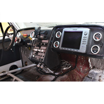

By the tine you guys are ready, it will look something like this!
Re: APEMFB's Air Force One aka The Silver Bullet
YES!! i love that poster..........
as for caging and long hauls...well i know a thing or two about this with mine, i spend way to much time in my bronco and yes the cage kinda sucks for noise but if you do the cab part of the cage tight and keep the window bars simple(if any) you can do a headliner to hide it and use some closed cell foam on the sheetmetal likr the rubatex that the insulators use on exterior chilled and hot water piping systems(no not the crap you can buy at home depot) you can cut down 90% of the noise. avoid bypass shocks on hiems and finish the interior. as much as i bitch about the clicking and clacking of my cage i am glad i have it and would not change it in my bronco.

LOL, love that poster Nick.
Okay this is what I am thinking if I go the cage route. I would have Mark build it out of 2" DOM and make it Score legal. Yes more cash, more time but if I'm going to cage it might as well make it Score legal. Plus I already have a Fiberwerx Navi dash in the garage.
