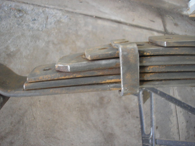

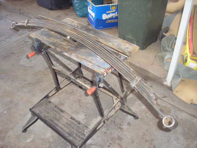

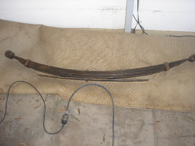

Spent the morning wire buffing the rear springs, ready for paint:
The springs are supposed to be 4 + overload, but have had 2 extra HD leaves inserted. Man this thing rides harsh:
Trimmed the Energy Suspension bushes, fitted shackles after painting, and installed the springs:

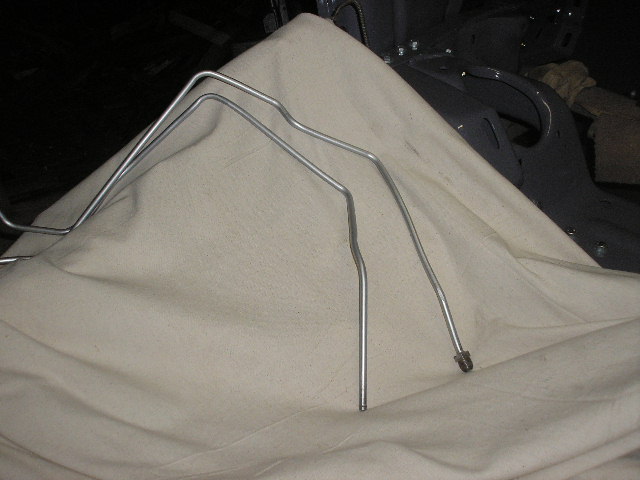

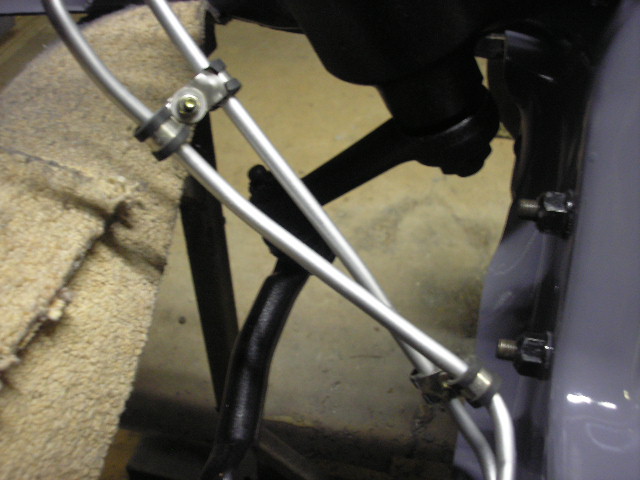

PS pipes are cleaned and painted:

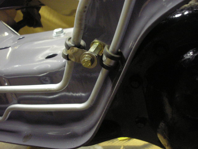

Wednesday update:
:shock: :shock: MONSTER HUNGRY! OH NO! MUST.......... FEED.............. MONSTER.............................
Ok, I get the hint ;)

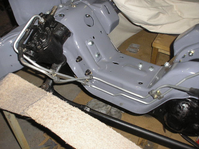

Anyway, some progress, even though it's cold as f**k. PS lines painted, flushed and fitted:
