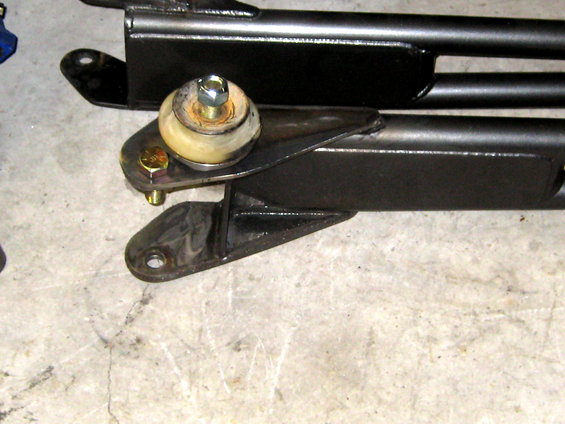

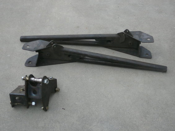

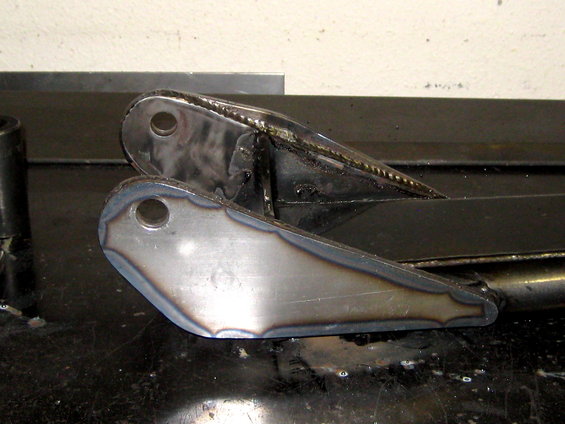

Come on T. That's a no brainer. These are 1/4" crap. I'm starting to wonder if they're some Camburg knock-offs or something. Yours are 1/2", I believe.

yikes wrote:Come on T. That's a no brainer. These are 1/4" crap. I'm starting to wonder if they're some Camburg knock-offs or something. Yours are 1/2", I believe.
Thats what I wanted to check...... Plus, I am no Beeler (drive it like you stole it) but still, preventive maintenance is the best one right!!
You know, it is possible to use design to eliminate the need for such heavy material. At this point (post-damage), adding material is definitely the easiest solution.

SteveG wrote:You know, it is possible to use design to eliminate the need for such heavy material. At this point (post-damage), adding material is definitely the easiest solution.
Yeah, I realize that Steve. Given how I intend to relocate my coil spring, the added material is a necessity. The bending is a result of the beam trying to push into the radius arm on big hits, which is why Autofab integrated the back support. I may integrate something like that as well.
Get that crappy picture out of my thread Nick! This is Yikesfab! Haha! Actually, I would be curious to see how those hold up in a 30-0 impact.

SteveG wrote:Actually, I would be curious to see how those hold up in a 30-0 impact.
I don't know if you remember a couple years ago when I was gathering parts for a friend and bought an entire used front end... The truck the parts came off was ran into a rock at speed and rolled (supposedly around 60mph). The impact side radius arm bowed a bit and the frame was trashed where the pivot bracket attached. The beam attachment end was fine. Instead of buying a new arm I ended up straightening it and plating over the tubes on both arms.
I agree that heavier material is good since you're relocating the coil. Adding the third mounting point also adds strength to the housing and keeps the beam/arm assembly from rotating on the radius arm bolts.

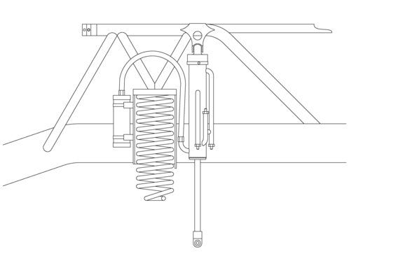

I started this today to get a visual of how I'm going to mount the buckets, shocks and fab the shock towers. Obviously the shock towers are not modeled yet. Still have to snag some key dimensions for the shocks and buckets, but this is close to how they'll sit; although the shock is about an inch or so too low. The basic proportions are right. Do any of you have CAD drawings/dimensions for SAW's?

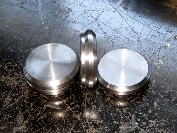

Whipped out some end caps for the bumpers this morning.

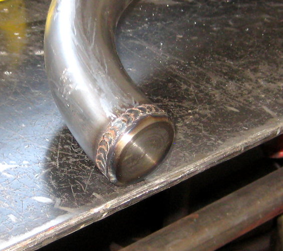

Thanks T. One step at a time and it should be done for the 500. Finished the radius arms and glued the caps on the main tube. Went for the "pretty weld", but.....not. Haha! Now the welds for the studs on the radius arms? They were done the right way. No trigger.

First: I extended my beams from the pivot end 1 1/4" per side and the geometry is no longer correct, which is why they need to be moved inboard. Second: I'm going to be using a 3x12 shock in front of the beam, so maximizing available wheel travel makes it necessary to move the coil back.
