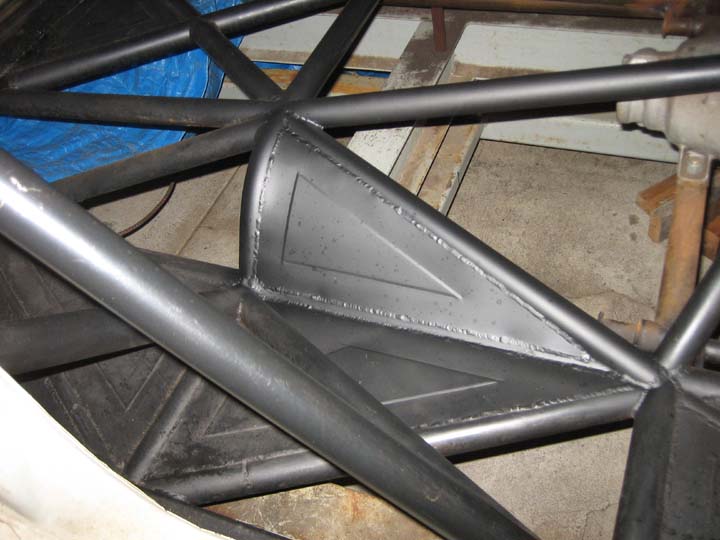

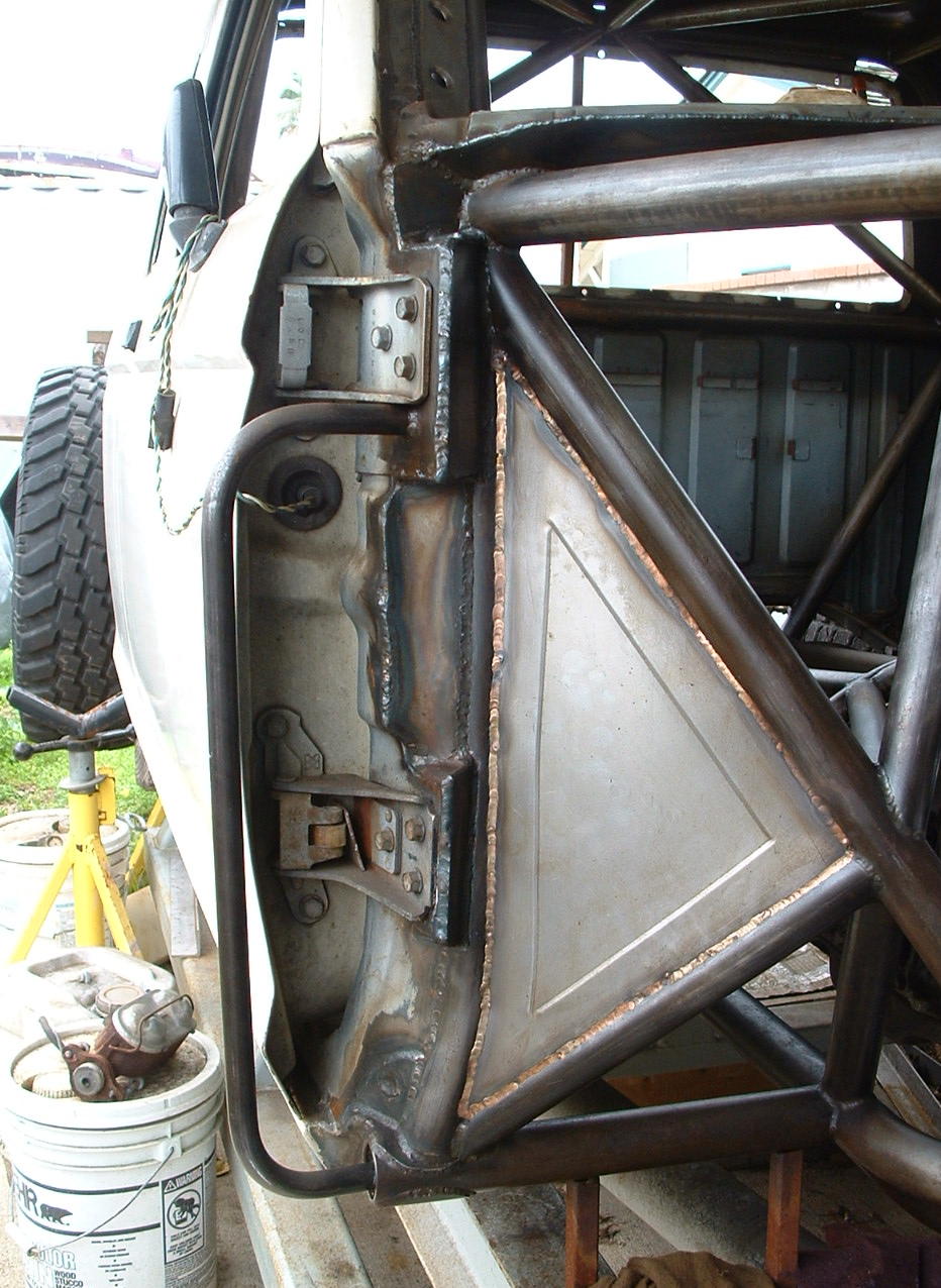

Hey guys what thickness of plate is used for the floors?
Re: Roll Cages... multiple threads merged
Depends on what exactly you mean Will. Landing plate for a tube that hits & sits on the floor? If so I've typically used .125"
If you mean what is used to patch a hole cut in the floor to run a tube though it I've used 22 ga (roughly.030"), 20 ga (roughly .040"), 16 ga (roughly .065") and even 14 gauge (roughly .080").
For custom floors on a tube frame like this pic I've used 14 ga & 16 ga.
2-13-05 Firewall 2.jpg (198.32 KiB) Viewed 1211 times
12-3-07 Floor.jpg (67.8 KiB) Viewed 1211 times
Thanks Steve! I was talking about landing a tube on the floor.
