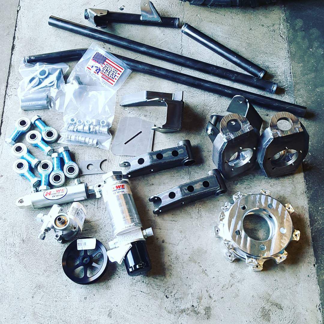

Finally got some parts rounded up. Waiting for the 3.5" bypasses up front but got my knuckles, with all the big brake stuff, steering ram, box, pump ect. and Desolate Motorsports dual swinger steering so we will start wrapping up the front end while we wait for shocks.

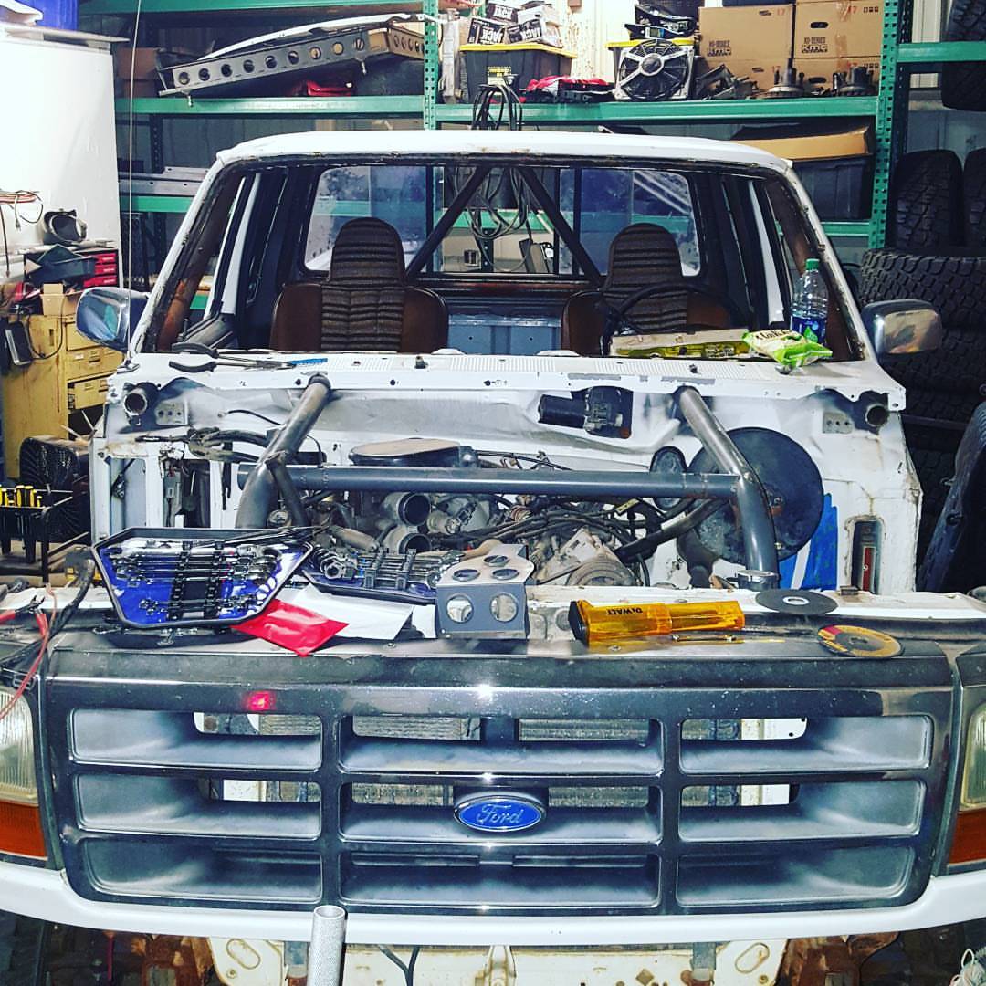

She now lives inside I guess its time for a bigger shop lol

Well after looking and packaging shocks we decided to start chopping parts of the engine cage out. We also ditched the AC stuff. After talking with some buddies I think we are going LS in this truck cheap simple power. I am totally against putting chevys in fords but I have built t400s sitting, access to low mile less than 1500 mi LS3s for super cheap so it hard to say no lol. So the low mile only 98k on odo 351w and the e4od will be for sale. Its a good runner with great power. The trans seems to have a reverse pattern so P, R, N, 1, 2, 3, OD and shifts great. Waiting to hear from previous owner what is done to the trans.
