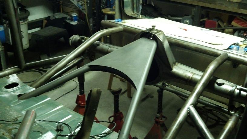

The rear end geometry is designed around drive line reliability
Driveshaft plunge is 1.08" and has 5 degrees of u joint angle at droop.
The rear upper control arm is 4130 just like everything else on the truck and is heat treated by Certified heat treating corp out of l.a.
Heat treatment was done on the UCA for side load (sliding the truck around a turn) and is made from 1.75"x0.120" 4130 and 0.100 plate if I remember correctly.

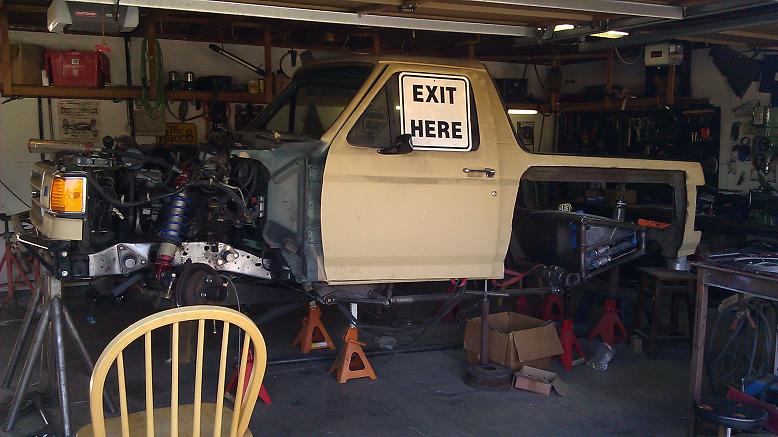

Andy since I'm behind on pics for the monster..... here are some more.

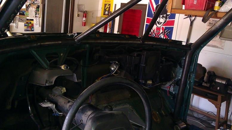

Re: Michael Cox's Street Queen

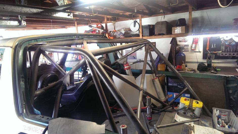

Some cage work started.

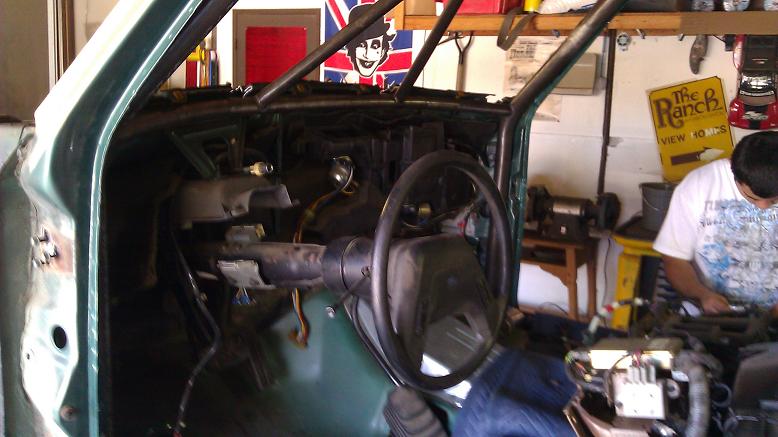

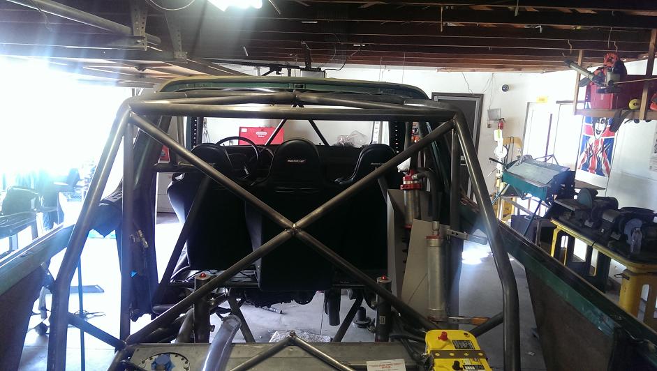

More cage pics

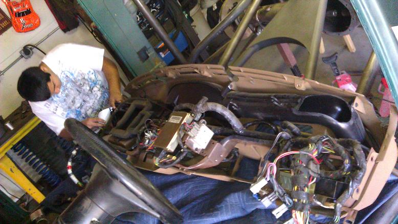

Post holiday pics!

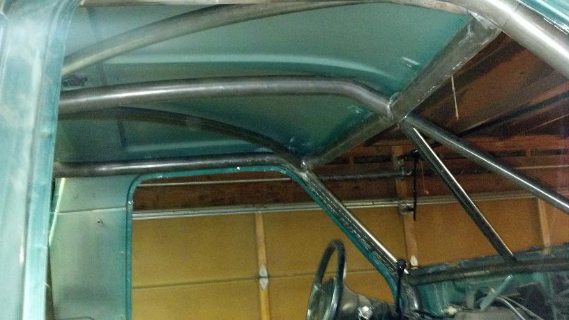

That looks like some awesome work. I like how the attachement to the frame is done. The interlocking tube clamps are a nice touch! Those things aren't cheap either.
Did you truss your and extend the beams yourself? They look good.
Can't wait to see finished pics...

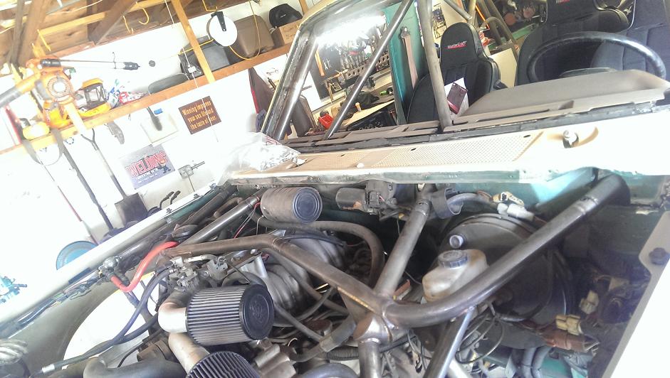

He's out testing in Barstow today Matt but here are more pics of cage/engine cage work with more use of tube clamps...
