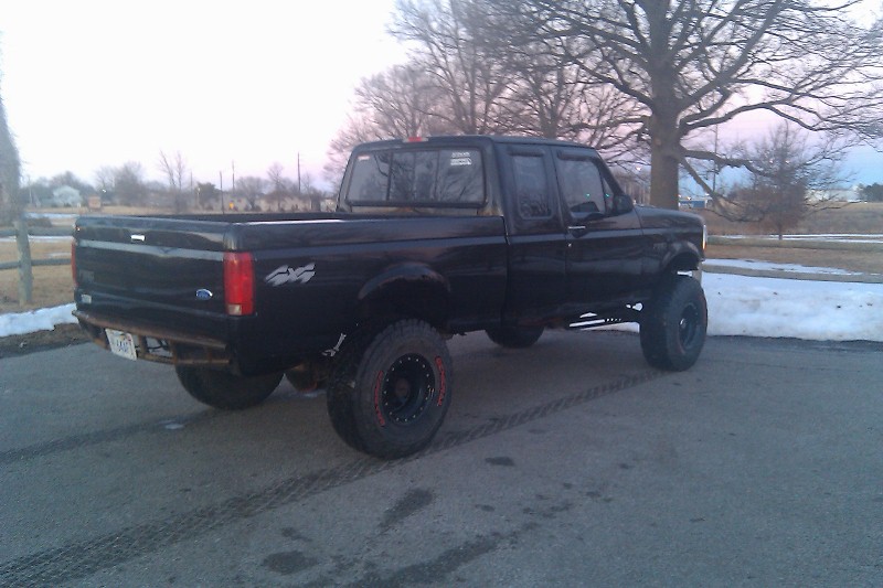

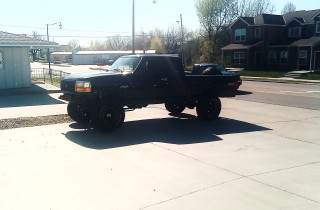

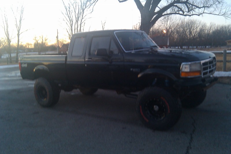

before
IMAG0083 (800x535).jpg (223.36 KiB) Viewed 3056 times

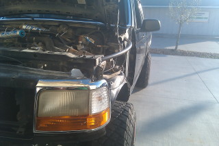

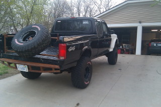

after
IMAG0116 (800x533).jpg (194.69 KiB) Viewed 3056 times
IMAG0111 (800x533).jpg (206.27 KiB) Viewed 3056 times
IMAG0114 (800x533).jpg (179.16 KiB) Viewed 3056 times

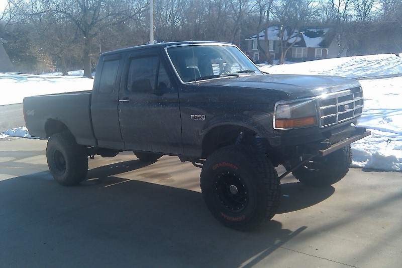

Post by jimmyd »

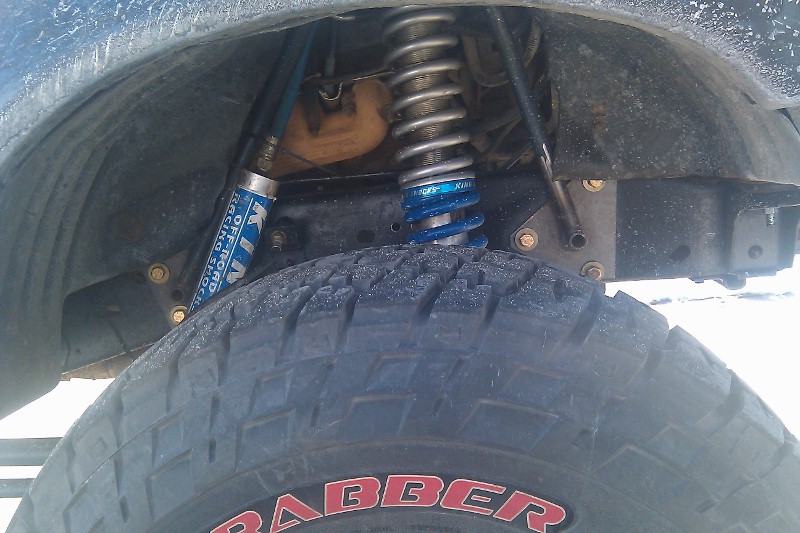

IMAG0120 (800x533).jpg (143.26 KiB) Viewed 3055 times
IMAG0122 (800x533).jpg (147.6 KiB) Viewed 3055 times
IMAG0121 (800x533).jpg (189.92 KiB) Viewed 3055 times

I almost done with my tire carrier so that should be done this week sometime. then need to build front bumper. is there a bumper thread on here? and then spend a bunch more cash on my fiberglass.
oh and most guys know that brake fluid messes up paint, it also melts plastic :evil:, my grille got eaten up. i had it sitting on my radiator and whatever was on the bottle dripped off and barely ran onto the grille and wrecked it.
IMAG0117 (800x533).jpg (185.25 KiB) Viewed 3053 times
but i already bought an all black one from LMC truck. about one of the only perks to living out here is that LMC Truck is about three miles from my house, so i am always getting new parts and not needing to pay shipping or return if its not what i need. I am also going to black out the headlight bezels and windshield trim.

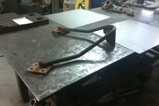

can i ask you where you purchased your front shock hoops? thanks...
CBDuner
Posts: 148
Joined: Sun Oct 24, 2010 8:45 pm
Bronco Info: Wishing I had one!
Location: Coos Bay, OR
Re: Go Fast ( presented in f250 HD)
Post by CBDuner »
Looks like he made them...

yeah i made them, built my whole front suspension if you go through the write up.... ;) i am going to bend up a set after work one day next week for my buddy in SD for his bronco. i might be willing to make a few sets if there was some interest

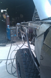

so i decided to skin my inner from outer fenders. got up bright and early, had some coffee, went out into the driveway and started.... about 2 hours later i drove my truck 4 miles away to the fab shop i work at, with one fender off the truck and crap hanging down. very quickly i decided not to proceed with that plan. no offense to anyone who has done done it, but i can't imagine why somebody would torture himself that way....
i decided to roll 1'' DOM to build my supports, probably not necessary but looks super cool!
i still need to do some alignment, and add some dzus buttons, but put in a full weekend building the support. need to get some engine bay shots.
just need to put about 1 hour into my tire carrier and bumper, and send to powder coat, and that will be done. then build front bumper.

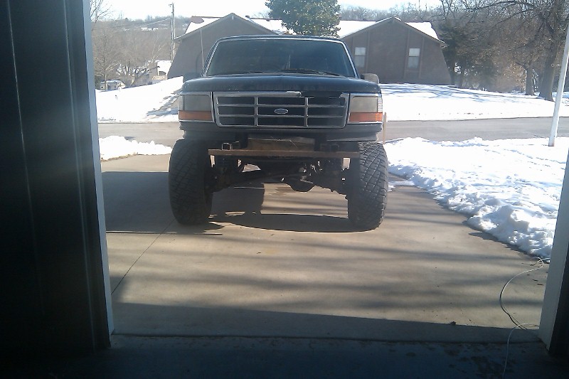

last week, before fenders, after car wash
shock hoop, right before sand blast and paint
