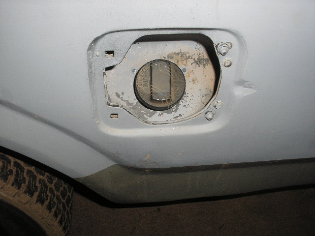

I also found a rear fuel filler tube from a 88 F250 at a local wrecker. It cost a bit more than I wanted to pay, but it's the screw cap type and it was there, so I handed over the cash. It needs a slight panel beating, but I'll do that tomorrow at work and clean it up ready to install with the tank. I will also pick up a roll of EFI hose to re-plumb the fuel system once the sender unit arrives. I have an addition to the towbar, and a couple of things to weld, then I'll get it sandblasted at work and painted so I can install it prior to the fuel tank going in. I have some propane plumbing to do as well during the install, so I can run the truck from tanks in my future get-away trailer.

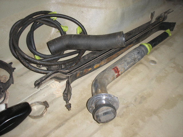

I dragged out all the reat fuel tank hardware and stacked it in the bed, ready for the re-fit:

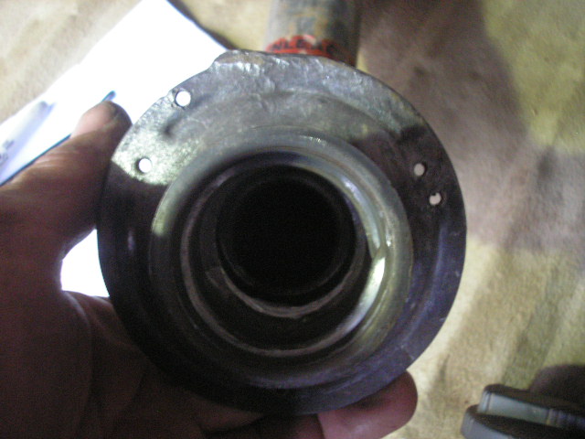

While I was cleaning up and straightening my new rear filler neck, I took the liberty of hole-sawing out the gas nozzle restrictor, so it is easier to fill/top up from jerry cans:

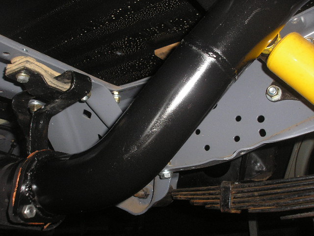

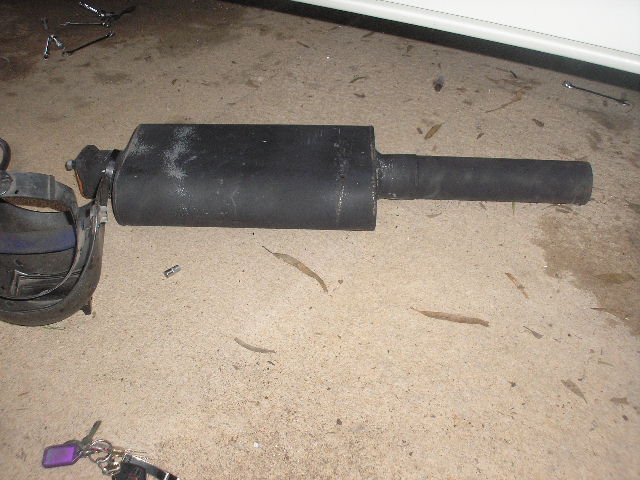

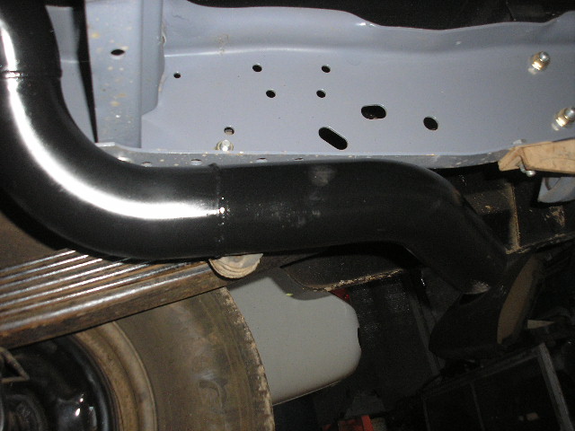

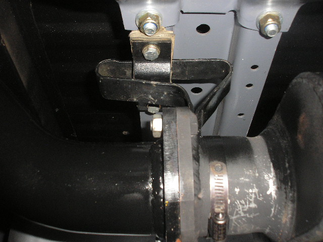

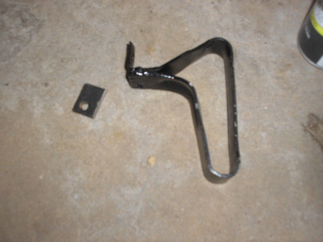

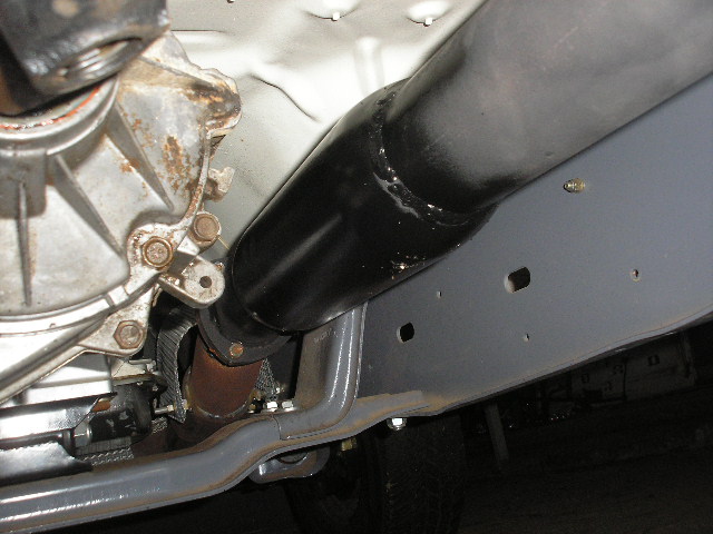

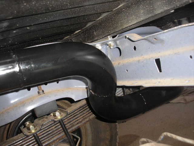

The next thing I changed was the exhaust. :cry: :roll: I know, it was all nice and sounded great, but I didn't want to waste a lot of time trying to re-engineer some kind of hanger for the muffler that would allow for heat expansion and keep the tailpipe tip from rattling on the fender edge, so I went for a rear exit and over-the-axle tailpipe. First, I cut the muffler section about 4" from the 3 bolt flange at the Y pipe and added a bullet resonator, to extend the muffler close enough to use the original Ford muffler hanger:
I had to shorten the drop 1" and turn the clamp tab toward the front to be able to properly hang the muffler:
Re: Rod's 84 BabyBajaF100
Cont:

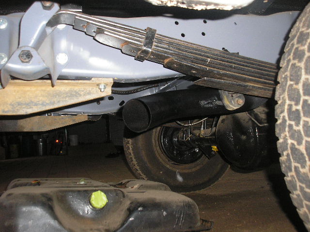

I used a hose clip to secure the muffler outlet to the hanger, and it worked out just nice:
The camera bateries died right about then, so no pics of the tailpipe build, but you get the idea (I had to get a presciption filled, so I picked up new batteries while I was out):
I even re-used the old rear hanger, so it's all factory (except for the pipe size). I pulled back the curtain hiding the truck from the street, brought the Triton around and jump-started the old girl to see how loud it was. Honestly, I was expecting LOUD, because no resonator in the tailpipe, but boy, was I in for a surprise! It is MUCH quieter than before, probably due to fitting the resonator BEFORE the muffler, rather than after it. It provides some expansion space for the sound waves before they hit the muffler baffles in the Flowmaster, and takes off some of the "bark". I couldn't run the engine too long, as the power steering pump is AWOL, so I had to pack it up. The power steering is next. That's a post for later in the week.

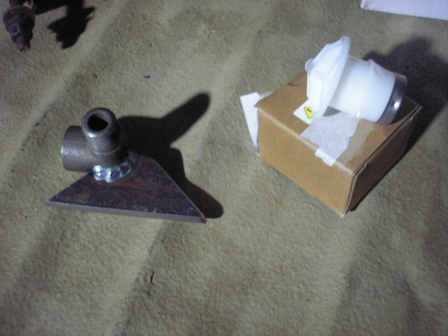

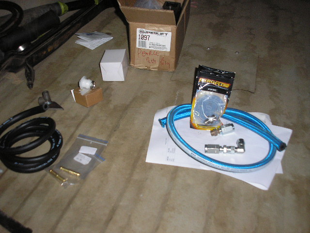

Just a quickie tonight. Forgive the blurry pics, it was getting dark real quick so I barely had time to snap away. Made a transfer mount for the propane feed from my future trailer:
The new tank vent arrived today, too.

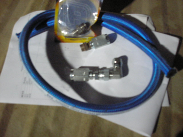

Picked up some fittings and a piece of appropriate hose to repair the power steering hi-pressure hose:
I'll take the steel line into work tomorrow, cut it and silver solder on the repair tail for the new hose connector.

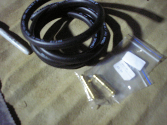

Only managed to get a metre and a half of EFI hose, plus some joiner pieces so I don't waste all that good hose during the tank install:
My Superlift 2.5" lift block kit came today as well, it's in the background:
Sender/pump should be here next week. Going to Phillip Island to pick up the SWB canopy I won on eBay tonight on Saturday, and hopefully my (new to me) Dana 60 FF axle in 4.11:1 at the same time. My +2" springs and shocks should be arriving in about 2 weeks (wanted the cheapest postage, so they will see the world on the way to downunder).

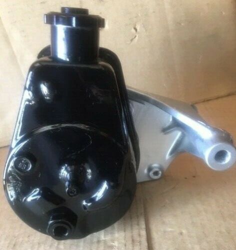

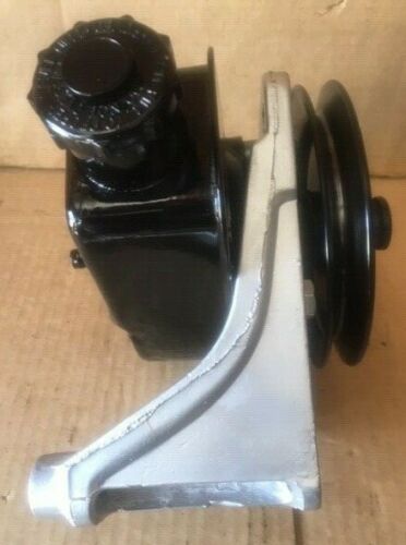

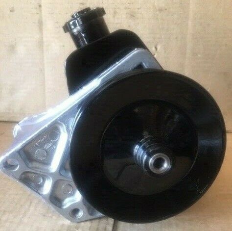

Unbeknownst to me, I'd had a Saginaw P/S pump for the late model Clevo set-up in the bowels of my garage. It currently is waiting for me to give it a clean out and re-assembly. I got rid of the Zford style outlet fitting and salvaged one from an old FSJ Sag pump I had out in the junk pile. I have the correct adaptor to JIC -6 for it, so I can make up the hose once I repair the steel pipe. This particular version of P/S pump for a Clevo wasn't fitted to any factory vehicles here, but it is a conversion available (still), using the Ford plastic pump mount and a clever use of spacers and a flat bar adaptor.
Found pics of the Sag pump set-up on eBay:
They only want a cool AU$495.00, plus $35.00 to post it....... :shock: :shock: :lol:

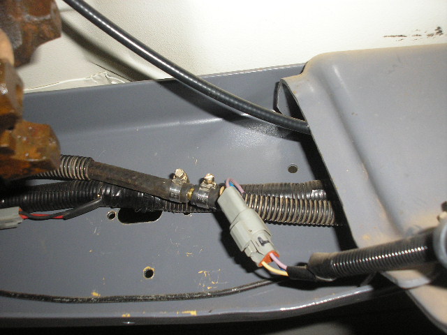

Cleaned up the rear fuel tank real nice and installed it tonight. Made sure I fitted the new vent valve and pipe BEFORE I lifted the tank in this time. Due to the exhaust tip getting in the way, had to put the filler hose through some gymnastics to get it up over the frame rail with the right side lifted in over the exhaust. Lucky for me, the tailpipe clears just over an inch and a quarter, so no mods needed. Also silver soldered the repair fitting to the power steering pipe at work today. I'll clean and re-assemble the pump hopefully before the weekend so I can make up the hose and fit it all Sunday.

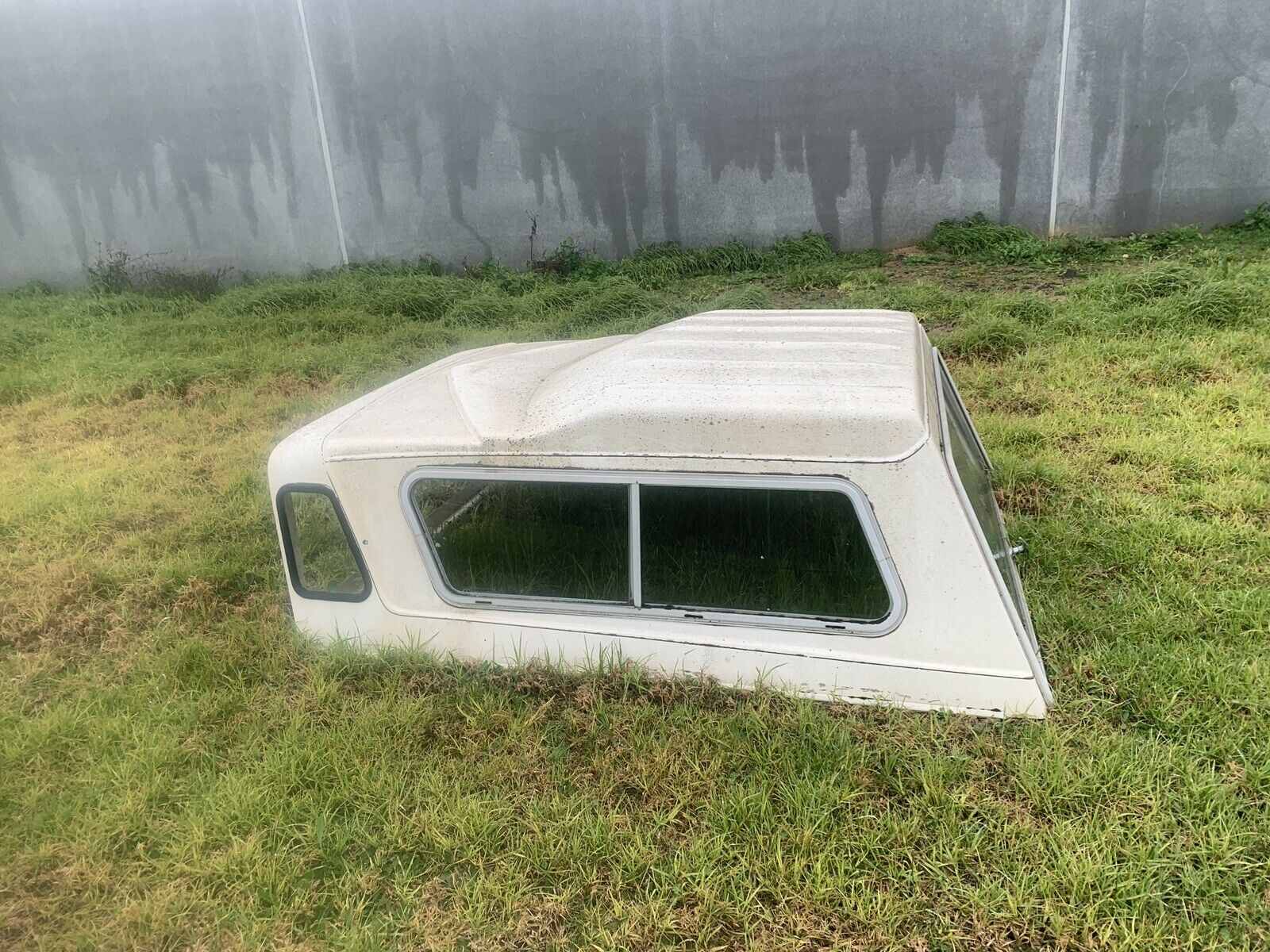

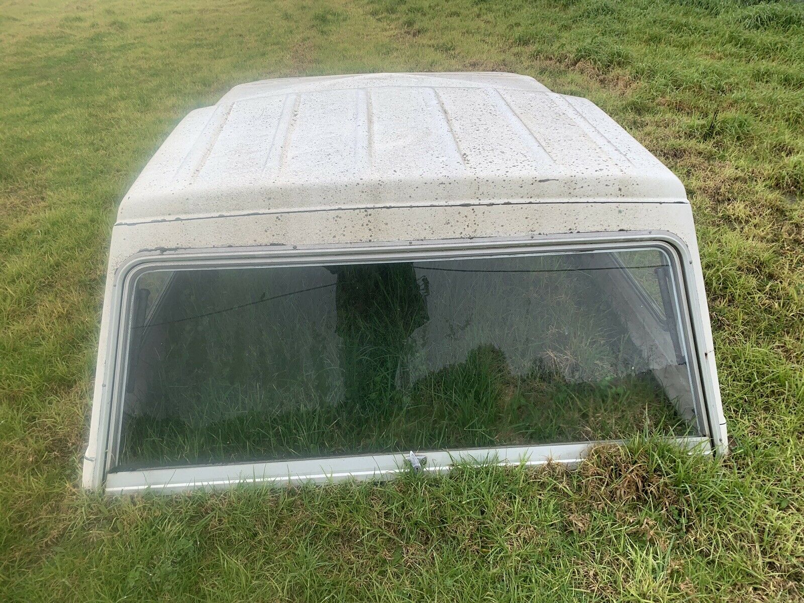

I'm heading to Phillip Island early Saturday morning to pick up the Dana 60 FF and the tub canopy. The canopy came off a '79 SWB, so if all the info I have is correct, it SHOULD fit on mine. If not, I'll clean it up and re-sell it. The diff will be put aside for now until I have room and time to go through it (not making any plans until it's in my garage). Now I need to find a D50 TTB and pivots, plus a NP435 and bellhousing for the V8. Next week will be a big eBay sale so I can get rid of unwanted stuff and recoup some cash.

Rod - for the canopy, the beds are the same dimensions. The back of the cab/rear window has a slightly larger angle on the 73-79 trucks if memory serves, but the canopy should still work.
ChaseTruck754 wrote:Rod - for the canopy, the beds are the same dimensions. The back of the cab/rear window has a slightly larger angle on the 73-79 trucks if memory serves, but the canopy should still work.
Thanks for that, Steve. I was reasonably certain they were the same size, only the outer panels were different. The seller wrecks F trucks and Broncos and assured me it should fit. Pics:
The front glass will be with it, as it was still in the back of the truck it came off. Like I said, I'll clean it up and fit it....... if it doesn't fit, I'll re-sell it.

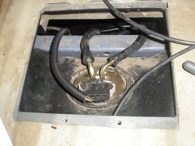

Pulled the fuel pump from the rail and made up an extension to join the front hose to the fuel filter. I WAS going to re-fit the filter back in it's old position above the diff, but decided to keep it where it is now.
Pump removed:

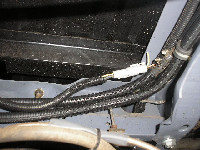

I managed, with great patience to get the new fuel line in behind the side tank and clip it up like before. There isn't much room in there for my big c*nt scratchers, so I had to take the time and be methodical. All the lines are re-fitted in clips like before and secure:
The 87 - 91 sender is still in the tank and will stay there until I'm ready to swap it over:
