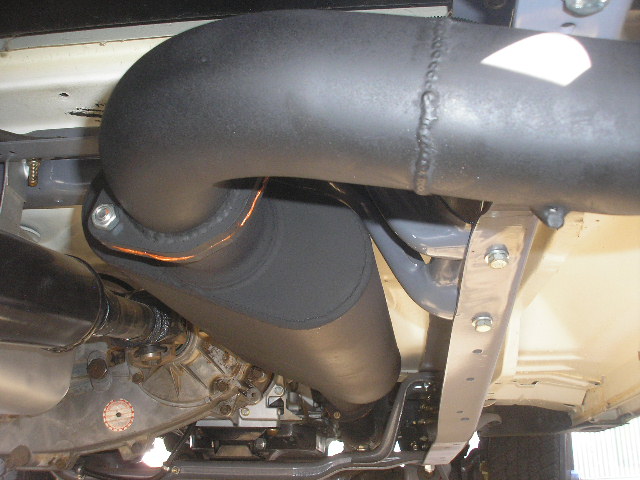

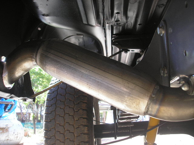

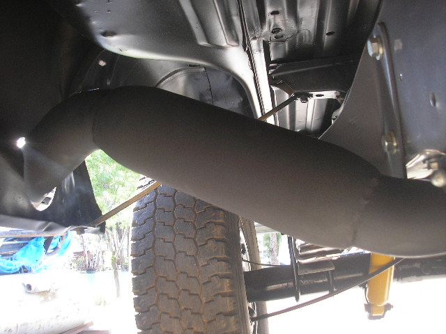

Needed to spend some quality time with the Handbrake (earning brownie points), so didn't do anything yesterday. Now that I have some free time again, I got the F100 out of the garage and set it up to do the resonator. After removing the tail pipe (with welding gloves because it was bloody hot), I trimmed off the section after the chassis upturn and bolted it back on to set and tack the resi on:

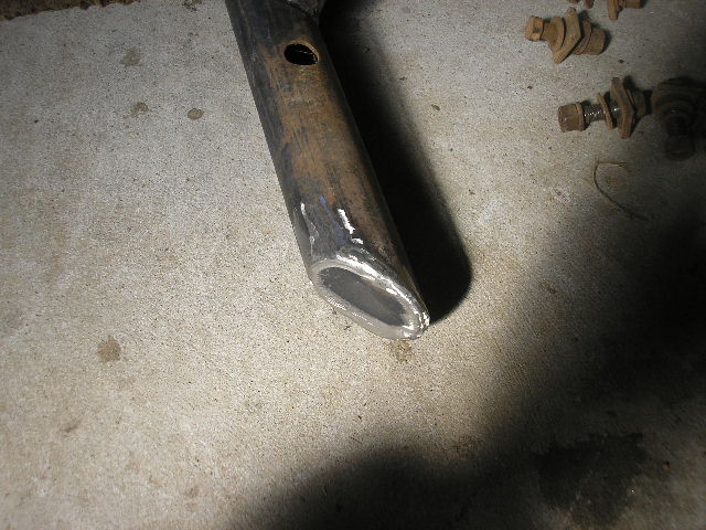

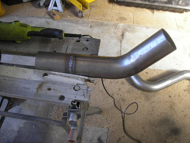

I then trimmed off the elbow to tack that onto the resi once I'd tacked it to the tailpipe:
After tacking it all together (and doing to obligitory start to hear it) I removed the assembly and welded it fully. I'd also marked the cut off when it was tacked up to cut it once welded:
Now it has lost that metallic raspy note and is more mellow and deep, but still sounds nice when idling "on the cam" and at revs. Once that was all done, I removed the exhaust and after a good clean and wire brush of the welds, etc. I hung it up and gave it a good coat of flat black hi-temp paint while it was still hot. Once dry, on it went with some Ultra Copper sealant.

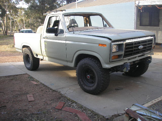

After finishing off the exhaust (for now), I couldn't resist the temptation to fit Mike's old Bronco wheels and tyres to see how they look on the F100:
Instant 3" lift (sorry about the shadows, it's late arvo):
One of the rears (LHS) is a different offset to the other 3, so it sits out 3/4":
The right side JUST hangs out, fine for everyday use, but not for RWC inspection:

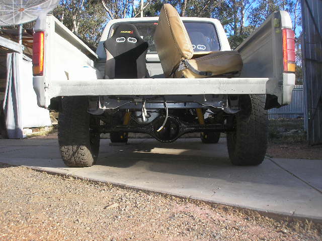

Plenty of roon unter her bum now:
Side on, the clearance underneath is fantastic, nothing to hook up or drag if I go crawling:
Really happy with the underside, although after the inspection, and rego (if I go that way) I will make up a mid-flap to protect the rear end, shocks, etc. like some of the GFB guys have done.

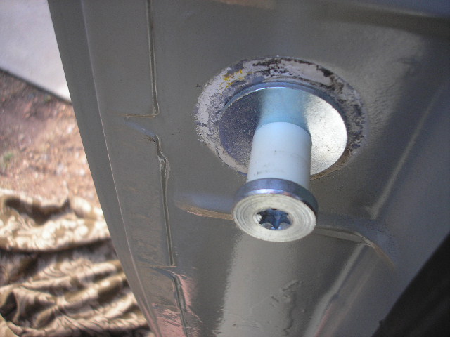

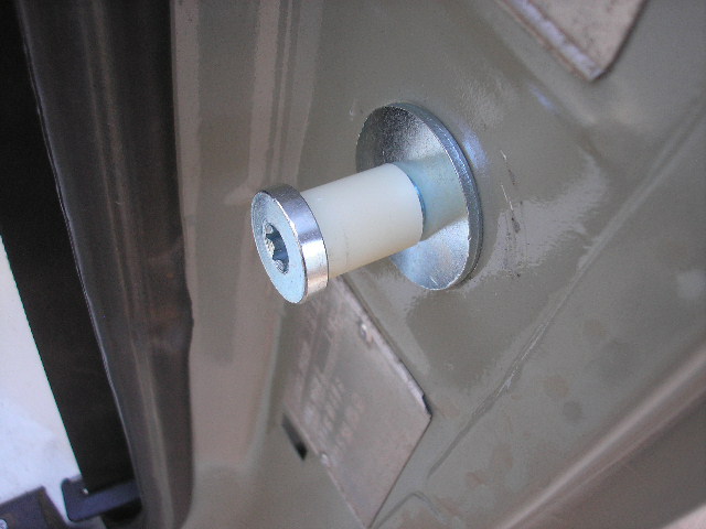

Also fitted the new door strikers. The passenger (LH) door is perfect, but the driver side (RH) the top is in too far and will need a slight hinge adjustment to correct it once the new seals go in (tomorrow). I will also get some art craft brushes, as I need to go around the body and chassis and do some touch-ups to make it all look a little closer to new(ish):

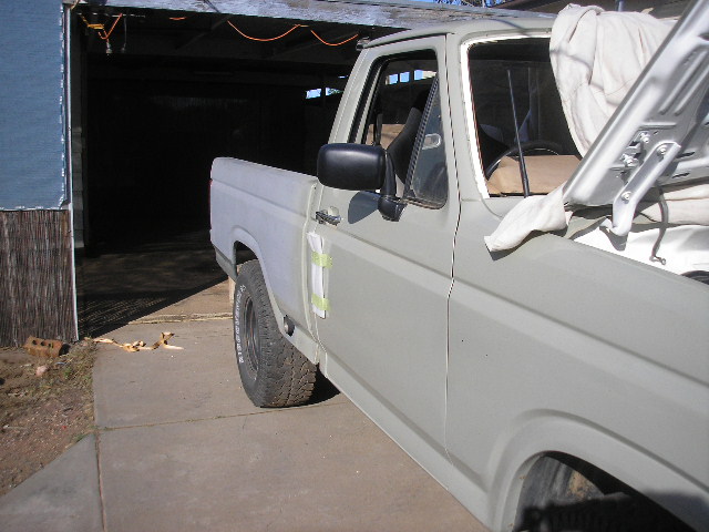

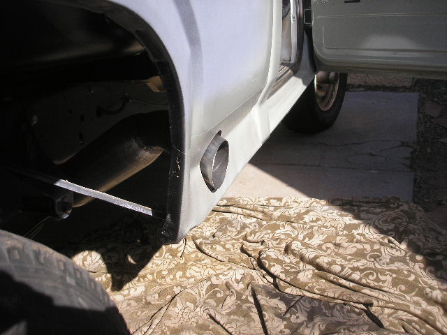

Once she was under the carport, I snapped this. The front wheels have a little negative camber, almost perfect to keep the tops of the tyres level with the fender edges:
Once the new tyres go on the Alcoas, they will fit nicely under all the fender edges and look really good. Likely I will book the 'screen for Thursday and do the TV cable set-up tomorrow so it is ready to drive Friday. Can't wait :P 8-) :D

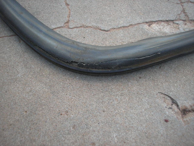

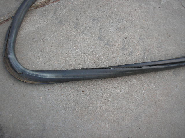

After a couple of trips to my supplier (forgot the pinchweld sample), I picked up 8 metres of door seal/pinchweld and started replacing the door seals. I had to basically undo the dash top to get the bottom screws out of the A pillar panels, trying hard not to break anything, but as the trims have a standout at the bottoms that hooks under the crash pad, I had to carefully work the new seal around them into place. I didn't bother re-installing those screws, as the trims sit tight enough, and the new seals work perfectly (almost). The LH door closes perfect, no movement and is easy to open and close without using force:
The upper rear corner was the problem area on the LH door, but the old seal was hard and mis-shapen from age, so replacing it was necessary:
The RH door seal went in easy too, so it wasn't as big a battle as I'd anticipated:
Top of the LH door seal where it is damaged:
RH side was much worse and over a longer area (due to more use):

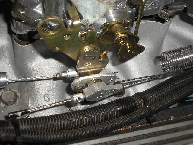

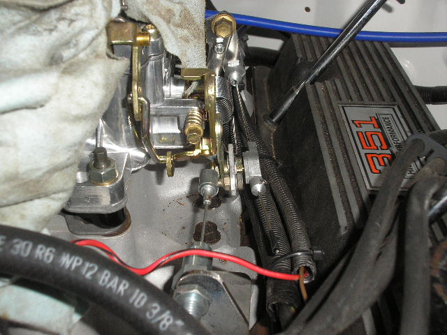

Yesterday, I finished the throttle lever tab and fitted it up. Due to a slight dog-leg in the throttle lever, I couldn't fit it behind as I planned withour running out of thread on the stud, so with some minor adjustment, it fits:
I redrilled and cut down the original accellerator cable bracket and it works perfectly, all the alignments are good, just need to fine adjust the TV cable to match:

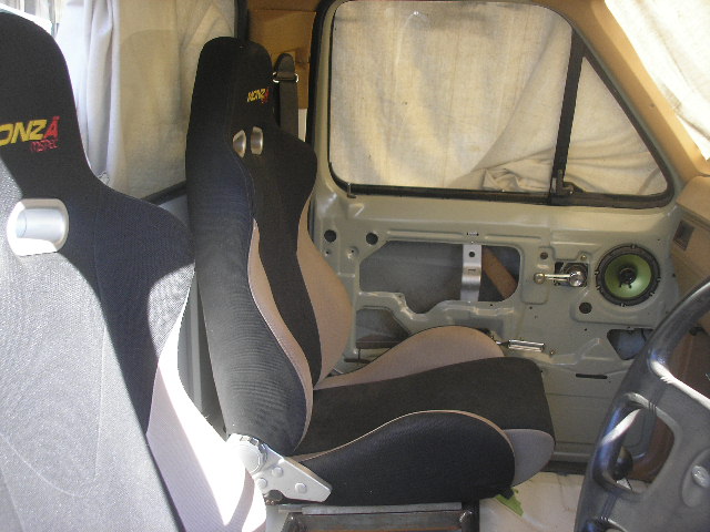

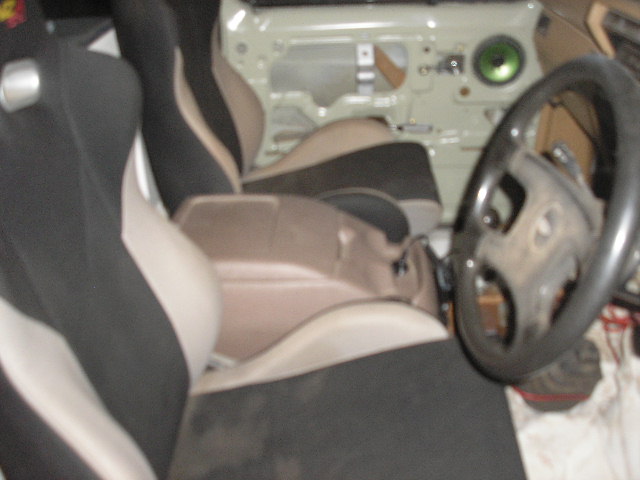

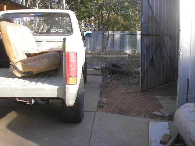

What did I do today? :roll: :? Oh, yeah, I fitted the tracks to the passenger seat, made a new lock connector and re-fitted the seat to the frame. I then dug out the centre console box and bolted that back on. I also fitted the plugs back into the floor. I'll need to fab some tabs that bolt the frame to the centre belt holes and also extend the seat belt mounts up so I can re-fit the buckles for the outer belts. Now it's starting to look like it should inside:
I then tackled the driver's door, by using my knee on the inside and pulling the upper frame in. I did the rear first, then the front, then adjusted the bottom hinge to pull the door in about an 1/8". It seems to fit the door opening much better, but I can't re-position the striker any more or the door will sit in too far at the back and look stupid:

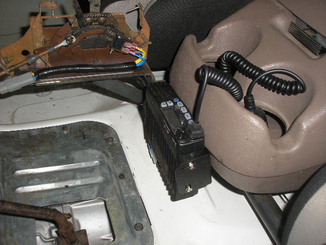

I mounted the little Icom UHF on the front of the console box. That seemed to be the most logical place, as I am starting to run out of room. Anyway, it's mounted in place, ready to do the wiring and co-ax, the floor cover and it's patch. That will have 2 holes for the shift cable and wiring for the inhibitor switch(es) on the shifter and radio (to the battery direct). I also bought a little 2.1dB gain ariel for the roof, so I don't wipe out my longer 4.5dB whip in a shopping centre underground carpark (done that before):

Radio mount shot:
Rather than extend the co-ax, I will re-route the co-ax back from the dash, use some convoluted cover and run it behind the seat(s) on the mounting tube and I won't need an extension. I'm in the process of doing the wiring for the inhibitor switches and UHF now, so I'd better get back to it.

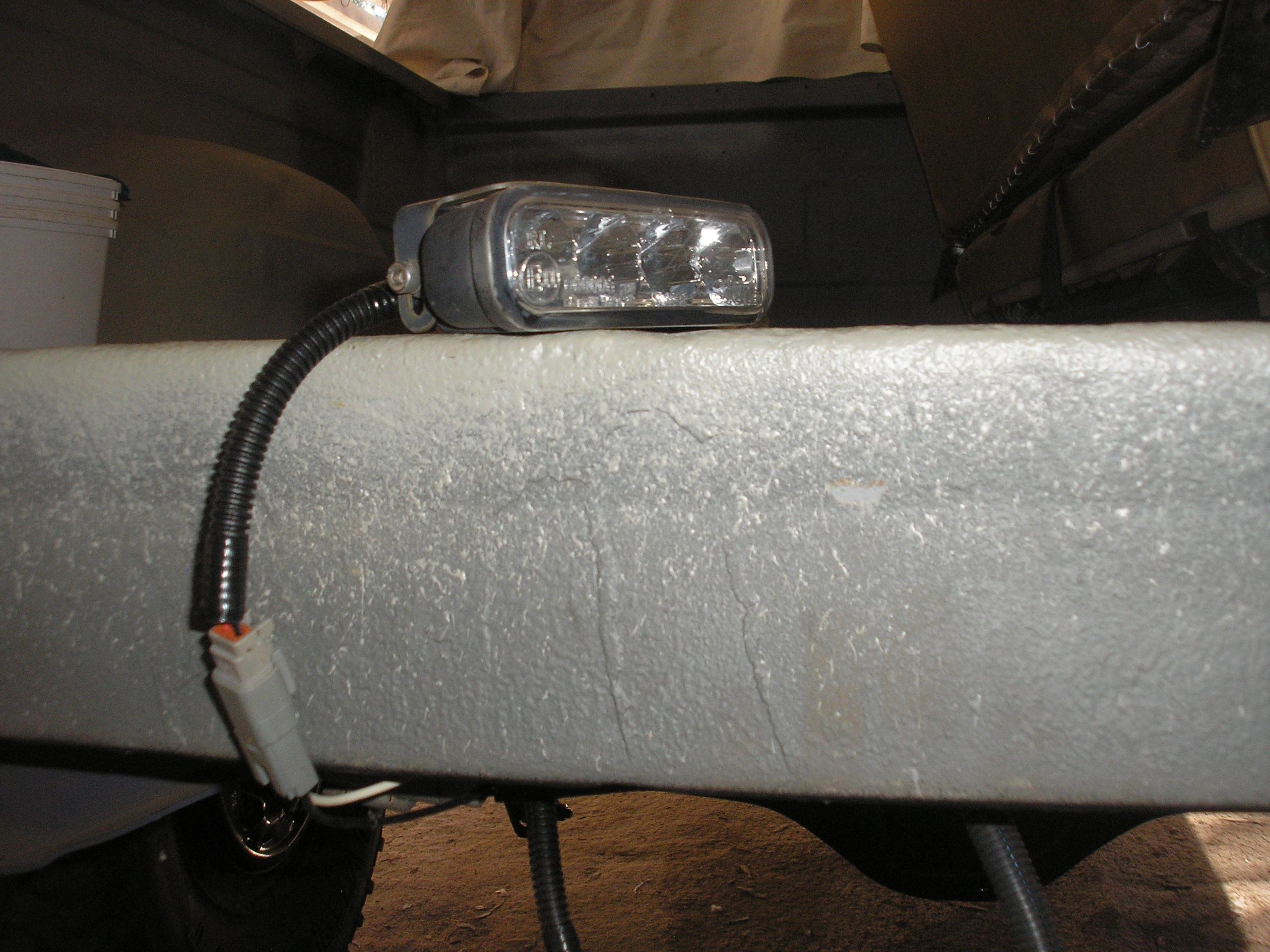

Found the little LED flood and wired it up as my reverse light, works perfectly:

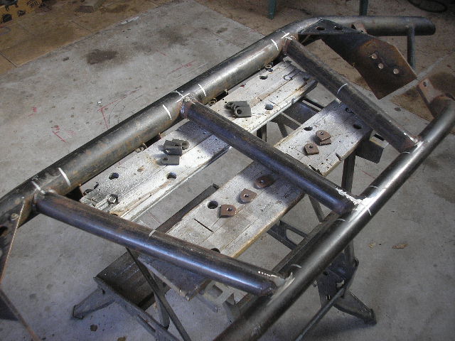

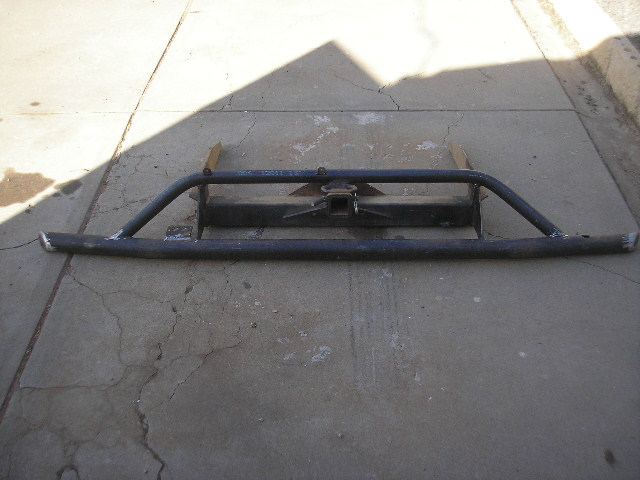

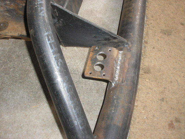

Condensing 2 days into one. Got the bumpers out yesterday, stripped off all the lights, etc. and started cleaning them up, finishing the welding they needed and welding on tabs, brackets and such. Did the rear first, cleaned up the welds on each end:

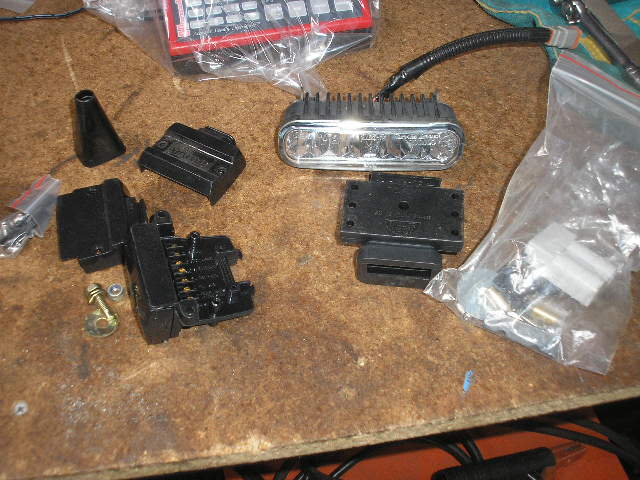

Welded on a small mount for the Anderson plug holder:
Pile of things removed. Multi-pin trailer plug (fits trailer or the caravan), Anderson plog holder, reverse LED:
I bolted it back on the truck to do the final wiring terminations and make sure everything still is as it was when I dis-assembled it.

Front bar getting tabbed:
Back on the truck:
I'm going back out after dinner to finish the trailer plug off, check the wiring for the licence plate LED and start planning the HDPE for the front bumper, simmilar to alpinejd3's bumper. I need to fab a few brackets and tabs for the install. These I'll make at work later this week. Ordered the windscreen for fitting tomorrow, so if that goes well, I'll get the unregistered permit tomorrow arvo and go for a short drive. :D :D I might steal the power steering cooler from the old Jeep and start working out the location for that, then go looking for a sheet of aluminium for a skid plate.

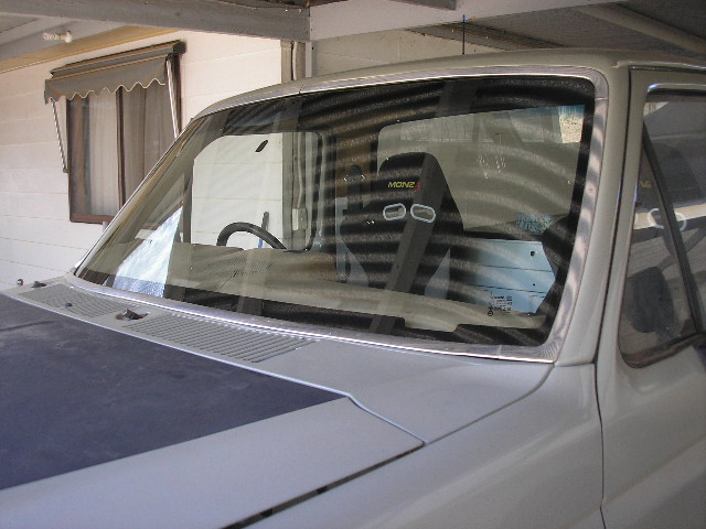

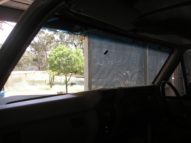

WOOHOO!!! It finally has a windscreen!! :D :D
