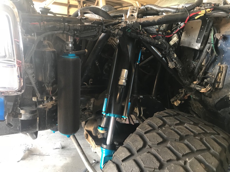

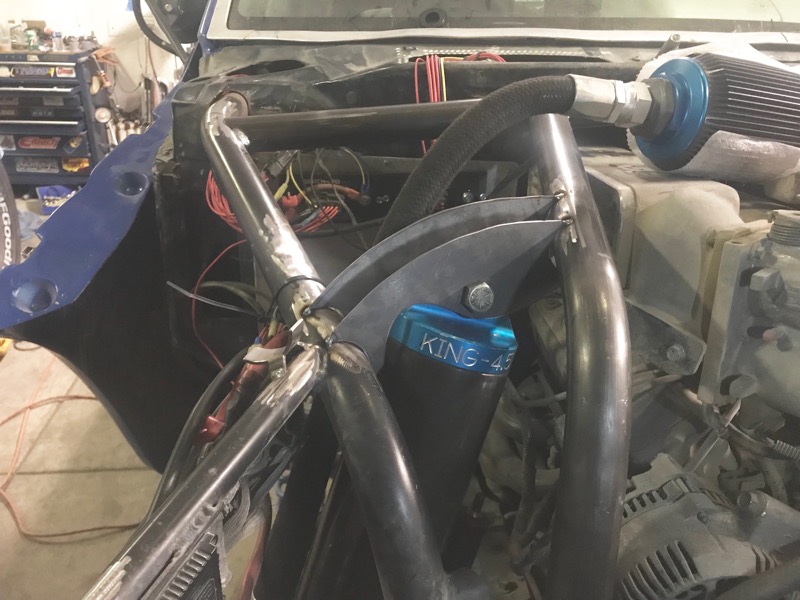

VikDok got the front end dialed with a super quick turnaround like always. Had to redo everything up there except one main tube to fit the 4.5 bypass. King is doing some repair on the front coilover and once it’s back we will go through and valve everything then go shock tuning!

alpinejd3 wrote:VikDok got the front end dialed with a super quick turnaround like always. Had to redo everything up there except one main tube to fit the 4.5 bypass. King is doing some repair on the front coilover and once it’s back we will go through and valve everything then go shock tuning!
Stoked on your build she’s come along ways, looks good !! Adding those front bypasses should make front perform as good as the rear. I like your progress photos, closer to mine being in that same garage Saturday morning.

cs_drums wrote:Are you running the IBP and a traditional bypass up front?
Yes the IBP and traditional 4.5 bypass. Both were valved with the setup in mind, and I am told by the guy who will do tuning this will be dialed. Thoughts?
John's 91 GFB
I was just curious. I didn’t think the IBP was necessary with traditional BP.
alpinejd3
Posts: 227
Re: John's 91 GFB
Post by alpinejd3 »
cs_drums wrote:I was just curious. I didn’t think the IBP was necessary with traditional BP.
I see, and yes I agree don’t think it’s nexessary at all but I had the IBP’s already and didn’t want to go through the hassle of selling them and getting a regular c/o. I was originally planning to just run the IBP but was not happy at all with the performance. Long story but the reason I wasn’t happy is the IBPs were defective and the metering rod came loose and misaligned and was smashed into the top, destroying everything inside. I didn’t discover this issue until we went to fit the 4.5 bypass and the IBP would not not bump. I’ve heard many people say the 3.0 IBP is more than enough and had it been working very well could have been the case. I guess not such a short story, but that’s why I’ve got the 4.5 and IBP.
