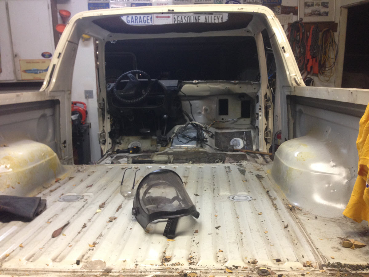

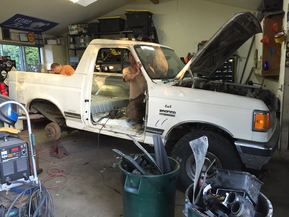

Last night started the gutting, I will also be removing the rear floor from behind the drivers seat rearward, and removing the inner wall of sheet metal from the rear 1/4s, and adding a simple tie in to hold the pannels from flopping in the wind.
I needed to weld the tubes to the 8.8 and make a truss.
Add fuel cell.
Make bumper for the back, something lighter up front.
I've taken a good amount of the weight off it, do I need to truss the front end? I left a voicemail with Threat to see if he had a plate kit for a stock TTB.
Cut and turn would be nice, not going to happen in this time frame.
I've like to find some lift drop brackets to give this truck some negative camber, but I've not found any yet.
Anyway, I'd love to hear your thoughts on how to improve this as I've been out of the TTB game for a long time.
Add fuel cell.

I'll add that the door are going back on, it's just easier to gut and build a cage with them gone.

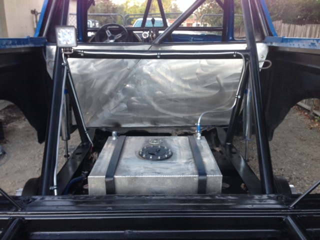

I was just going to make a truss on this one out of 1"x1" 1/8 wall square stock. It held up on my jeep pretty well, and it's quick and easy and the square die for my bender has only been used 3 times, I gotta get my monies worth on it!
I did weld the tubes of the rear axle and add more weld to the plug welds.

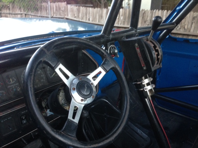

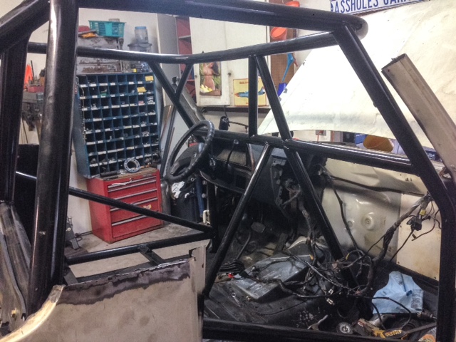

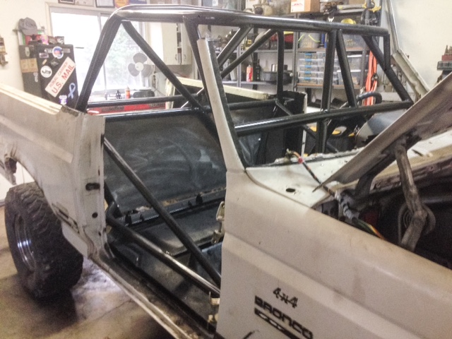

The roll cage is complete, The B hoop sits on top of the front spring hanger, the joins the frame there as well with a kicker, mainly to beef up that hanger and it was an easy spot to land the cage.
Front A posts land on the frame, you can see there are 2 dash bars, the center bar is for my shifter, the other bar goes to the frame.
The front bars go from the A hoop and land on top of the coil buckets.

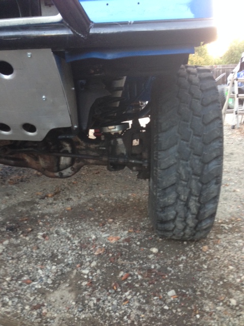

I ended up scoring some dealer take off 14" travel fox 2.0 shocks, so it looks like I will have some rear shocks, the front is still white box shocks.
I am worried about the rear springs being too stiff, you can see how high it sits with all the weight removed, I might ended up taking the bottom leaf out of it, but it needs to get jumped first to find out.
2.5 inch springs sounds interesting, but I can't move that front hanger now, so I'd need to run spacers.

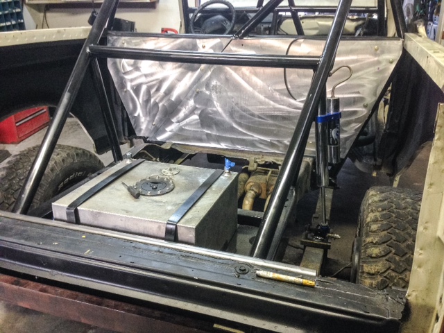

The fuel cell is in, and I hooked a battery to it and it still started and ran, so that made me happy that no one cut any important wires while gutting it.
There are 2" wheel spacers in the back, and 1.25's up front (what I had on the shelf), mainly to give it a more stable feeling in the corners. The rear fenders need to be trimmed as well, or the tires will do it for me.
I have the rear firewall in (some races require something between the fuel cell and the cab) but it's mainly to keep mud off of me.
The rear shocks mount off the top of the u bolt plate to the cage. I have 9" of up bump from ride height. (my last car had 12" TOTAL travel). I have no idea about down travel yet, I was only setting it up for full up travel.
I did trim about 1.5" off the rear bump stops as well. The factory bumps are too squishy, I'd rather have the shock do more work and have the bump stop be firm. After this season, a set of air bumps will go on, but as we are all sticking to $1500 cars, I did't want to put my $400 air bumps on it.

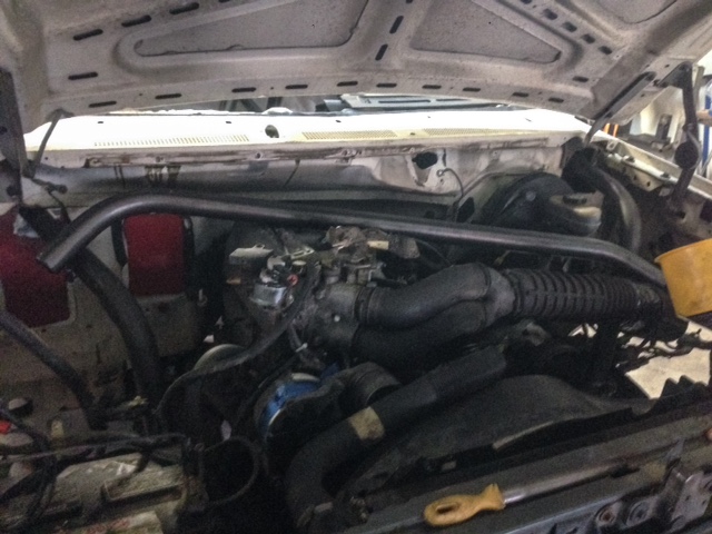

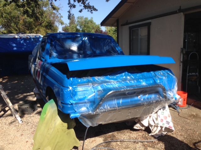

Damn, I was hoping I'd take more pics, but I didnt.
The Race is on 9/24.
I built out extended Radius arms, but it's still held back by 2 Rancho 9000's up front.
I added a steering quickner.
It's been a constant battle every day after work, but I hope to be mostly done this weekend.
If so, I will head to the junk yard for a Saginaw pump as with the quickner, I don't think the ford C2 pump will live long.
