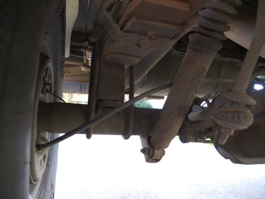

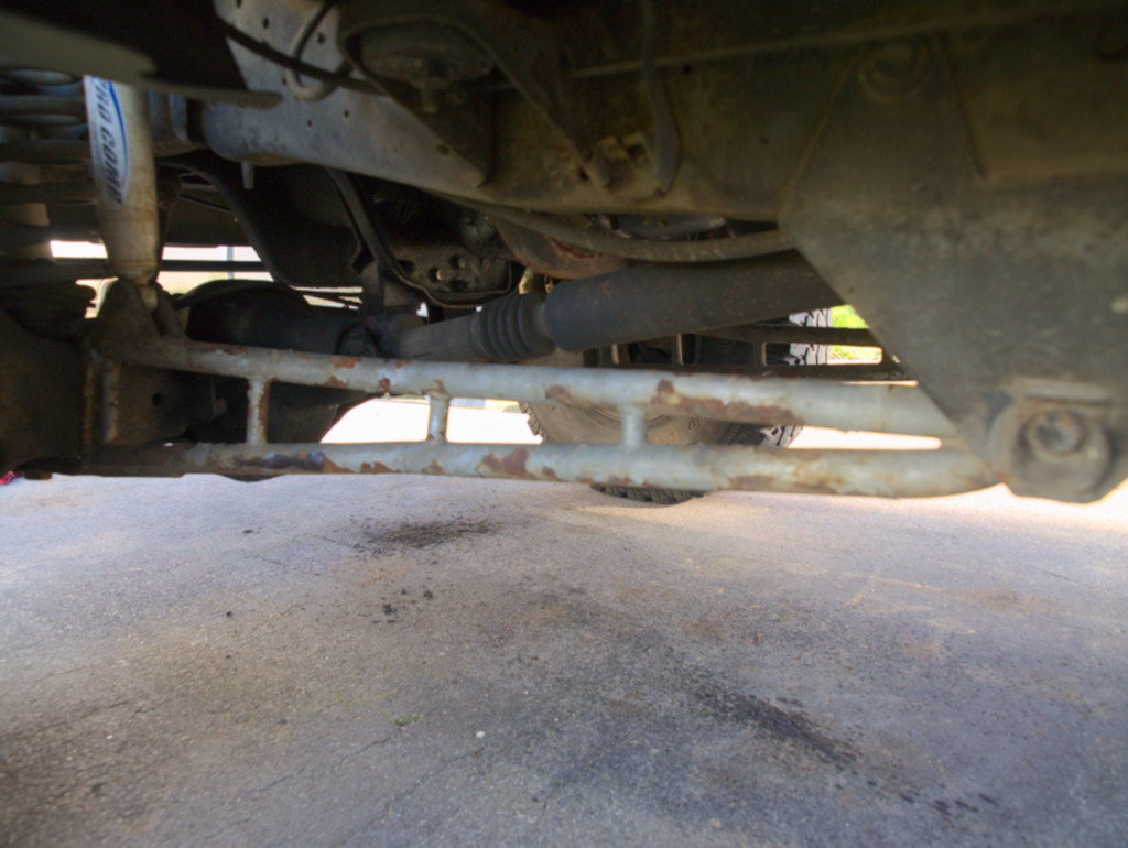

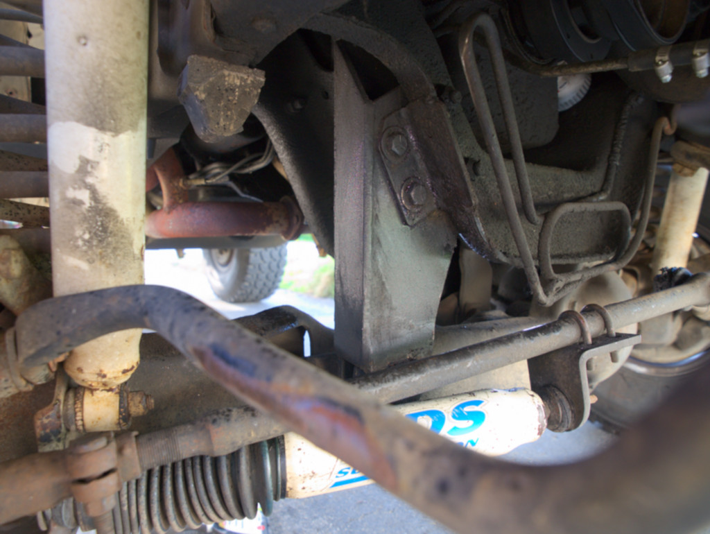

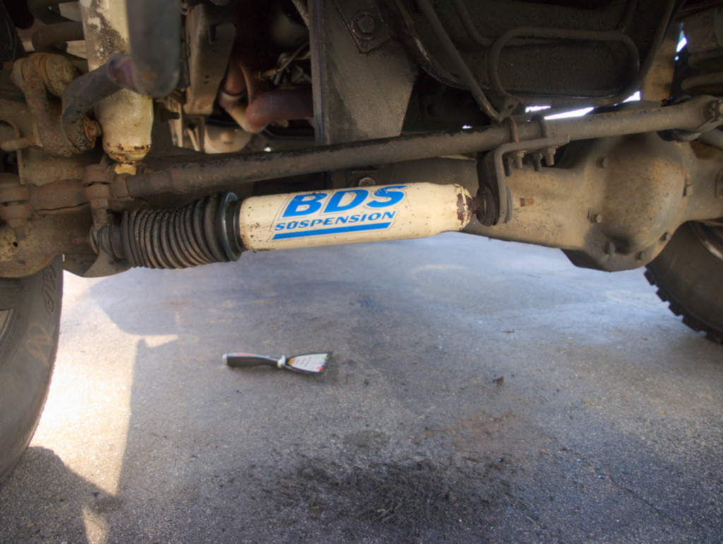

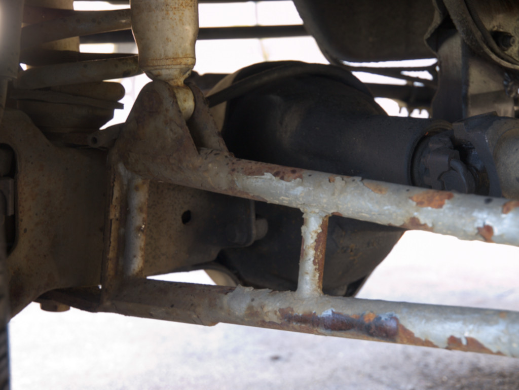

Ok I'm on a limited budget atm as I'm probably gonna get my tranny rebuilt and maybe the engine but this will be after the suspension work. Body first, suspension, tranny, engine. So what I want from the truck is good street driveability and be able to go fast with out bleeding kidneys on forestry/dirt roads. \ Eventually (two years) I'll go with more advanced front suspension but don't need anything that will do Baja 1000.
Currently I have a 6" lift and 35" tires. I've attached photos of the current lift. I plant of having all the bushings and tie rods replaced/upgraded soon. So need suggestions to get the most of out the current setup. I'm also going to get Blistein 51** shocks as the Pro Comp ES 9000 are rough. I guess for the rear I'd go with Deaver leafs and remove the stupid lift block but not sure about the front. Would like for now to be 0 fabrication (ie welding) if possible.

A stage one kit would be a great base for which to build upon in the future. Don't dismiss it right off the bat. Cost out the work you have planned and labor versus what is in the solo kit. That lift looks to be in rough shape.

I'd love to but atm no way could I afford a whole new set up. With CDN exchange rate that kit would cost me $2900 ($350 core) after shipping and 12% more if I was charged tax at the border. For that much I could get new shocks, have the whole front rebuilt, new Deavers for the back.
I guess for now I'll just replace all the tie rods/bushing/ball joints get Blistein 51** and Deavers for the rear.
