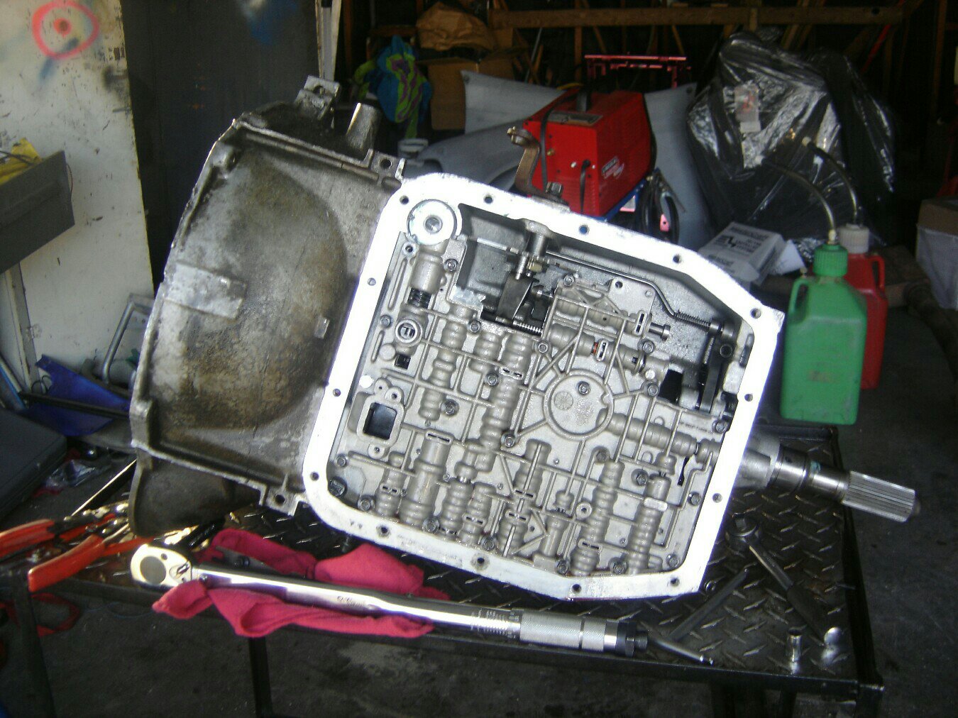

I am not apposed to a 408 conversion, but I have heard of issues also with the bell housing cutting. Also, I am not a fan of the electronic solenoid setup. I know I am old school. I can rebuild and repair a C6, turbo 400 and AOD without computer diagnostics.
Here is my last go with the AOD after smoking the reverse clutches pulling a Van out of the dunes at Pismo. The guy had the parking brake on. A** H***. We still played in the dunes for two days with no reverse. I just learned to drive better and not need reverse.
The Allison specification torque converter worked well. With my plan to do a 408 stroker motor, the AOD may not cut it. Did ford ever put the AOD on a 460ci motor. I don't ever recall seeing one.
