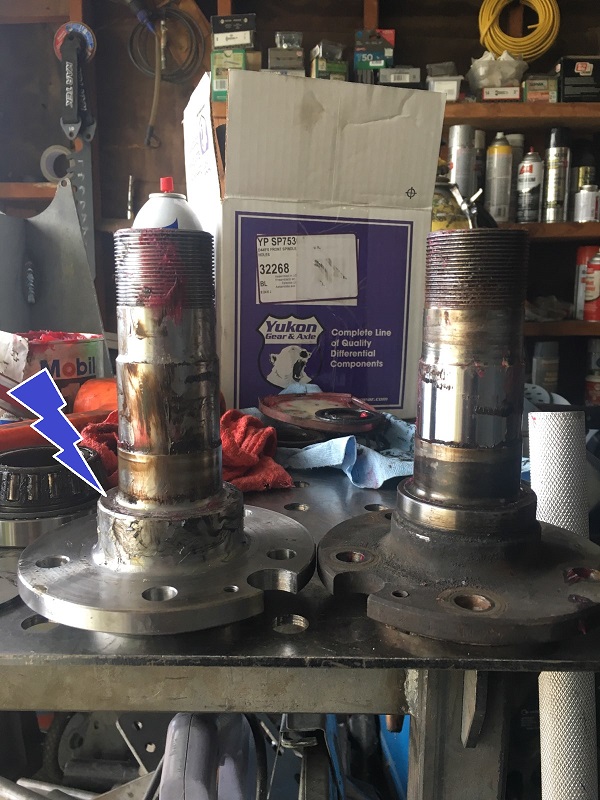

so i learned this weekend that not all d44 ttb spindles are the same and after a bunch of reading it would appear i am out of luck on finding a replacement for my 96. yukon lies on their website claiming its a 93+ spindle, which is what i ordered in anticipation of dealing with some mijo induced carnage.

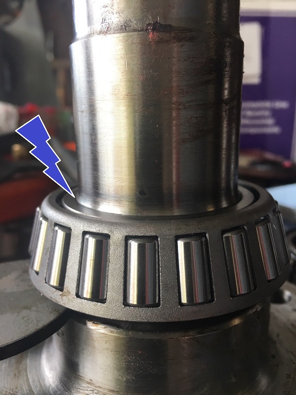

so based on the pictures below, i could get a spacer made to move the bearing race contact surface up to to match the 96 dimension and use a 93 seal that goes over the large ID of the spindle. this would keep all of the 96 bits functional and the only 'custom' piece would be the spacer. i will just barely have enough bearing seat, any reason this wont work?

Any reason you can't just get 91-94 bearing and seal set? Are there differences inside the hub as well? I suppose worst case you'd have to swap the hub out or bearing races to make it work properly. Seems a lot safer than a custom fit spacer.

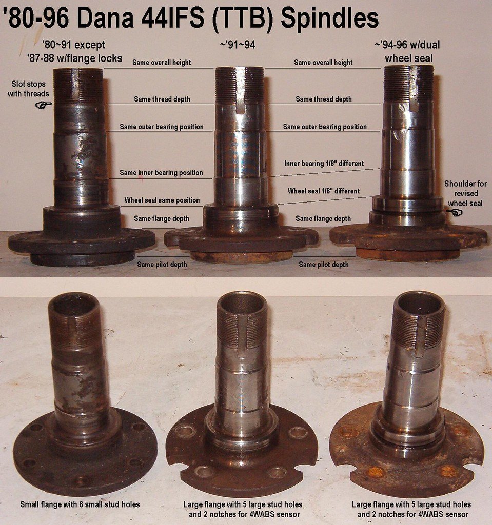

The bearing spread inside the hub is slightly shorter on the 2 piece seal spindles. If you try to put a 2 piece seal hub on a 1 piece seal spindle, the nut will bottom out before the bearings ever tighten down. It might be easier/safer to just find a set of 1 piece seal hubs. The 2 piece stuff seems harder and harder to find. Keep in mind that the rotors are specific to year as well. The bolt on calipers have a different rotor (slightly thinner) than the pin type calipers.Stan the Man wrote:Any reason you can't just get 91-94 bearing and seal set? Are there differences inside the hub as well? I suppose worst case you'd have to swap the hub out or bearing races to make it work properly. Seems a lot safer than a custom fit spacer.
Re: 96 spindles
Welcome to the dont fit club. It is not the bearing it is a bad spindle.
Yukon spindles are machined incorrectly and they deny it. I asked around and found that several off road shops buy the yukon and put them on a lathe and make them correct. Use the dimensions for the old spindle. Look for my old post on the same subject with dimensions af several ones. '96 are unique.
Bearings are not an issue, just buy at the auto parts store. I like Timken. Order by year = '96
Did you miss the member that was parting out his '96?

your posts on the topic are what lead to me the idea of just modifying the yukon to fit my needs.PaulW wrote:Welcome to the dont fit club. It is not the bearing it is a bad spindle.

dont forget about 94-96 with single wheel seal you need to add to the catalog of WTF fourth variant.
