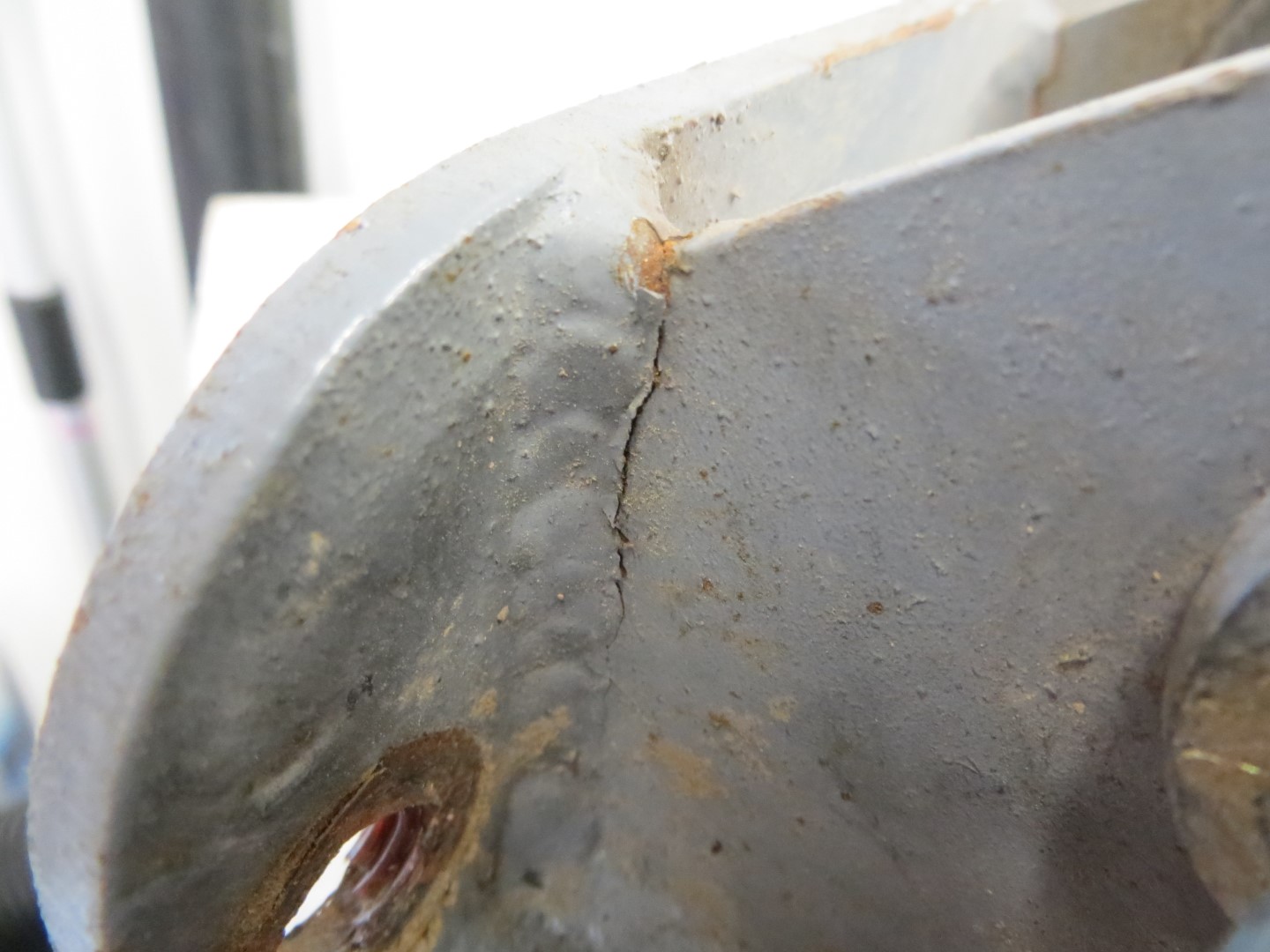

More strange that a stock 351 could start to crack their nice motor mounts.

Looks like OE style David, but that little bit of more movement than urethane shouldn't be enough to crack those.
But it does say so on the website.
Maybe I'll just strip them and weld 'em back up. Then use the trans mount to go with them.

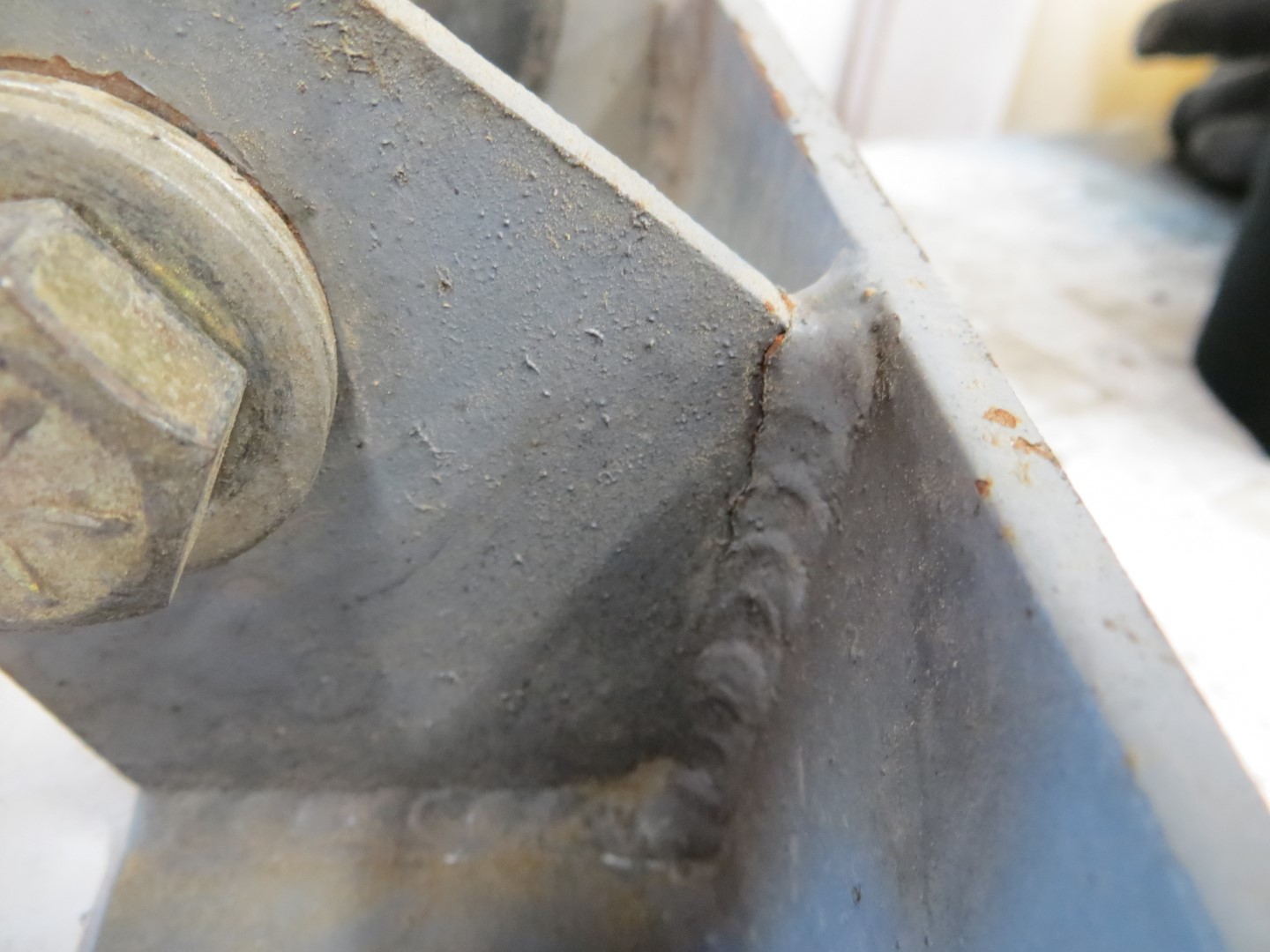

Hate to be the ass but the AF welder needs to learn how to actually weld—trigger welding heavier material isn’t the best 1/8” is about max.

I bought the Autofab full motor mounts last year and they were definitely trigger welded. It made me scratch my head, but I figured they are the ones with the experience. Now I'm a little nervous.

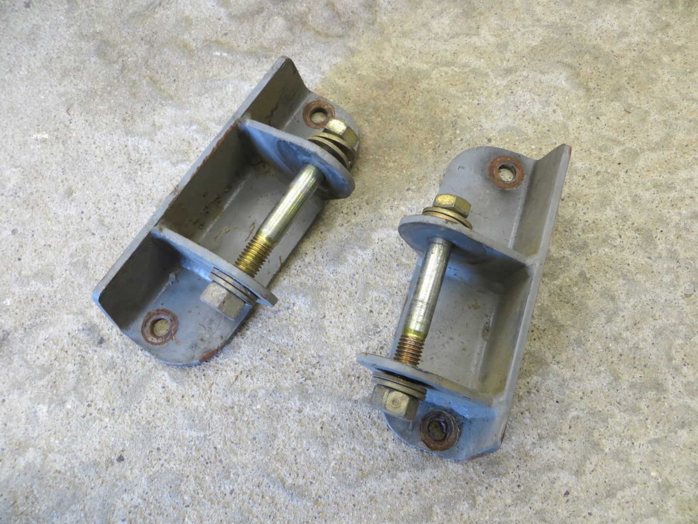

That kind of bracket is all too common to see, but it isn't good design practice to bend the tab(s) with bolt tension. Doing so usually results in cracks like that. Some, usually by more accident than design, make the tabs so that the sleeve is a tight fit between them. Which makes it a royal PITA to assemble/disassemble and someone, sometime will stick a pry-bar in there to assemble or disassemble it, or both! Which promotes cracking the tabs....
Much better is when the sleeve thru the bushings butts against one of the tabs, but extends thru a reamed hole in the other tab by enough that the bolt can't go to zero on the tab with the reamed hole. That puts all of the translational loading on only one tab, so either that has to be dealt with elsewhere (like using the correct trans mount) or the fixed tab (as opposed to the sleeved tab) needs to be designed and built to handle those translational loads.
Strongly recommended reading: https://www.amazon.com/Engineer-Win-Car ... 011MBDQOM/

And I'm saying that it isn't the fault of the welder or the mfg. It is the fault of the basic design. Most of the time it works, but once in a while it doesn't. This looks like one of those times. The basic design that I posted above originates in pre WWII aircraft where a failure like that is far less tolerable.

Those mounts see a lot of back and forth loading. Your floating design would put all that load on 1 tab instead of 2. Some corner gussets would have gone a long way to fixing that issue.ntsqd wrote: ↑Fri Jul 03, 2020 6:50 amAnd I'm saying that it isn't the fault of the welder or the mfg. It is the fault of the basic design. Most of the time it works, but once in a while it doesn't. This looks like one of those times. The basic design that I posted above originates in pre WWII aircraft where a failure like that is far less tolerable.
For the 8 truck with the motor plate, I actually removed the rear tabs so that the motor would slide in with the mounts on. I did double up the front tabs and put on corner gussets though.

They're there, just not very visible with the sectioning. Note the difference between the top surface of the right tab vs. the top of the left tab.BDKW1 wrote: ↑Fri Jul 03, 2020 1:13 pmThose mounts see a lot of back and forth loading. Your floating design would put all that load on 1 tab instead of 2. Some corner gussets would have gone a long way to fixing that issue.ntsqd wrote: ↑Fri Jul 03, 2020 6:50 amAnd I'm saying that it isn't the fault of the welder or the mfg. It is the fault of the basic design. Most of the time it works, but once in a while it doesn't. This looks like one of those times. The basic design that I posted above originates in pre WWII aircraft where a failure like that is far less tolerable.
