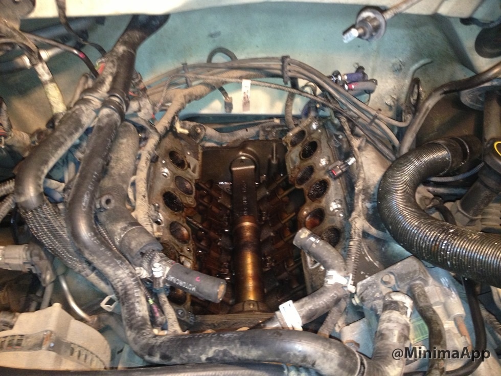

Still changing that lower intake gasket, got it tore down, installed and most of it reassembled. Terminating all plugs and hoses then on to the water pump. I'm hoping it will be good as new after.

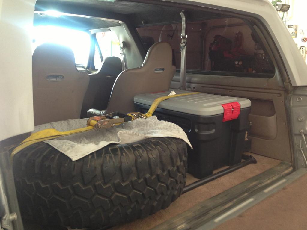

Finally picked up an action packer. Currently trying to figure out more storage.

I was noticing when working on this 4.2l v6 that there's a set of secondary intake ports. According to the book they open at 3k rpm and above. Drawing a comparison to the v-tech Honda head. For years I wondered why this truck literally had a power and like a 2 stroke. Does anyone know if the 351m has the same? I haven't felt it but I was just wondering.

I was looking at that picture and trying to figure out why there were so many ports on those heads. The 351M definitely does not have anything like this, one intake port and valve per cylinder. The two valve 5.4 has a valve that opens up another section of the intake manifold and effectively changes the intake port length. You can feel it when it kicks in. Lots of tricks since the Honda thing that they have been doing since back in the 70's.Rmc wrote:I was noticing when working on this 4.2l v6 that there's a set of secondary intake ports. According to the book they open at 3k rpm and above. Drawing a comparison to the v-tech Honda head. For years I wondered why this truck literally had a power and like a 2 stroke. Does anyone know if the 351m has the same? I haven't felt it but I was just wondering.

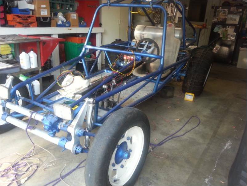

Wiring a friends Buggy... it's been sitting for many, many years... the wiring was an absolute rat's nest.

Was supposed to say power band like a 2 stroke sry about that.Rmc wrote:I was noticing when working on this 4.2l v6 that there's a set of secondary intake ports. According to the book they open at 3k rpm and above. Drawing a comparison to the v-tech Honda head. For years I wondered why this truck literally had a power and like a 2 stroke. Does anyone know if the 351m has the same? I haven't felt it but I was just wondering.
