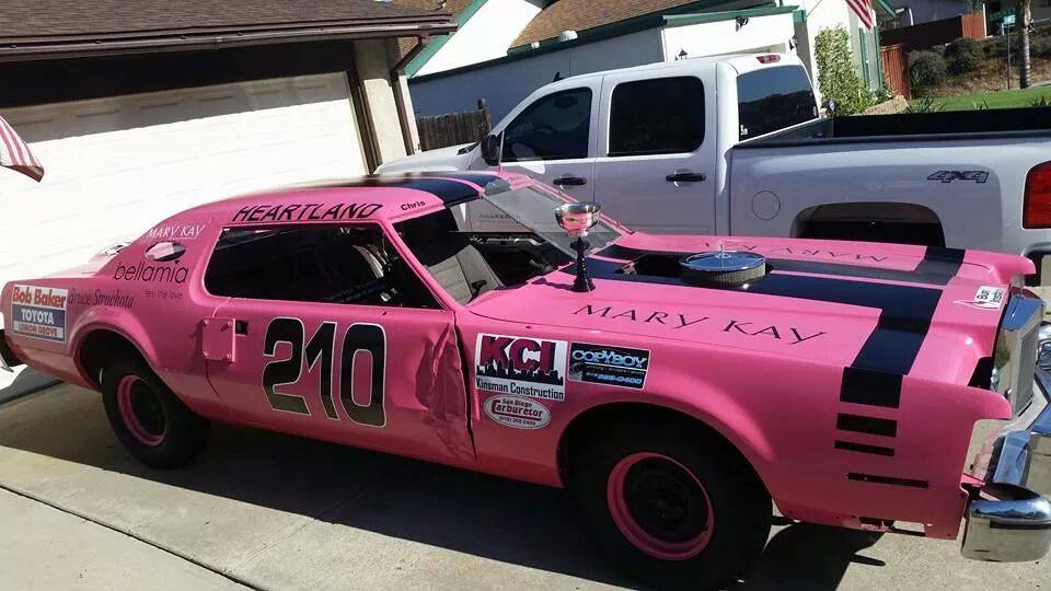

We won best in show at BNS Brewery's pre-derby rally!
- 10384306_783237601699997_5966003832048815347_n.jpg (77.06 KiB) Viewed 2203 times
- Posts: 6028
Re: Firefighter Demolition Derby!
She looks ready to smash. Ask your Mary Kay rep when it's all smashed up if her make up can make it look new again, surely she has a miracle consealer.
