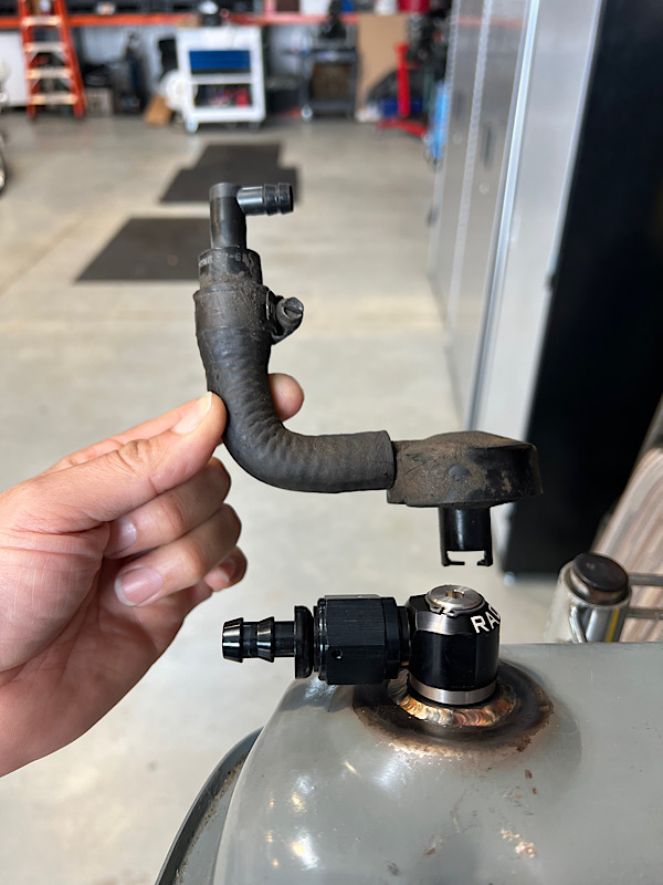

The internal baffling and the stock plastic elbow got in the way of the new roller rockers that were necessary with the AFR heads… had a threaded bung added to the valve cover, installed a Radium low-profile banjo-style fitting and trimmed the stock PCV hose to fit… turned out great!
Thanks to Kritter for the help!

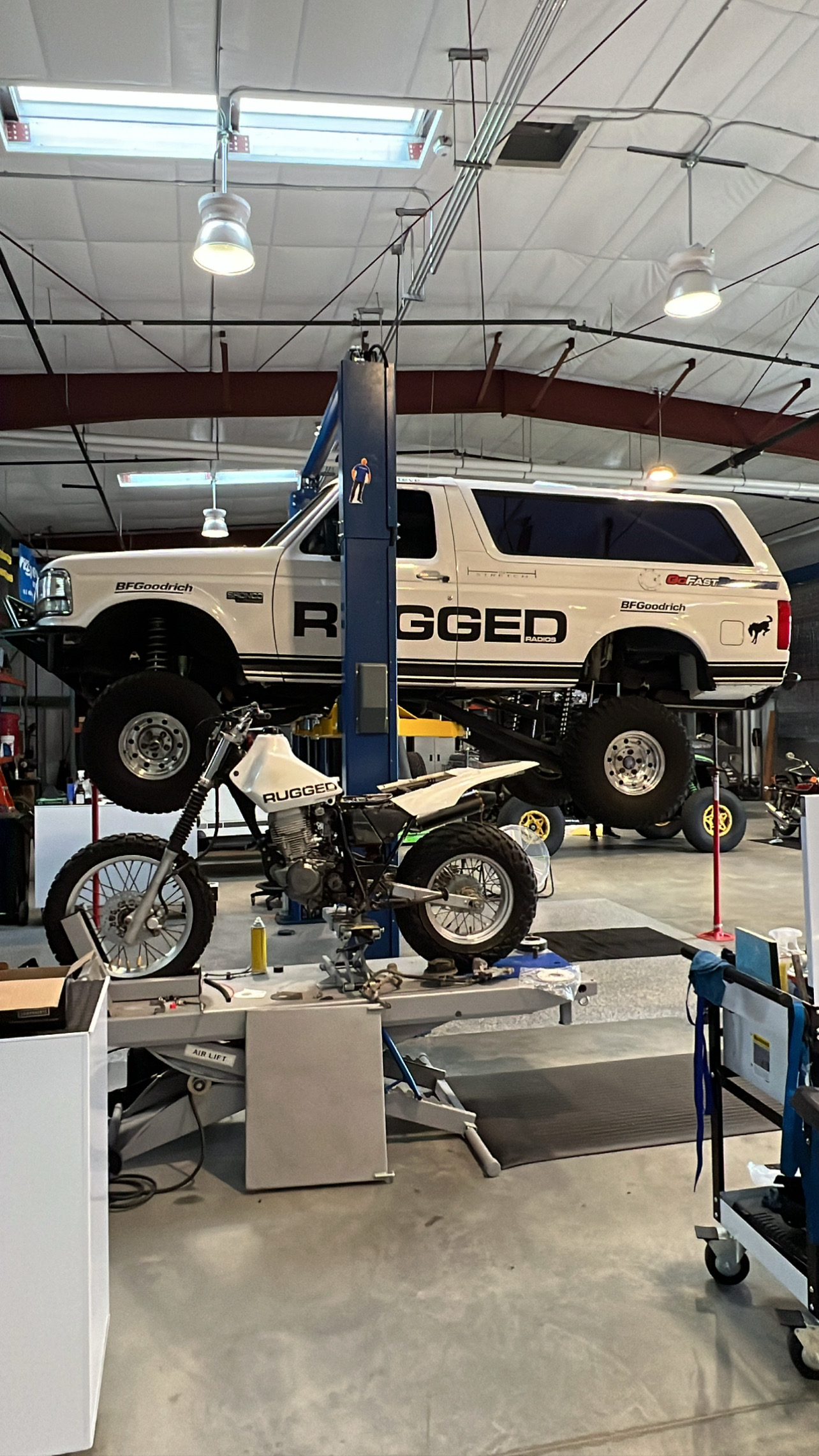

Pinion seal replacement (had someone else do it😉) and oil change before driving to Barstow to pit for he CA 300.
Wilson's looking good! The tw ain't bad either.

It is! The valve cover mod above made a HUGE difference. The car was sucking lots of oil through the PCV system post AFR heads and required PCV mods. In this condition, I wasn’t super excited about driving it long distances, but the pull to Barstow from here has a lot of long hills and was a great test. The engine is still tired, but that round tip resulted in an a few tablespoons of oil pushed into the catch can… I’ll take it!
Still need a roller 5.8L long block to rebuild, though….
