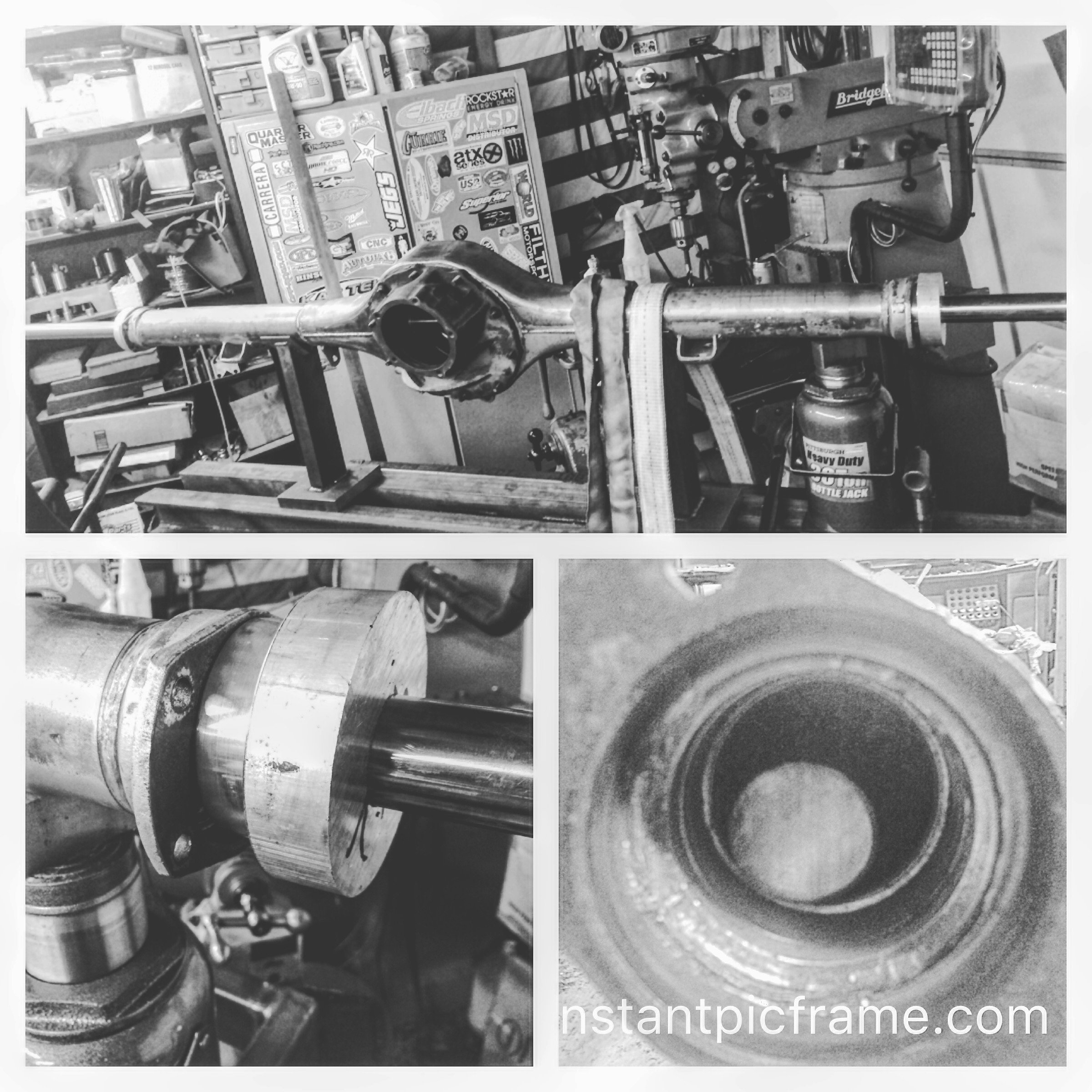

From so bent I couldn't get a bar through to straight as an arrow. Ready to go on the truss fixture.

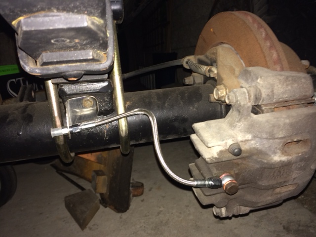

Workin on trying to maximize my minimal free time and be productive. Picking away one tiny step at a time
photo 3.JPG (121.52 KiB) Viewed 49166 times
photo 2.JPG (139.82 KiB) Viewed 49166 times
photo 1.JPG (114.23 KiB) Viewed 49166 times
I may be interested in the WR when it's ready. Pm me the details
ChaseTruck754 wrote:Workin on trying to maximize my minimal free time and be productive. Picking away one tiny step at a time
What calipers are you running there?
Those are stock. The entire axle is a Sterling 10.5 out of a '99 Superdookie. I just had the hubs re-drilled & changed the lug pattern from the metric crap on the superdookies and then narrowed up the spring perches for the narrow frame in the old ford.
Rad Steve, good to see you working on it again!
Yeah, it's only been 7 months or so... ugh! Amazing how time just flies by and then all of a sudden it's been ages since you've touched anything!
I've been thinking about it a lot, and either hadn't had the time to get to it, or was just too tired to get up & on it as much of the time my work hours for this seem to be between 10 PM & 1 AM or so. I couldn't let you win the race for the longest project ever though, so when I saw you moving again I knew I had to! Thanks for the inspiration.

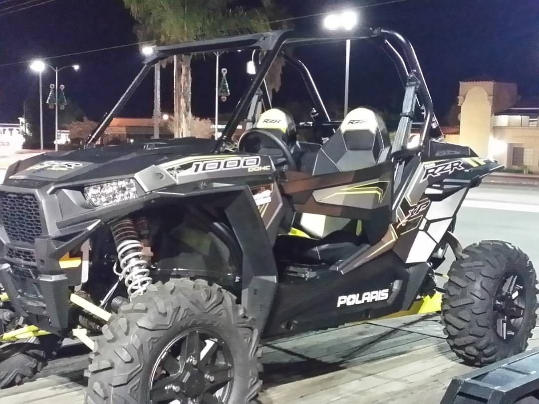

Just over a week ago I decided I wanted to go to the desert for Turkey day so I called Travis Coyne and picked this thing up from Coyne Powersports and thrashed with help from some great friends and sponsors (Black rhino, Method race wheels, PCI Race radios, Coyne Powersports) got it dialed in and enjoyed Glamis for the weekend. Next up some Fox shocks and our in house designed suspension and powdercoat and it will be done.
