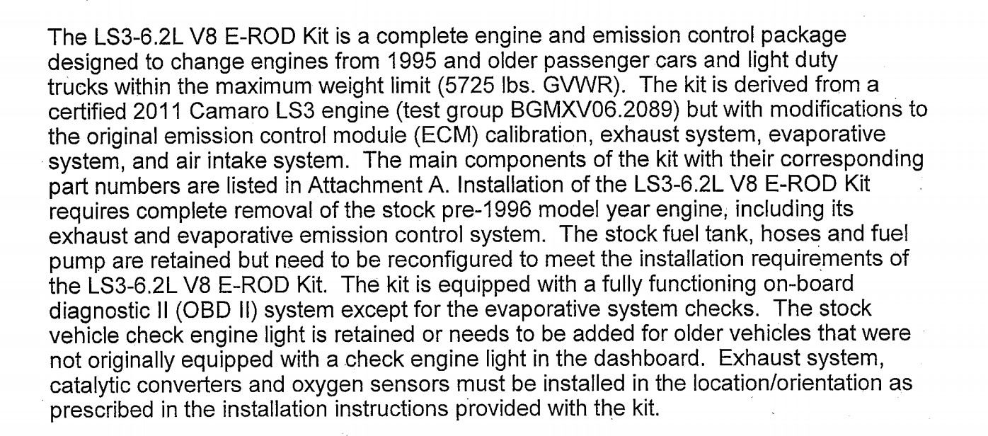

there are plenty of ways around the emission side of things, but they take time and not every paper pusher is aware of the rules, which means arguing and taking up more of my time. if FORD offered an engine swap kit with the CARB EO then there is no argument. meet the requirements, get sticker, be on my merry way. gm had a CARB legal 5.3 for GVWR up to 7200lbs but discontinued it. the current selction of ERODs are only good for up to a GVWR of 5700lbs.

Random, but it seems you have some knowledge here, so I'll ask. Do you know what GVRW the LS3 Erod chevy motor is good to? This whole motor having to be same class or GVRW thing is frustrating. I used to know the smog rules, but everything has changed so much in the last 15+ years. When I put the supercharged 3.8L Ford in my ranger back in 2001 or so none of this same vehicle class BS existed. I'd now love to shove a 5.3L LS in a 1st gen exploder but I don't think I can.
And yes, as you mention the work of trying to work through/around the alternate registration procedures are annoying and super time consuming. As it was when I tried to smog my ranger I'd get sent to a BAR referee just for a basic, annual smog as none of the regular smog guys wanted to touch it with the CARB sticker on it. Sounds like some of that fear of the CARB sticker is going away, but maybe not enough.

Thank you! I thought the EROD was good, but hadn't found confirming info yet. I really want a cheap swap, meaning a junkyard LS series I swap in, but it seems like that's a no go from what I've been reading due to it not coming in a light enough vehicle that is comparable to the 1st gen exploder. Found something on the EROD and it seemed good - so thanks for verifying that. Now just to get over the sticker shock of the thing lol...

ChaseTruck754 wrote: ↑
Wed Dec 02, 2020 3:19 pm
if you wanted to try the junkyard angle, h3 alpha and trailblazer SS might be the ticket.
Re: ford CARB legal crate motor
Awesome - thanks. I was racking my brain trying to think what would have come with a v8 in the smaller package. I Thought of the S-10 typhoon, but that's a truck. This while "same platform, same GVWR" BS kills a lot of the fun.
