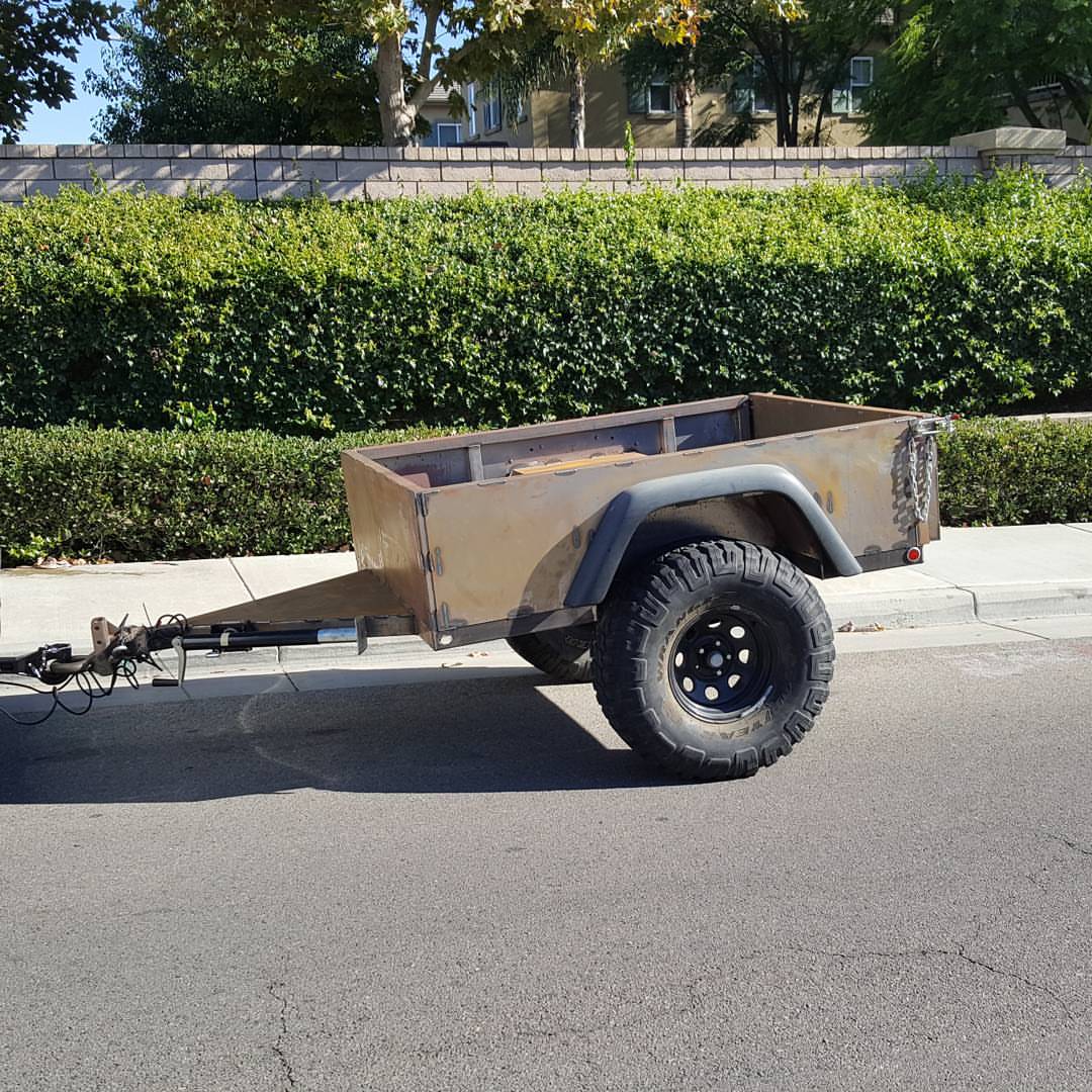

Here is a trailer I picked up last Friday. I will use this for our Big bear trip this weekend and our Baja 1000 trip then probably unload it. I never thought I would see the day where the bronco would tow a trailer.

Oh how the once mighty bronco has fallen. What is next? Will we see it running around with a Domino's sign on top of it delivering pizzas? Just joking. Little trailer is cool as hell. I would place money that you hold on to it after using it for a couple of trips. It may slow you down though.

Looks pretty cool. Is it a home made trailer?

damon1272 wrote:Oh how the once mighty bronco has fallen. What is next? Will we see it running around with a Domino's sign on top of it delivering pizzas? Just joking. Little trailer is cool as hell. I would place money that you hold on to it after using it for a couple of trips. It may slow you down though.
I bought this trailer strictly to modify and see what is nice to have and what is a must have. We are currently designing a set up to manufacture that is why this will probably find a new home after the 1000. I only tent camp in the summers my winter camping I take the toy house. If the bronco starts delivering pizzas its cause some pizza boy came and offered the right amount of money lol. I'm more the hands on guy so maybe a landscape trailer or back to my roots of detailing if all hell breaks loose and every business I am involved with folds up. lol.

Tchajagos wrote:Looks pretty cool. Is it a home made trailer?
Its a combination of 2 buddies building and a fab shop buttoning up. its a nice little well built trailer

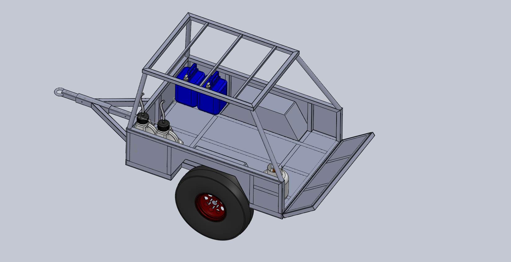

Ended up grabbing a rear axle out of a Dodge Grand Caravan from the pick a part for like $50. It's going to work great!

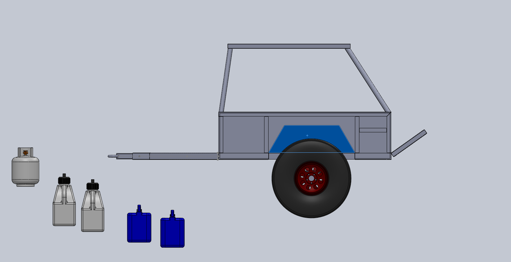

This is the plan for it.
I stripped off the drum brake parts and it looks pretty heavy duty. 5x4.5 lug pattern so I can easily find adapter for 5x5.5. Has a sway bar and a panhard bar which I'm not sure if I will keep or not. I will be flipping the axle over and using maybe leaf springs off a ranger.

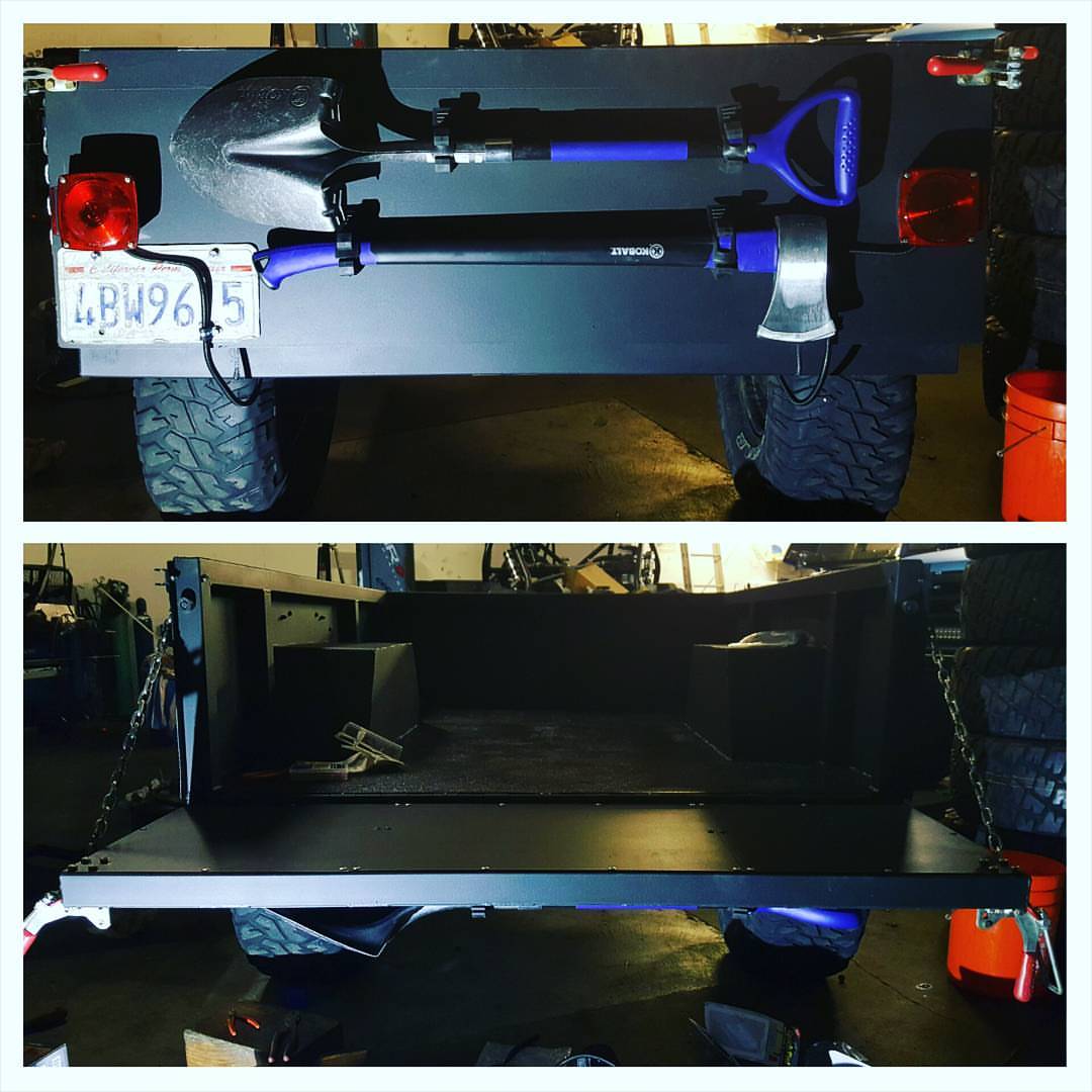

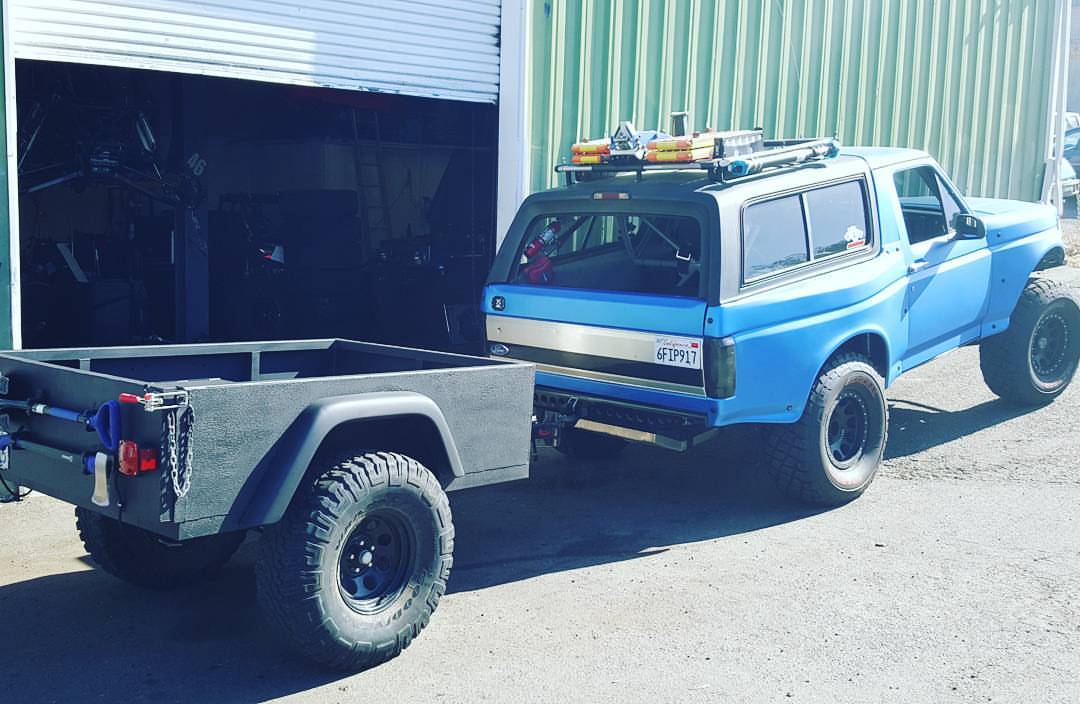

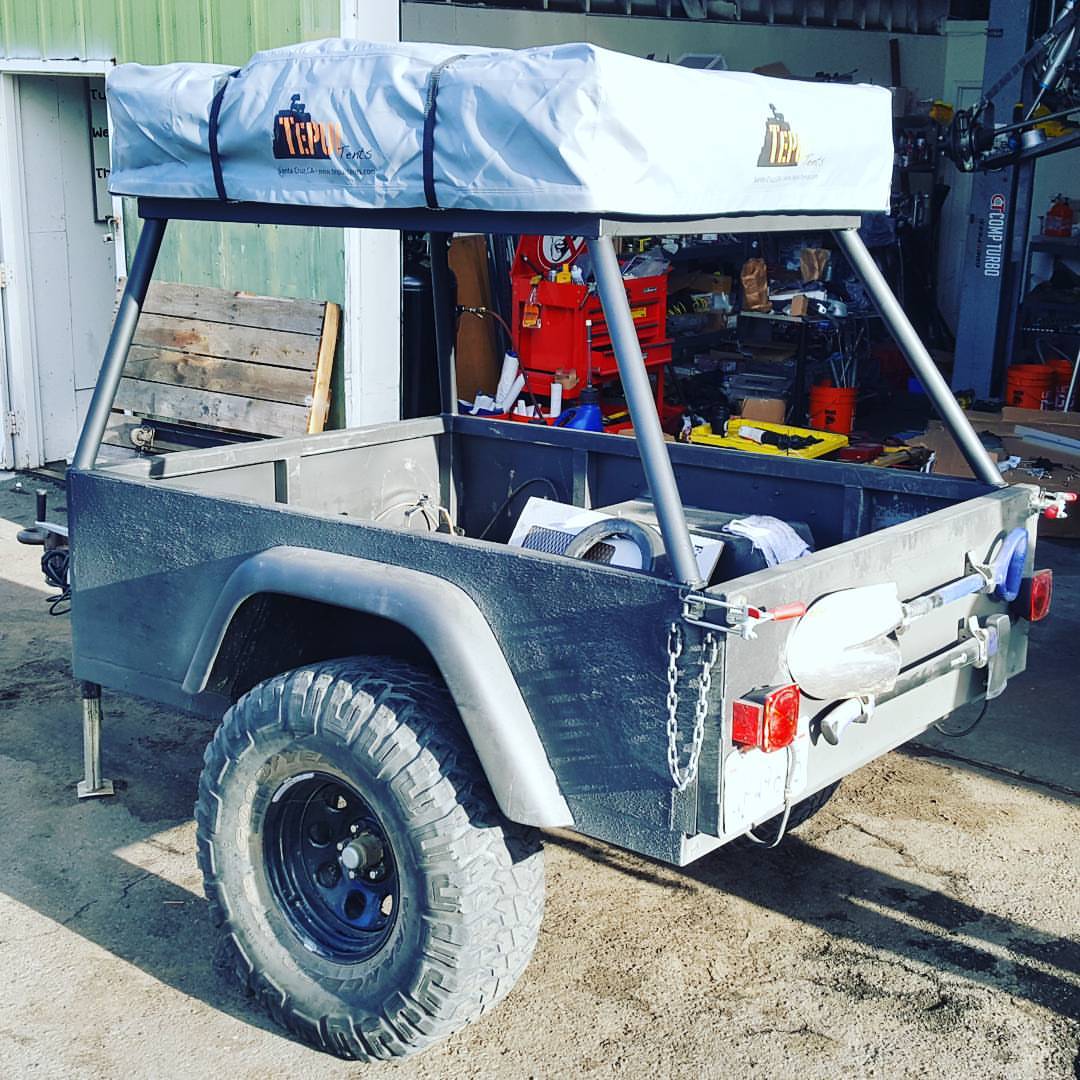

So after tossing it around for a long time and a few different revisions a close friend and I decided lets go for it and manufacture adventure off road trailers. So we founded Adios overland trailers. Our current design is a lower priced unit just to get the ball rolling. We have 2 other designs in the works but this will do for now. These are perfect for hauling camp gear and coolers behind our broncos. This design allows for a 37" tire to be run on the trailer as well so you can run same wheel and tires as your broncos.
