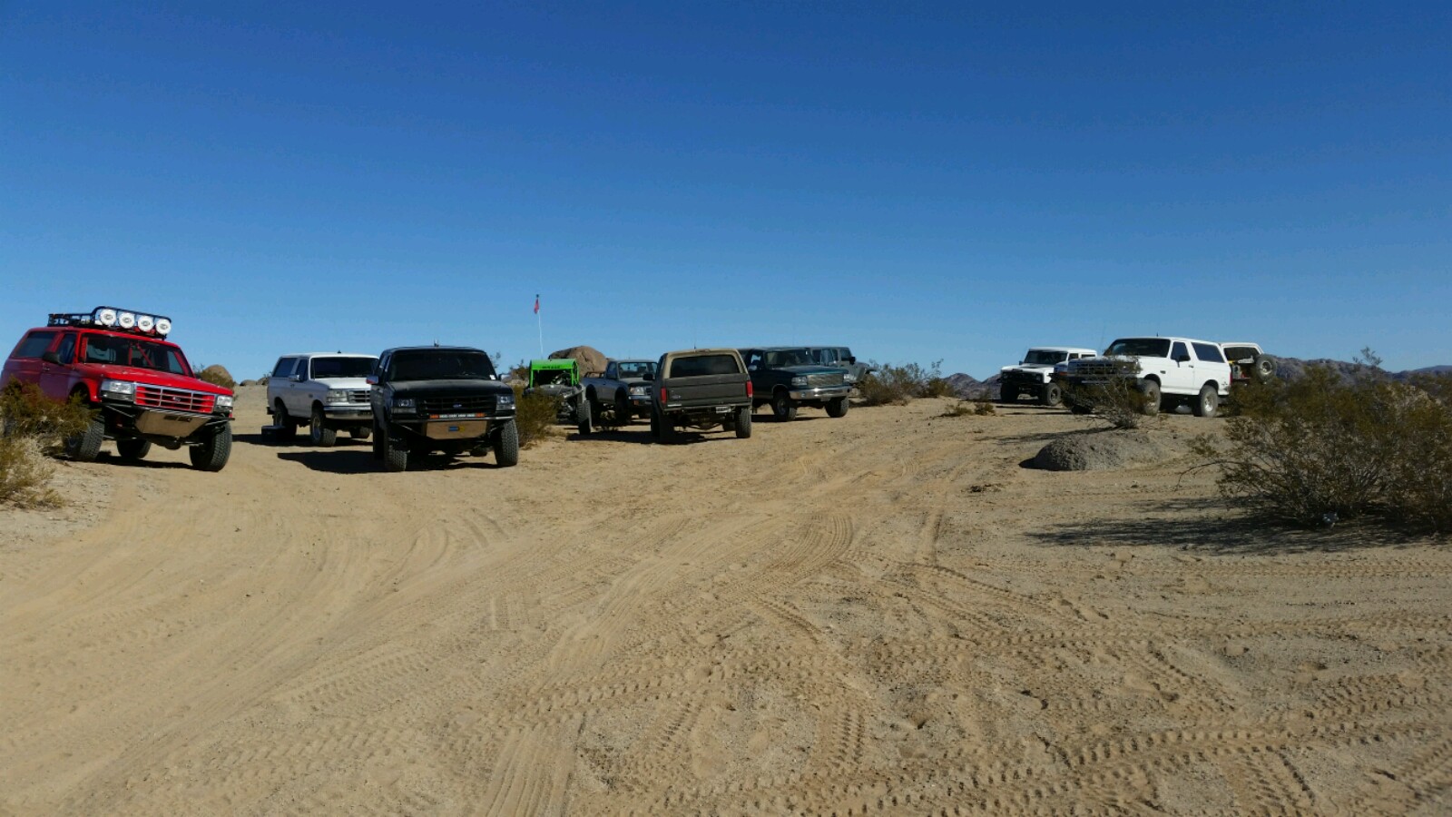

Spotted a herd of Broncos this morning at race marker 69.5. I had a great time meeting everyone. A big thank you to Nick for some loner tools and some zip ties when I needed to secure stuff down.
There's a bunch of pics and video, terrestrial and drone on fb...if you are on find us so we can tag everyone
