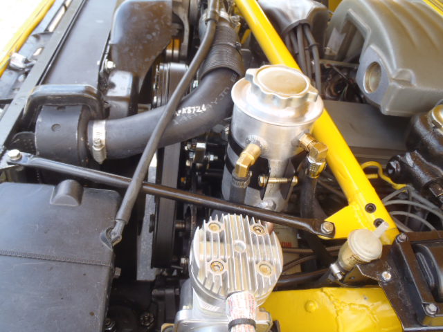

Update
* Gauge pod final. Now for the wires. Pod is flat black
* Ram is done and steering on the highway is much improved. Modified Sag PS pump low BCB mount with res. Low mount needs AC delete pulley or AC compressor so I have a cheap AC compressor. Ram parts & modified pump & 4x4x2 box done by West Texas (Red Ram). Install by Drew at BC Fab.

Looks like first class work, Paul. We'll done.
I used an in-line radiator cap like yours on my v8 Ranger (bed mounted radiator) years ago. It alleviated my cooling system filling dilemmas.
Re: PaulW's 72
= ====SteveG wrote:Looks like first class work, Paul. We'll done.
Thanks. Represent lots of fiddling.
After a couple of times draining and filling the coolant I added that high point filler and a quick drain on the crossover pipe under the radiator. Yup the radiator comes out for work on the front of the motor.
The full size cars of the day had a nice recovery tank mounted up high. No way it will fit on my rig so the next best is the high filler cap. The trucks of the day had no such thing and recovery bottle and motor bleed had to be added.
Did I say tight?
The hydroboost/master comes out when plugs have to be changed. Sigh.
Underneath is also tight with a non stock tranny and headers. Never ending hassle.
Looks like the BCB AC requires the top of the motor to come off to get to an easy place on he firewall?.
