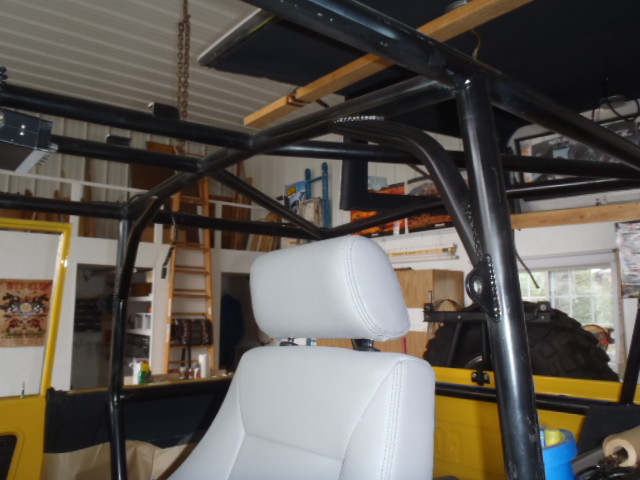

Decision made to trash the old carpet and stock seats. I will research that stuff and buy & install next spring after Jeep Safari. New modern seats require a cage mod so I have some fab to do. The Ex Avalanch fab guy will add the new gusset at the B pillar after I cut out the old ones that interfere with the seats.

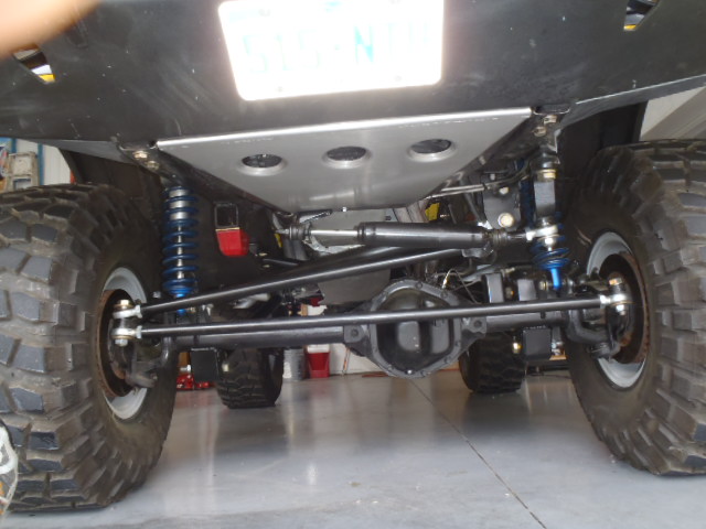

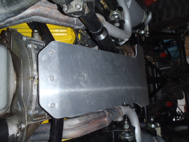

Latest mods are skid, front Al beauty plate, and "B" brace change to fit the new seats

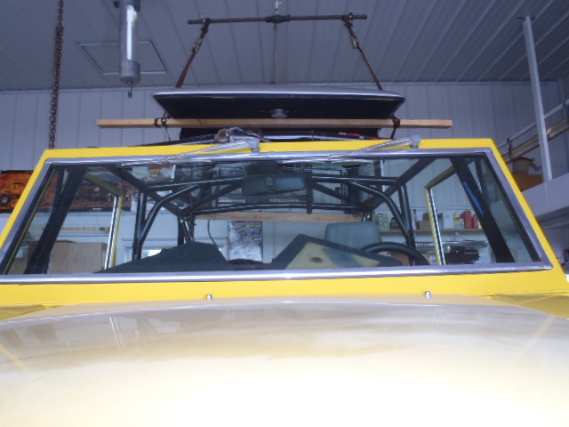

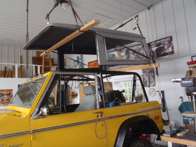

Top removal

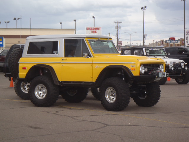

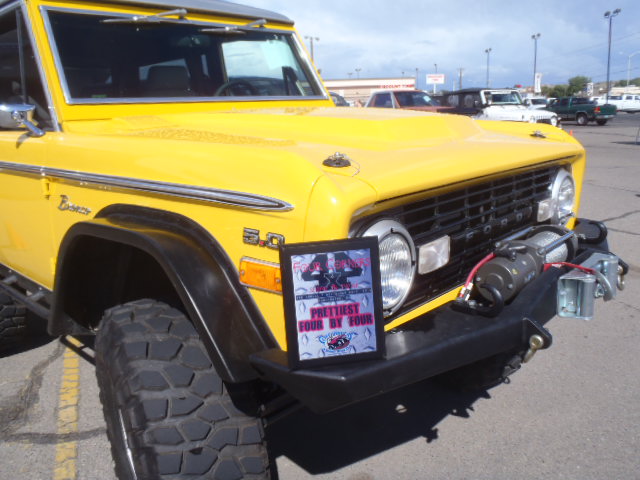

4x4 Swap & Show in Farmington NM
Award for prettiest 4x4
Big surprise because there were so many Jeeps that were all blinged out

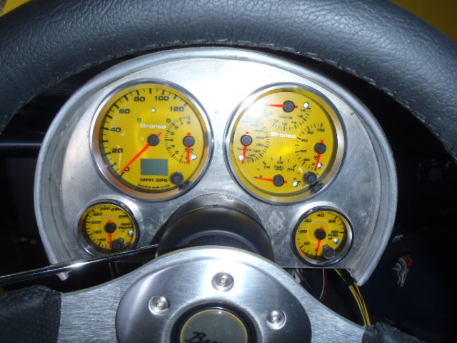

The gauges fit my custom dash and the whole thing fits behind the steering wheel.
This is the first time I have not had to do three tries to get a custom project correct.
The pod still needs cosmetic attention and wiring will be interesting even with my electrical experience. I am sure there will be a long effort.

SteveG wrote:Damn, Paul. That looks really good!
Thanks,
Its amazing what the gauge people are doing these days. I think the demand is from the hot rod/street rod guys. All the gauges are smart gauges and programmable.
Took them 2 weeks to make them. Speedhut.com
More to come when I redesign the rest of the dash and get rid of the ancient stuff.

Gauge cluster looks awesome!
PaulW
Posts: 1599
Re: PaulW's 72
Post by PaulW »
PBR wrote:Gauge cluster looks awesome!
Thanks, Been studying how to for quite a while.

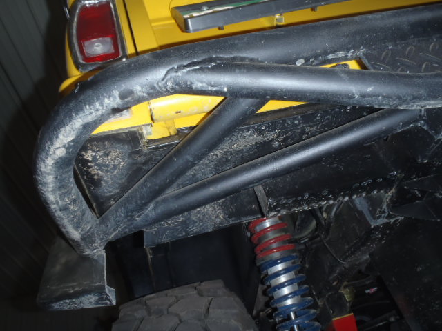

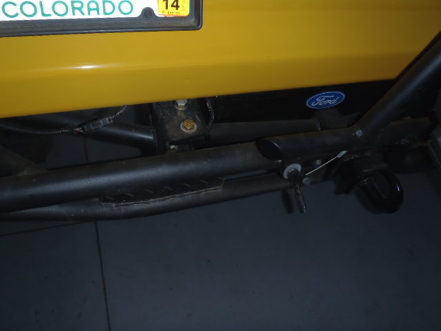

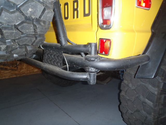

Nice looking rig!!! Love that rear bumper - not seen any "single" bar with the tire carrier! Got any more pics? Did you fab it up or purchase?
PaulW
Posts: 1599
Re: PaulW's 72
Post by PaulW »

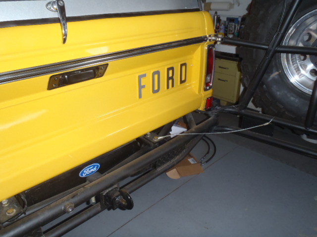

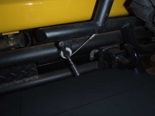

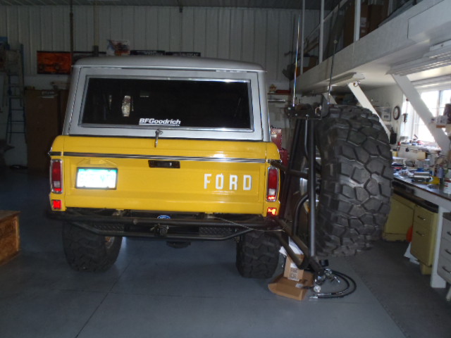

FlogginHarvey wrote:Nice looking rig!!! Love that rear bumper - not seen any "single" bar with the tire carrier! Got any more pics? Did you fab it up or purchase?
PO had the bumper custom made with tire carrier. An ok design and it mates with the frame properly. It has an unusual bearing at the pivot and no way to take apart or lube. There are actually 3 tubes and the two hidden ones connect to the outer end of the bumper on each side. It was pretty floppy and did not pass my shake test when I got it. So - I had the fab shop put a link from the RR cage tube to the upper corner. Now it works fine. I added an 1/8" tether like I do an all my rigs. The setup uses a bolt with wings to attach the carrier to the bumper and I just added a tether for it. Note that the fenders are bobbed.
