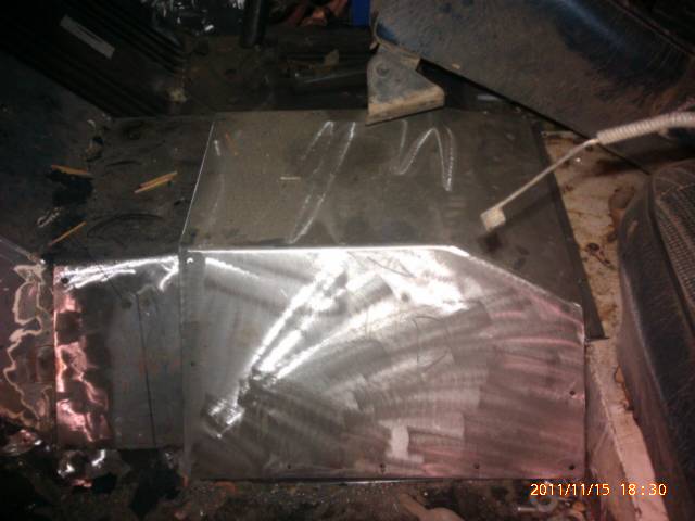

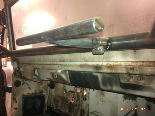

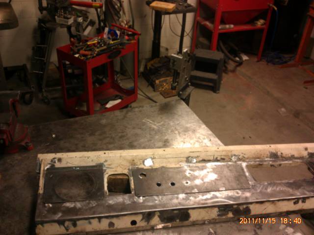

Here are some pics of my half cab that I am building in the "prerunner" theme...

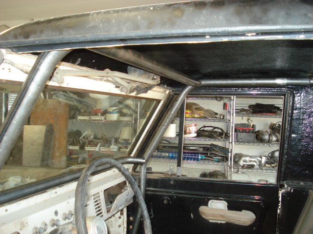

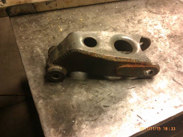

more.....

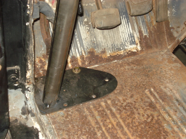

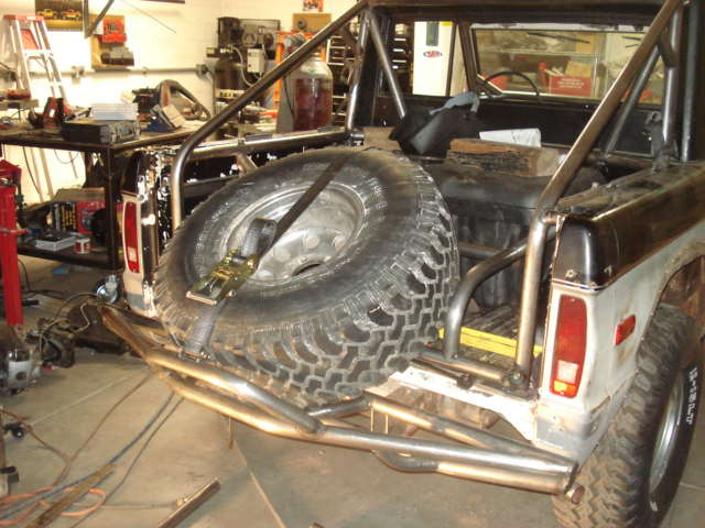

More pics ......

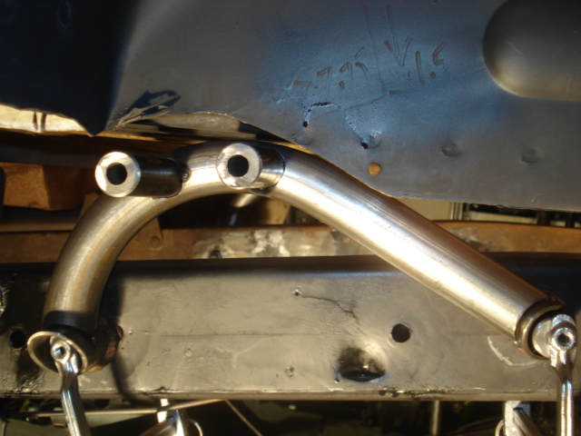

Cool build!!! I like the front shock hoops. Simple and effective. Is there something to keep them from rocking in and out?

Because the mounts are on so completely different planes they don't rock at all. I know they look like they might they don't.

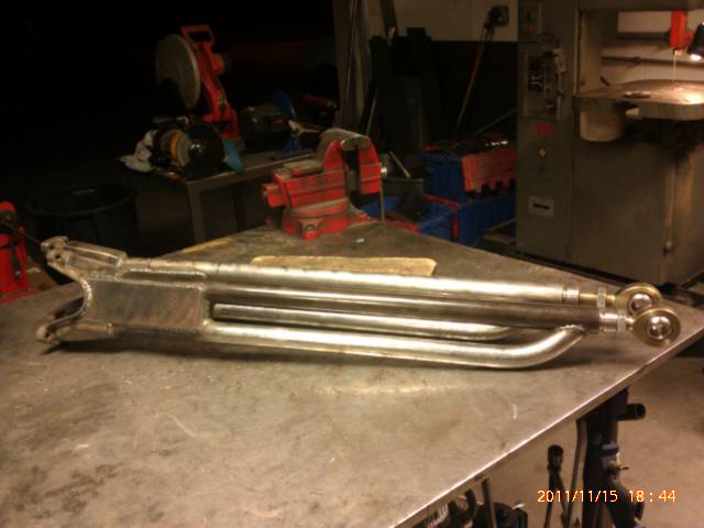

My extended radius arms...
Radiator support...
Extended shackles..
