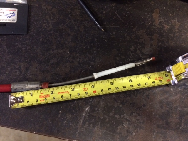

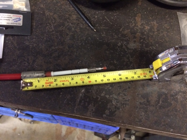

Ok, so this is worse than I thought. Here's pics of the ends of my cable (36" overall = shortest morse cable I was able to find), and you will see that even with trying to loop them 360* that the things would not physically fit.
