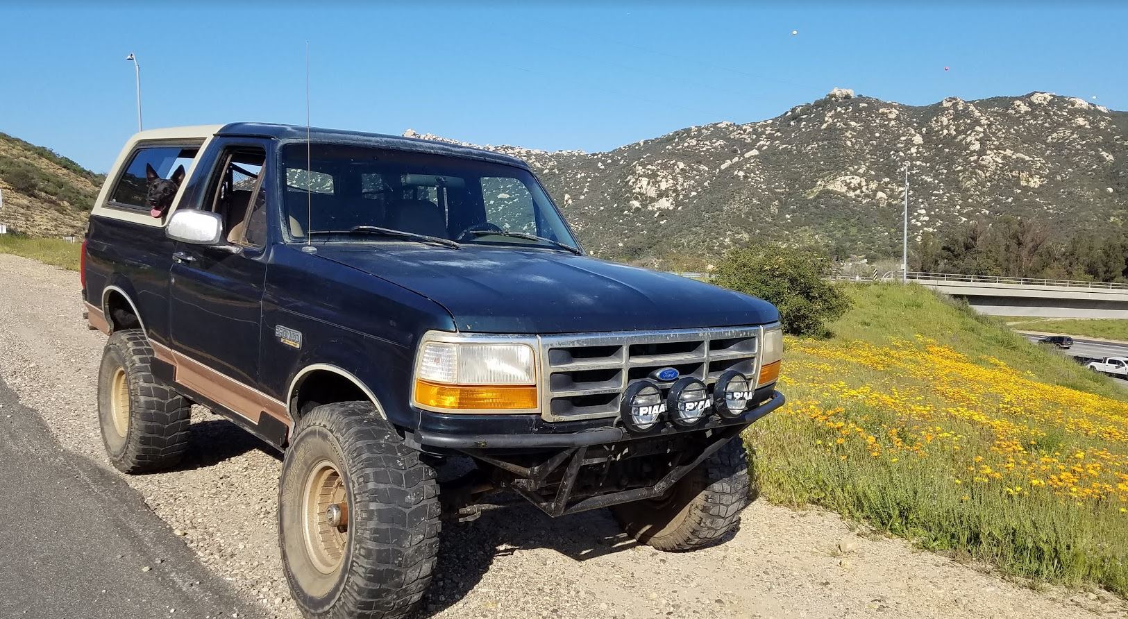

Starting Point:
1995 Eddie Bauer
5.8 Lighting bottom end, arp heads, crane customer ground cam, JBA shortly headers, Dynomax catback
4.56 front and rear. Air locker rear, manual locking hubs front
First upgrades:
Hollander Bumper
Stock Length TTB and one-piece radius arms, 3" kings
Solo Stage 3 rear suspension
Starting point
Bumper upgrade
front bumper.JPG (151.01 KiB) Viewed 3472 times

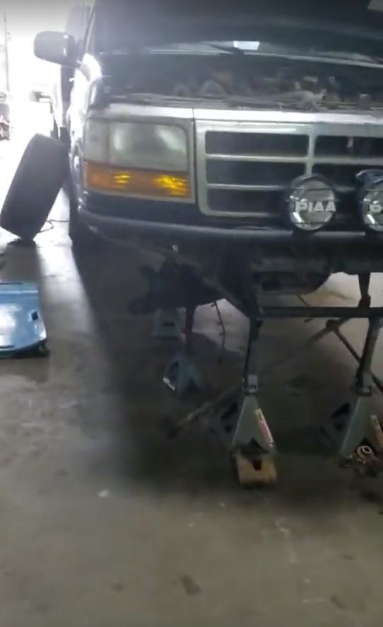

Hollander's shop for the frontend
Kings
Install Complete
Front and Rear Installed with a car alarm...:)

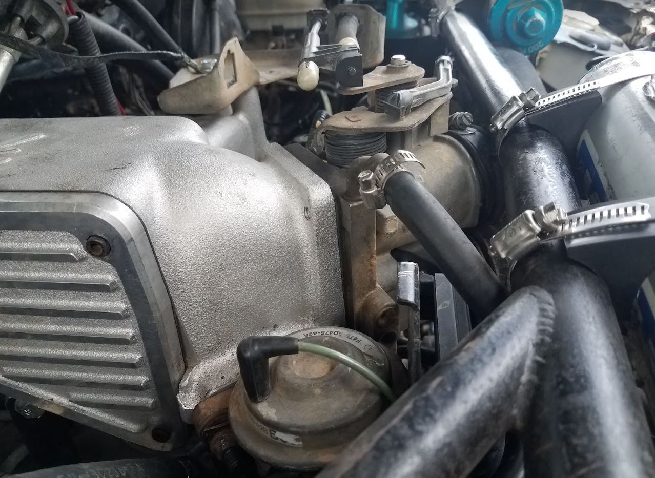

Picked up the Bronco today. Had some problems with the computer working with the injectors and mass air-meter as well as the throttle body clearing the cross brace. So, only the intake installed for now.
Did however install the new water pump. Then, we found the cause(s) of the water pump going out. Looks like there was an issue with the the smog pump somehow being slightly bent which started the cascade effect on the other pulleys. Additionally finally upgraded to a 130 amp alternator. After a bit of driving there is a difference, but I'd say pretty minor with the performer upper and lower. Although, that's not really a fair judgement since for the moment it still has the stock injectors, throttle body, and mass air meter back in it.
Tight fit

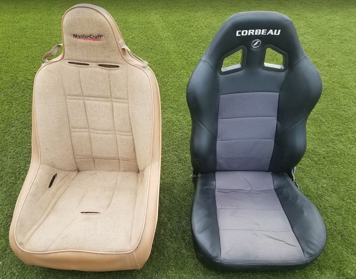

Now I have an important choice to make. What do you guys think, Mastecraft or Corbeau?

Re: Jason's 1995
jhj_08 wrote:Now I have an important choice to make. What do you guys think, Mastecraft or Corbeau?
I'd do mastercrafts again in a heartbeat!!

Post by jhj_08 »
They definitely feel nice to sit in.

Post by mustacheride »
x2 mastercrafts

Post by LvSteve »
Mastercrafts

Post by jhj_08 »
LvSteve wrote:Mastercrafts
Thanks guys, appreciate the feedback. Mastercraft it is...

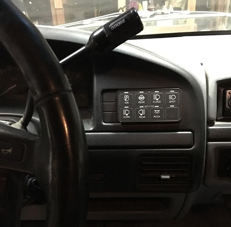

if you are talking about a switch panel for running lights/radio/accessories i will never use anything other than swtichpros again. no fuses, no relays and super easy to setup. its a little pricey but once you price out quality switches and what not it is a lot closer in price then you would think. https://store.switchpros.com/sp-9100-be ... -hardware/
Dang, these are super fancy! Thank you both of the recommendations. I had not considered a set up minus fuse and relays.

this was what really sold me on it ...

That would be nice for the guys with a manual 4x4 shifter.

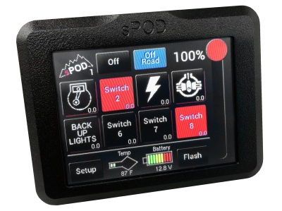

I am using an sPod SE with the touch screen. Lots of really cool features, and makes clean wiring a breeze.

i didnt go spod because of the distribution block. i wanted a single plug, for it to be sealed and compact which the spod takes up a lot of real estate.
