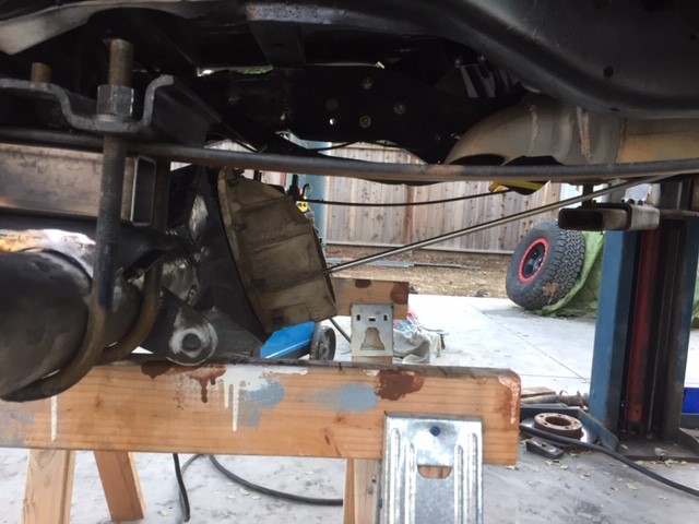

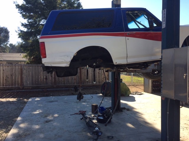

I then moved to the shackle side. Driver side came out no problem. Bushing sleeve looked a little rusty but it cleaned up ok. Passenger side not so much. The bolt had seized to the bushing. Cut off wheel and sawsall took care of that and got it apart.

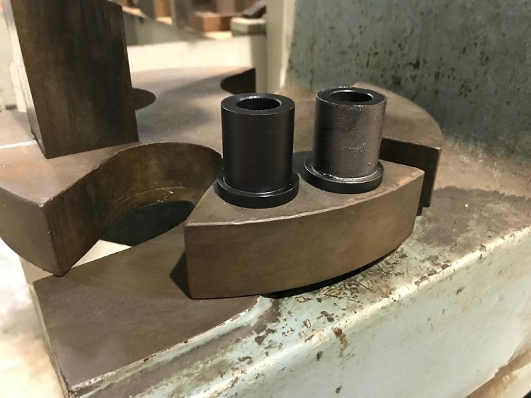

I made some new bushing sleeves and new delrin bushings. Assembled with heavy amounts of antiseize that is all over my shop now. The rear is tits now. No squeak and cycles smoother than before.

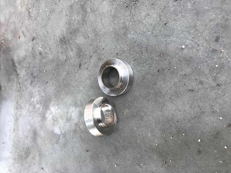

First issue: Rear suspension was super squeaky. PO used 1/4" washers to make up the difference from Q80 spring swap. I replaced with some spacers I machined.

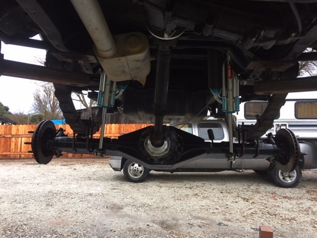

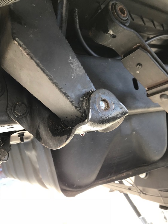

I had all last week off so I got a lot done and got it put back together.
List of upgrades:

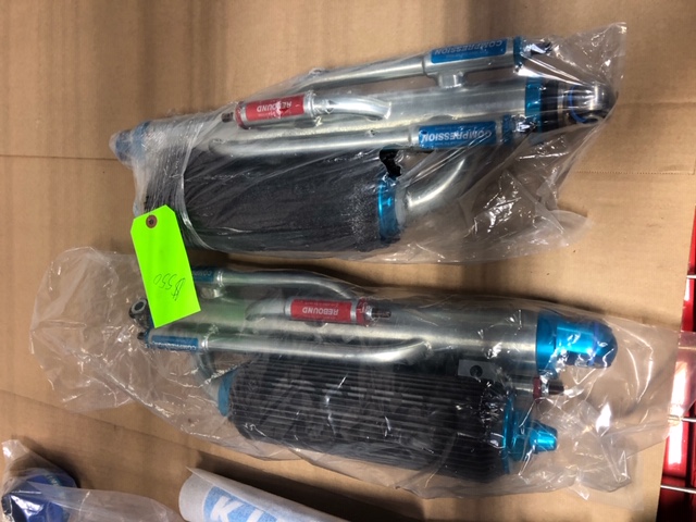

New Solo rear shock mount
New King bypasses
New Solo shackle hanger (I really bashed up the filler neck with the leaf springs in JV)
Plated the outside of the frame
Relocated bumps because of the shackle hanger drop
Corrected pinion angle
and a bunch of other minor upgrades not worth listing
Photo dump:
List of upgrades:
New King bypasses
Photo dump:

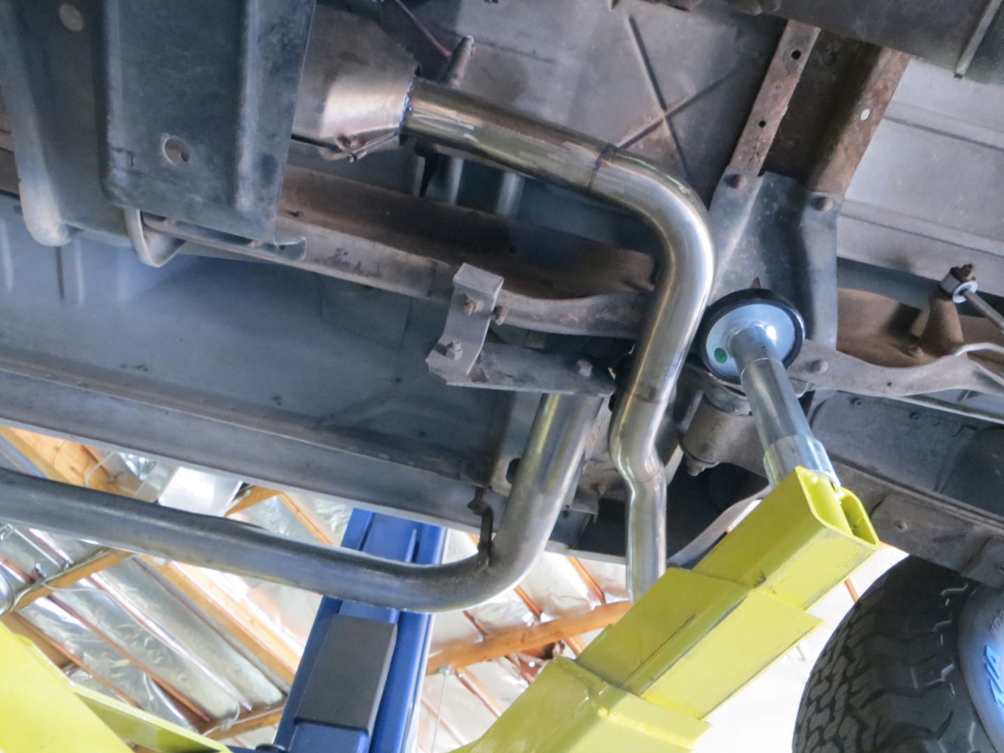

Don't take this as a criticism, but just a heads up. I used to dump the exhaust in the same spot that you've got it. Ended up with vapor lock problems on hot days. Most notably when the fuel level was below half and/or when running hard for extended periods of time.

No criticism taken, that's why I post up here. Someone is going to have previous issues that I have overseen.
Ya I had the same issue with my F150 a while back at WOT for too long. Nearly blew my gas cap off from so much pressure in the tank. So far, with the elbow rolled out to the passenger side, I haven't had any issues. It's also winter so we will see what the summer does.
I'm not real sure there's much other options. I'd have to tuck it right up against the floor to go over the axle and out the back beside the gas tank on the passenger side, but I'm not sure there is enough room at bump (second thought it looks like there is just looking at the pics) If it becomes an issue I'll have to investigate more into better routing.
Re: Bella the Bronco
I went through the frame. Worked out well. Used a flange and gasket on either side. No major increase in resonant harmonics. Never vapor locked after that.

If you're not running the Cats you can stop reading now. If you are, consider scrapping the muffler and turning out before the rear tire. I did this on our Street Bronco following the advice of some here and it works out very well. Never too loud, but makes a fun little roar if I mash it.
This Bronco has to stay with bolt-on parts for eventual resale, so I didn't go through the frame like Brian and others have done.
