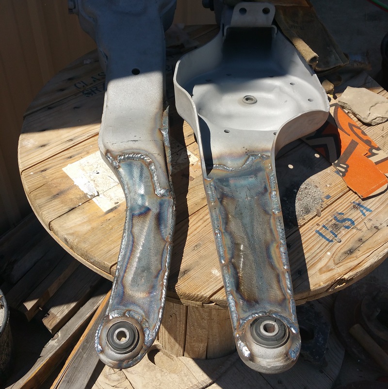

so i took off krustys front end, and started pulling apart the donor front end. the donor has these super weird one piece hubs that i guess ford decided to try in 1987 or so. looks like an overgrown explorer dana 35 hub. so i set those aside and reused krustys hubs, that i had just put new bearings and seals in.
i took krustys beams and got them sand blasted, then spent some time plating them after looking over the gofast front end thread. its not nearly as good as what im seeing on other builds, but its what i got. ill get better at this as i go.
beamplating welded.jpg (276.69 KiB) Viewed 5345 times
beam truss.jpg (248.97 KiB) Viewed 5345 times
beam pocket.jpg (265.55 KiB) Viewed 5345 times

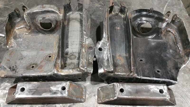

next up, i decided to try my hand at hacking up the nice new coil buckets to fit some f250 shock towers. i also built some bump stop extensions to keep from immediately wasting the 12" bilstein 7100s i am going to try using for right now. (coilovers down the road)
modified coil buckets.jpg (187.32 KiB) Viewed 5337 times

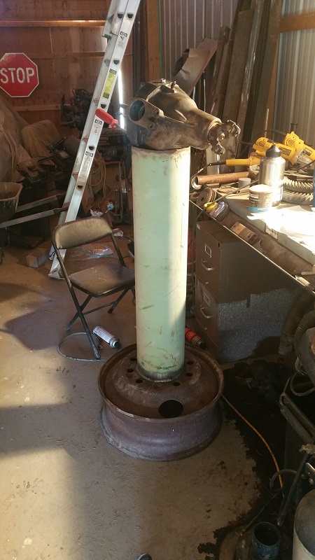

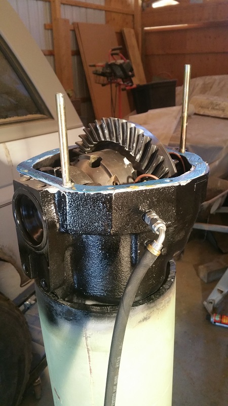

then i moved on to getting the diff done. the donor truck had previously had an arb in it, that the p.o. sold before i got the chassis. so i replaced it with another arb, which meant setting up the gears again. i built a little stand out of some 8" schedule 40 pipe and a semi truck rim. this was super handy.
pipe stand.jpg (133.39 KiB) Viewed 5337 times
arb diff.jpg (134.52 KiB) Viewed 5337 times

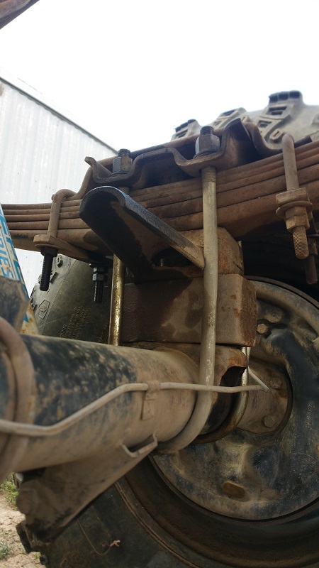

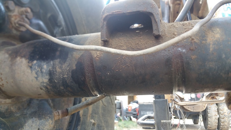

for the rear i went back to the donor f150 chassis and pulled the rear out of it. who ever had this f150 before i did definitely got some use out of it. it is equipped with 4.56 gears, and a detroit locker.
once i looked close i started to see signs of abuse, and some facepalm type jerry rigging. the original setup on the f150 was stock springs with some sort of after market overload setup, a 3 inch ford block on top of a 2 inch block. with 4 inch ubolts. pretty sure this was a sema build at somepoint. lol. if you look close you can see the 1/4" grooves that are worn in the tubes from the ubolts moving around. you can see where it dug into the block.
ubolt fail.jpg (121.28 KiB) Viewed 5285 times
i figured i can weld up the grooves and be ok for now. totally missing the warning signs. so i moved on to welding the diff to the tubes. i had my millermatic 35 set to kill, and zapped them in, after some work with a wire wheel, acetone, and a torch to preheat. it had plenty of blueing, so it seemed like the penetration was good, and i didnt get any cracks out of it. i let it cool with a welding blanket around it. when i wire wheeled it to get a good look at the weld the blueing seemed to go away. maybe im reading it wrong, but it seems ok. time will tell.
welded tubes.jpg (172.63 KiB) Viewed 5285 times
i was pretty proud of how the weld turned out, so i was excited to stab it under the bronco. and thats when i noticed it. the tube on the right was twisted in the housing already. not a lot, just enough to tweak the pass side block. the p.o. had goobered some weld on it to attempt to level it out, that i had completely missed in my excitement. Facepalm.
mangled perch.jpg (131.04 KiB) Viewed 5285 times
so i torched off the perches with my lincoln amateur hour torch, cleaned that up nice and waited for some new 3" perches from ruffstuff to come in. once those got here i ditched the 2inch block, and put the 3 inch in there with the bronco block. looked super sketchy. thought about taking off the bronco block, but id still have that 3 inch block in there, travel would suck, long term its not what i want, why do all that work for crap suspension, etc. and i talked my self into a set of deaver springs, from desolate motorsports, and a new 2.5inch axle swap kit from ruff stuff for the 8.8.
glorius deaver q80 springs.jpg (151.92 KiB) Viewed 5285 times

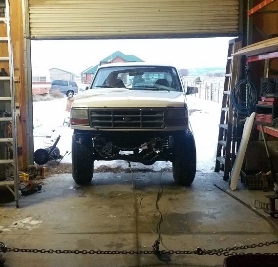

krusty got rolled out of the shop so i could make a few changes, got the lift in and started assembling it. should make things way easier. also working on getting the pallet racks organized a little better. so i can bring outside storage inside.
bringing in the lift.jpg (266.81 KiB) Viewed 5054 times
setting the posts.jpg (151.33 KiB) Viewed 5054 times

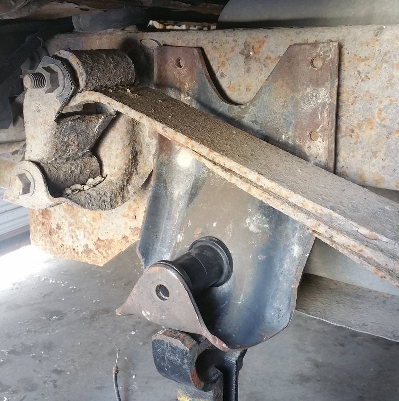

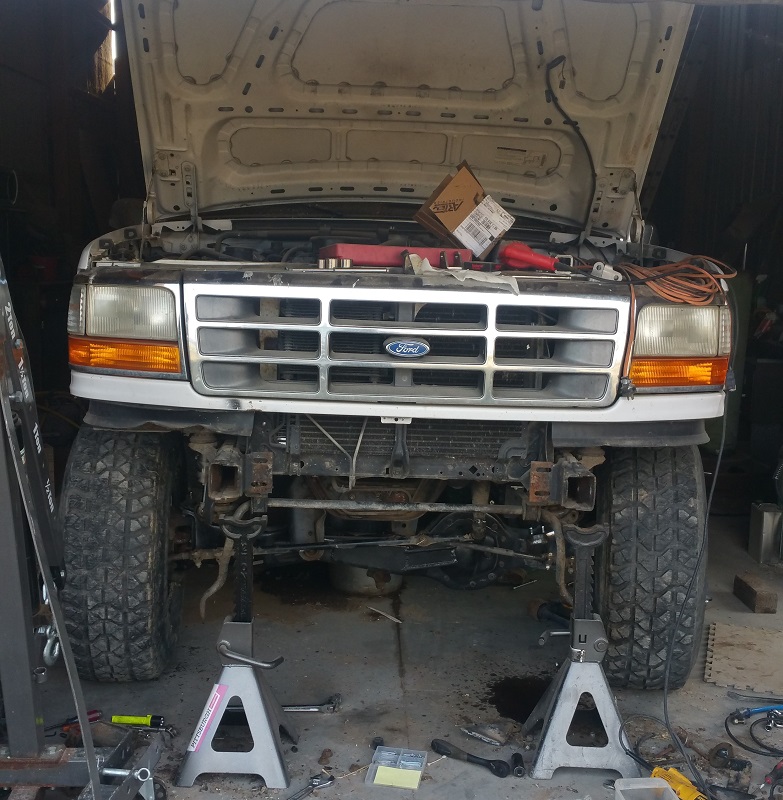

Got krusty back in the shop.
The two post lift isn't functional yet, that's going to have to wait till later. I want to get the rear suspension done. So I put together a to do list.
-remove rear axle
-remove gas tank
-cut off leaf spring mounts (torch)
-install new leaf spring mounts. (I'm going to use a set of chevy leaf spring hangers to install the Deaver springs. this way everything is 2.5" wide, and I don't have to use spacers. The chevy shackle hanger has 2" more drop than the bronco one does, which seems advantageous. I would like to use an 8" shackle, when its all said and done. I will most likely fab one up.)
-build and install shock mounts. I'm planning on using some cardboard aided design for this.
-install springs,
-position rear axle and perches. weld on perches.
-check shock mounts
-install rear axle brake lines,
-replace ujoint, install rear drive shaft.
at that point it should be drive able, unless I missed something.

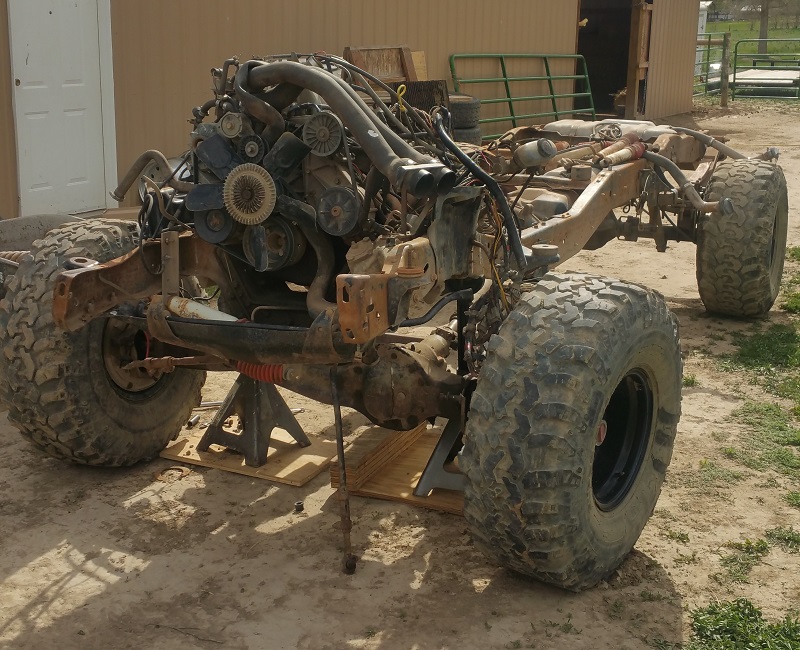

got the bronco on jack stands and started getting a plan together for the rear. I think I'm going to use these chevy shackle hangers that hang down a couple inches lower than the stock bronco shackles. That way I can squeeze a little longer shackle and maybe some more travel. From the reading I've done it looks like an 8-10" shackle should work good here. I am planning on reinforcing the bolt holes with some weld on washers, and gussets.

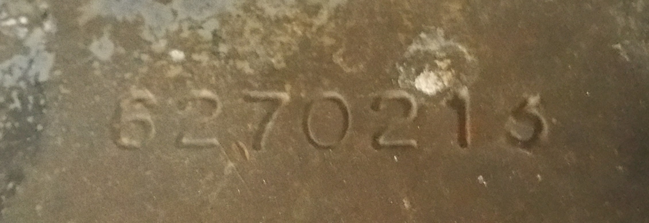

front shackle hanger is going to get replaced.
part number on the gm shackle hanger
next up is taking apart the springs down to the main leaf, and see if i can track down a set of front spring hanger mounts.

Re: krustythebronco a series of facepalms lol
Those Chevy leaf hangers work well
Bftank
Posts: 76
Joined: Thu Sep 15, 2016 10:17 pm
Bronco Info: 1996 bronco 6 inch dick cepek front, deavers in the rear
Location: Rifle, Colorado
Post by Bftank »
ChaseTruck754 wrote:Those Chevy leaf hangers work well
I saw your post about them when I was doing some research and had some on hand. I was thinking that I would move them back an inch or two and see how the main leaf flattened out at full bump.
