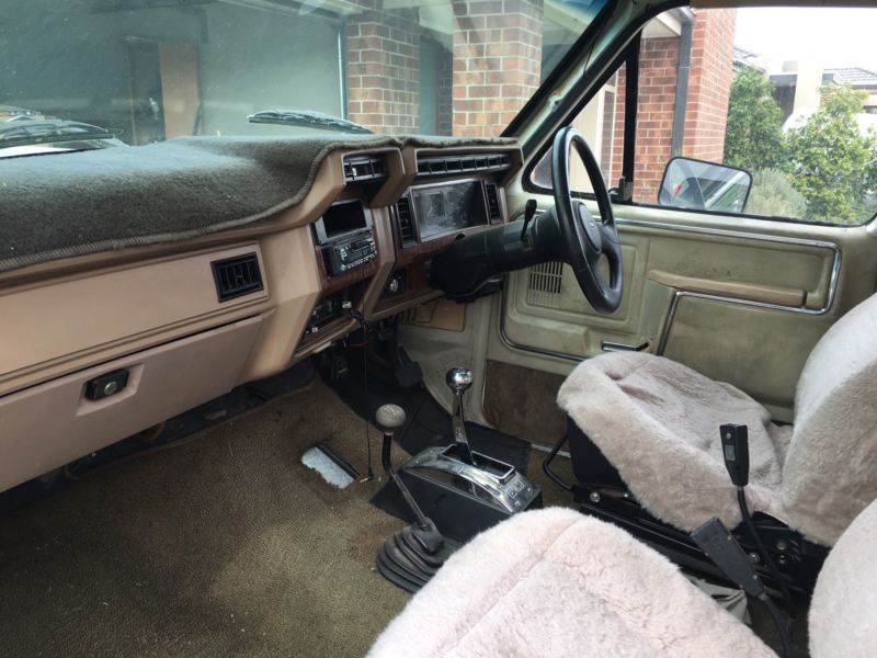

A few positives about his new purchase:
Bolt-in front third member.
Factory braced 9" housing (I"ll post pics later after it gets home).
351C engine (Aus Broncos from 80 to 84 had these, then went 5.0 EFI in "85).
C6/NP208 combo (compatible with my current spares inventory).
Already has propane installed and the old fuel system still in situ, so easy to re-instate.
XLT interior.
NO power windows.
Was originally a manual and we might still go back to NP435.

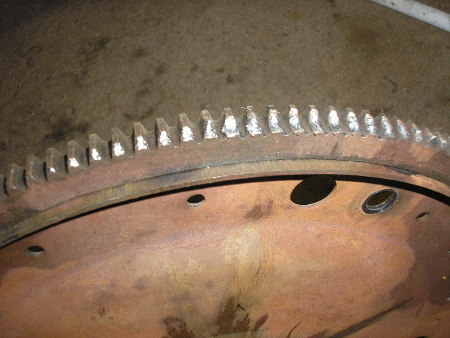

Well, it's home (at my place) locked in the garage for now. The flexplate is completely stuffed and it is a prick to get started (much turning engine with fan to get past the missing teeth), but it runs "ok". The pitman arm is loose and it is interesting to drive on our uneven highway surfaces, but I got it home safe. Gonna order some bits off eBay tonight and work out a plan of attack, then get stuck in. I'll post pics, etc. over the next few days.

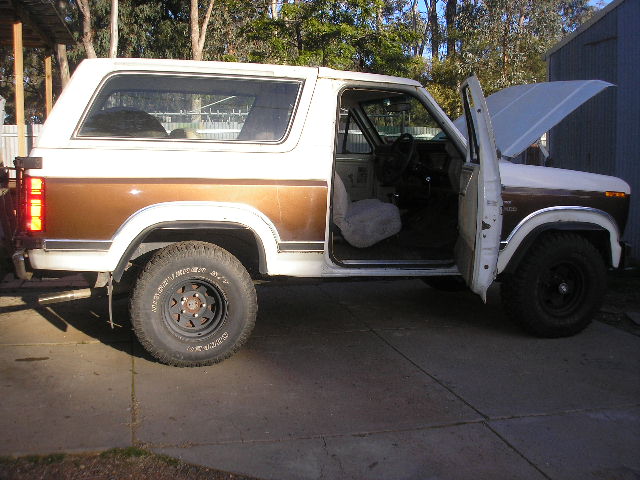

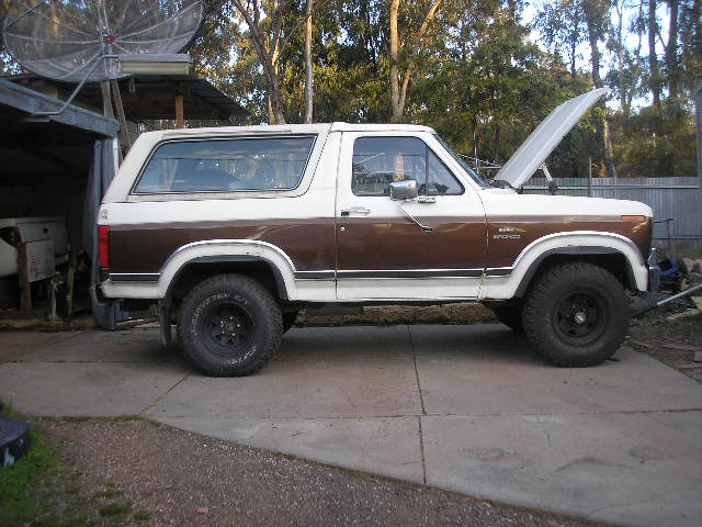

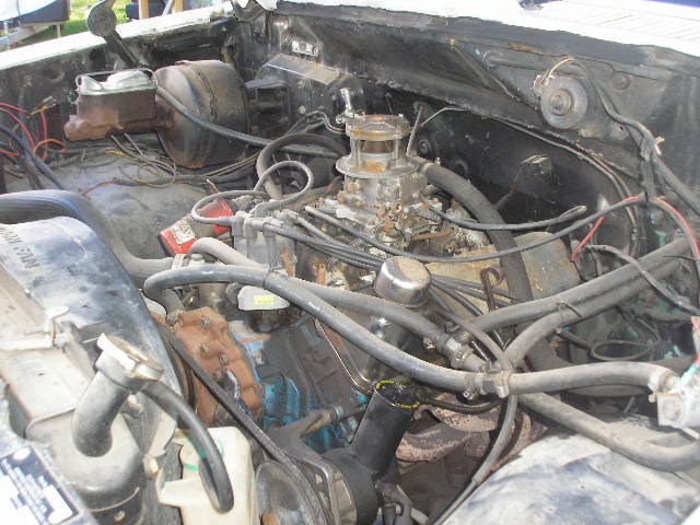

As it came put yesterday, prior to comp test:

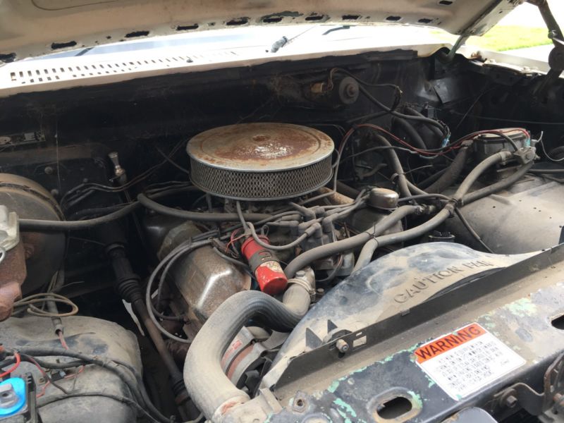

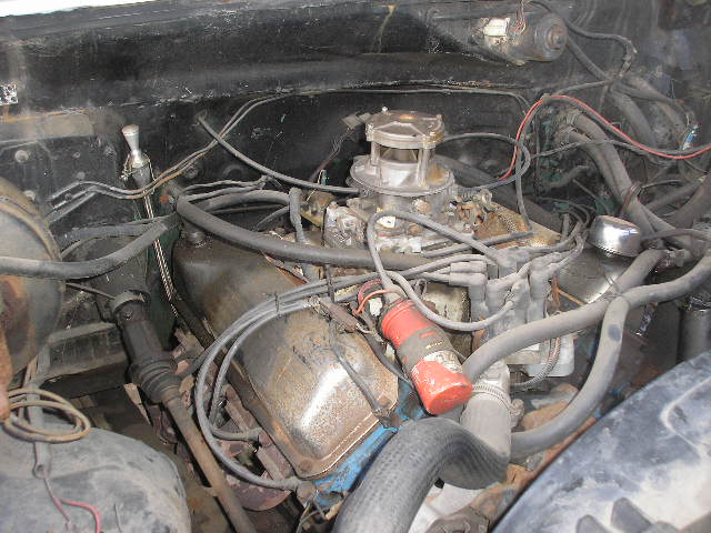

engine bay:

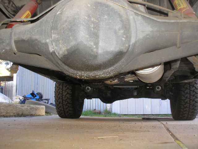

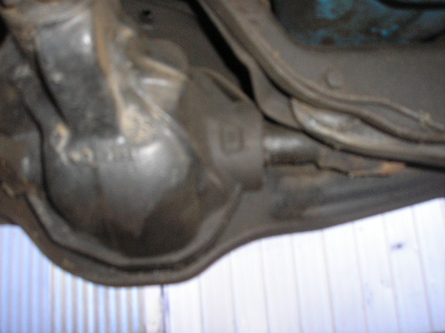

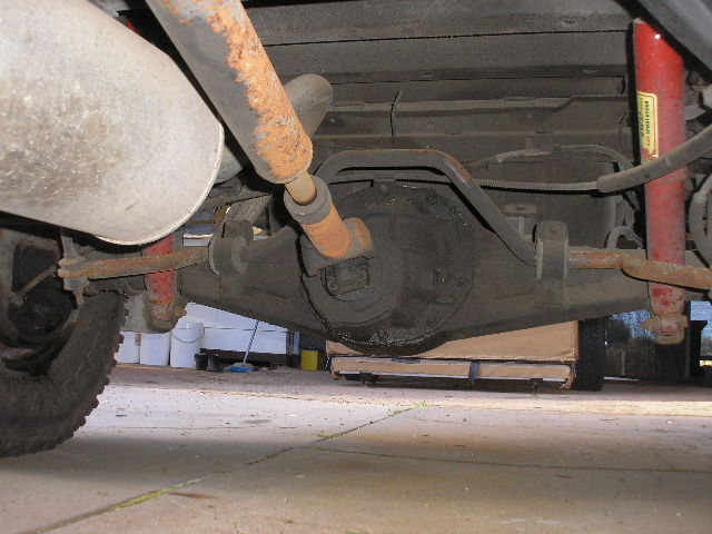

the Aussie bronco diff housing;

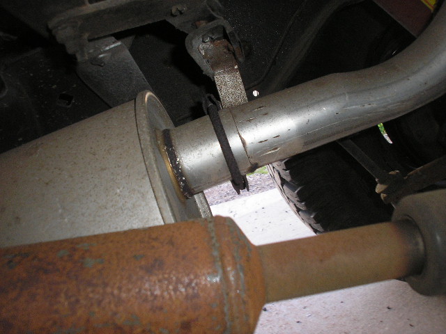

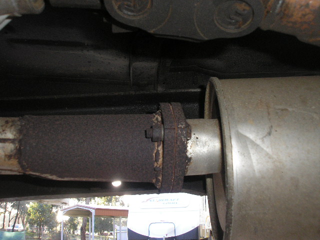

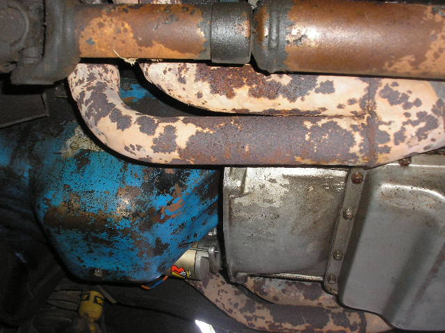

Shiity muffler fitted, 3" Y to 2" crap strangler:

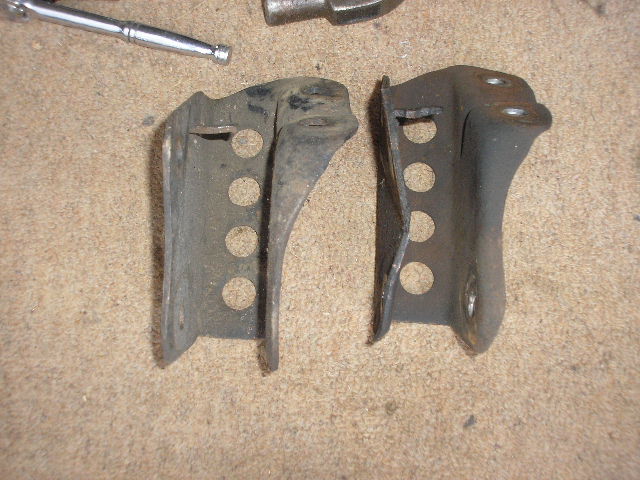

More pics:
Garbage exhaust:
Notice the fully collapsed drivshaft?
Rear housing from front:
Bolt-in 3rd:

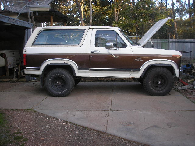

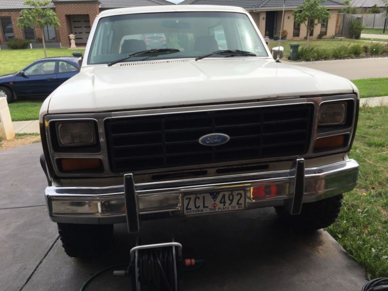

Level as purchased:
What it should be with levelling springs:

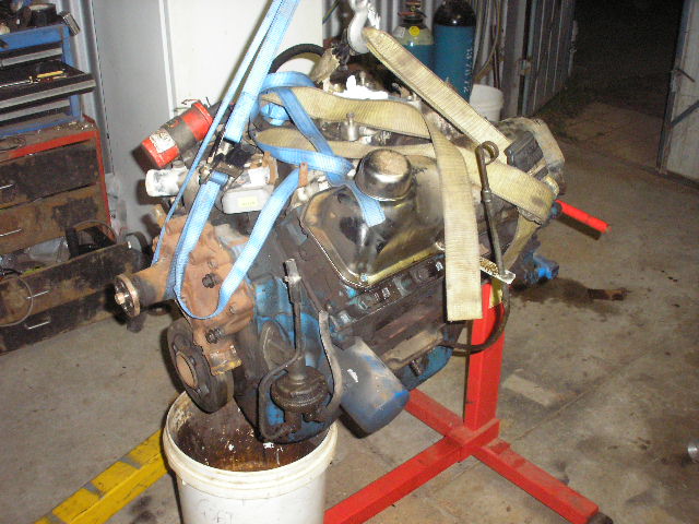

It's pissing down rain tonight (and most of the day), so I was fortunate to have decided to pull the engine yesterday. I started with carefully removing all the front trim and radiator support. I have to say, after seeing what previous owners / repairers have done to this poor machine (and my truck, for that matter) I'm starting to think that when workshops "work" on these things, it is a competition to see who can do the WORST job possible. The number of odd bolts (sizes, lengths and types) used to cobble the front of this Bronco together has me completely flabbergasted. I didn't take pictures of all the f**kups I found, I'd have run out of space on the disc. Suffice to say, I took my time, got everything apart neatly without breaking anything and cleared the front of the engine for removal:
While removing the alternator, I noticed the bad mis-alignment and multiple "spacers" used to douche the install of the INCORRECT type of alternator for the application:
It was dark by the time I pulled the engine, put it on the engine stand to drain the fluids , pull the Bronco back out of the garage to it's resting spot (allows me to lock the garage) and snap a few final pics:

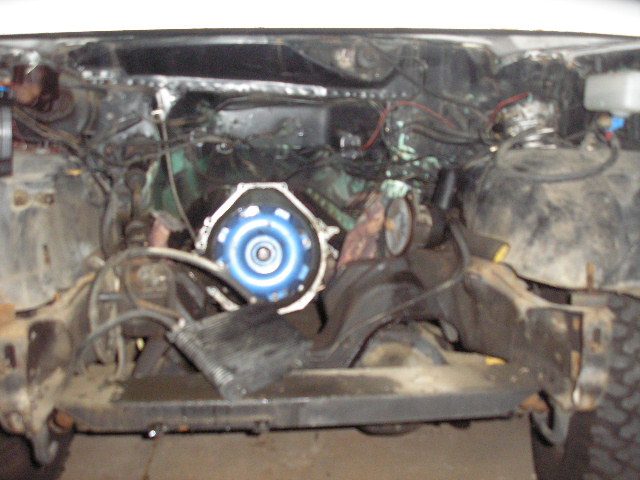

The flex plate:
Over the weekend, I will CAREFULLY remove the engine from my truck and get it ready for the install in the Bronco. I have to clean up the engine bay, chassis and surrounding area before it goes back in. Hopefully, I can make it look at least as neat and clean as my truck looks so it will be pleasing to the eye and RELIABLE.

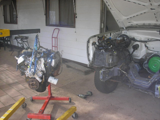

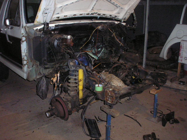

Been so busy lately, haven't had time to post up. I finally had a good day on Sunday, so I broke out the degreaser and the little pressure cleaner and went to work. Most of the grease and dirt has been removed from the chassis where I could access, and the firewall is clean enough to start stripping down, cleaning and sand blasting off the shitty black paint, rust and other shit. There are a few smallish rust spots I'll need to attend to, but I will do some good patching and make it last for a while until we do the truck properly in the future. After cleaning it up, I let it dry while I got everything ready, then backed it up and turned it out enough to get my truck past and into the garage, where it will stay until the Bronco is done. The engine is out and on the stand behind it, ready for when I get the engine bay prepped. I then pulled the Bronco back into the carport and set it up with the front end on 4 jack stands to start the repairs. Now I can work under cover and not worry about the rain spoiling things. Last night I was out in the cold, stripping off loose items, removed the dicky lowered engine mount plates (factory?), inner fender wells and separated the good wiring from the throw away stuff. I will make a new propane harness, with the dual fuel component installed for later and do some serious tidy up on the engine harness and around the battery area.
Tonight, I stripped off the fenders and did a thorough inspection, it's not too bad. Then, I got under the dash to trace and remove stray wires. What a fucking bird's nest! I've managed to strip out several metres of old wiring, removed the AC hoses and pulled them through and sorted out where the rest of the wires should be. Once the engine is back in, and before the fenders go back on, I'll re-do all the necessary wiring repairs and mods and make sure EVERYTHING works correctly. I've also left the AC unit inside the dash, it will come out if the dash needs to come apart, but it can stay there until then. I'll make a neat alloy plate to seal the AC holes and I'll also close off all the other holes idiots have drilled everywhere to keep out fumes and water, etc. I also removed the pitman arm to see WTF is going on with the steering, and it appears to be the wrong arm. The spline area matches, but its too bag and needs a washer to even get it close to tight. The problem then is, it is pulled up against the bottom of the box and starts jamming up. I need to do some more research on this, as the box looks fine, otherwise. During cleaning, I also fount that the right front of the X member at the beam pivot has had a hit, and will need the beam and bracket removed so I can porta-power the dent out. I have a spare beam pivot, so when I do that job, it will be replaced. I'll get more pics tomorrow, my camera doesn't like doing night shots too well, but here are some;
Engine out of my truck:
Bronco in the carport all stripped down:
Dent in the X member:
Strip down view 2:

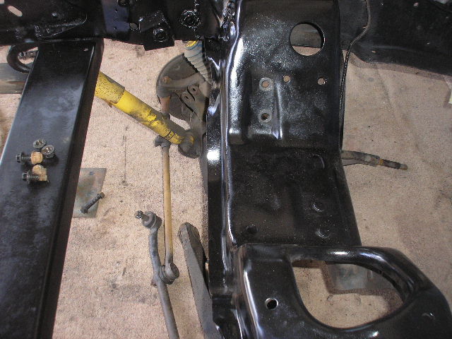

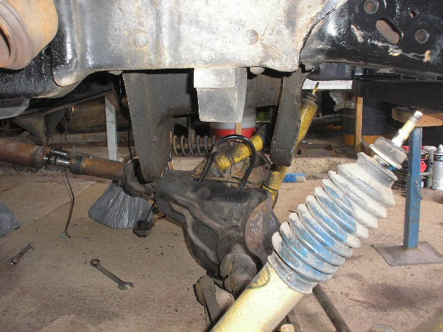

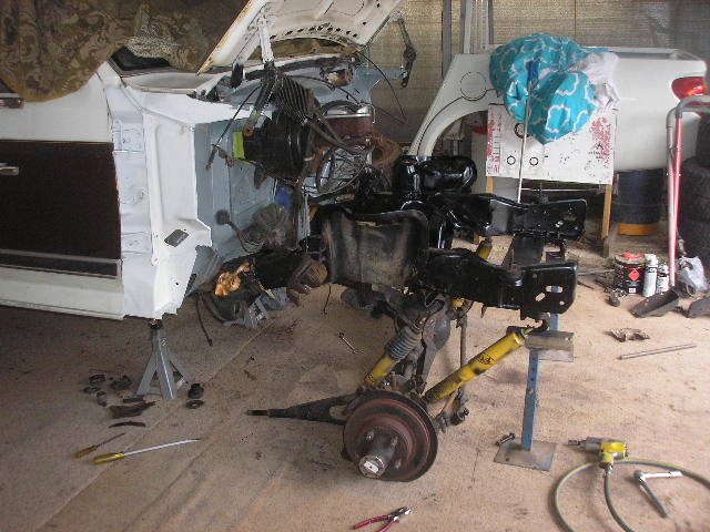

I've been spending an hour or two every night the last 2 weeks getting stuff cleaned up and doing some minor rust repair. The firewall and sides of the foot wells have come up nice, and there isn't any rust worth worrying about too much in the danger areas.

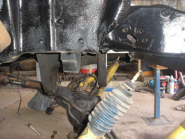

Yesterday, I doubled down, pulled the TTB and started on the frame repair:
You can see where it is bent back:
Damaged beam pivot on RHS, replacement on LHS.
All straight now.
A few hours later, the frame and firewall look totally different:

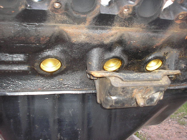

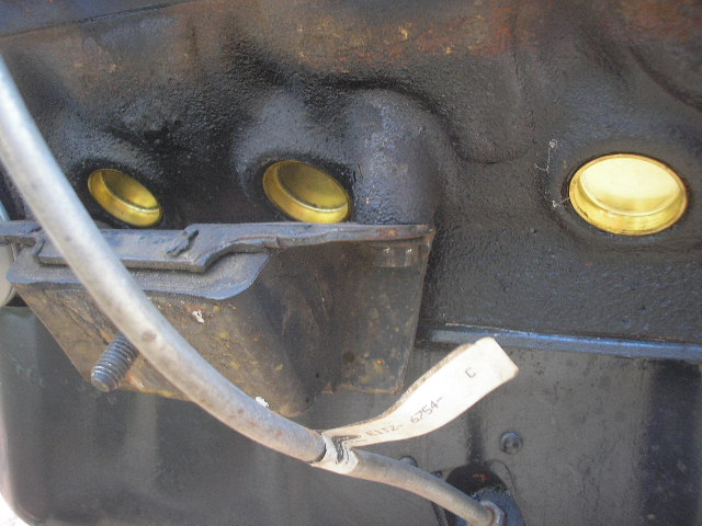

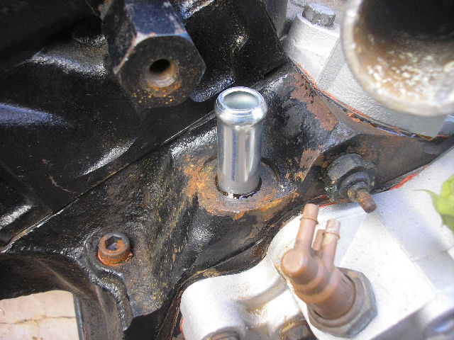

Today I started on the engine. I first knocked out and replaced all 6 freeze plugs with new brass ones. The original steel ones were corroded, so replacing them was good insurance:
I also dug out the old rusted heater nipple and fitted a new HD replacement:
