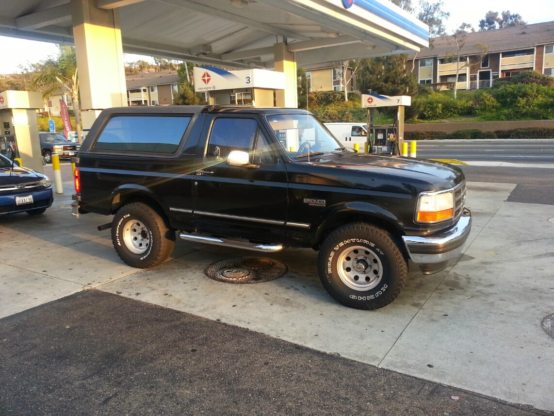

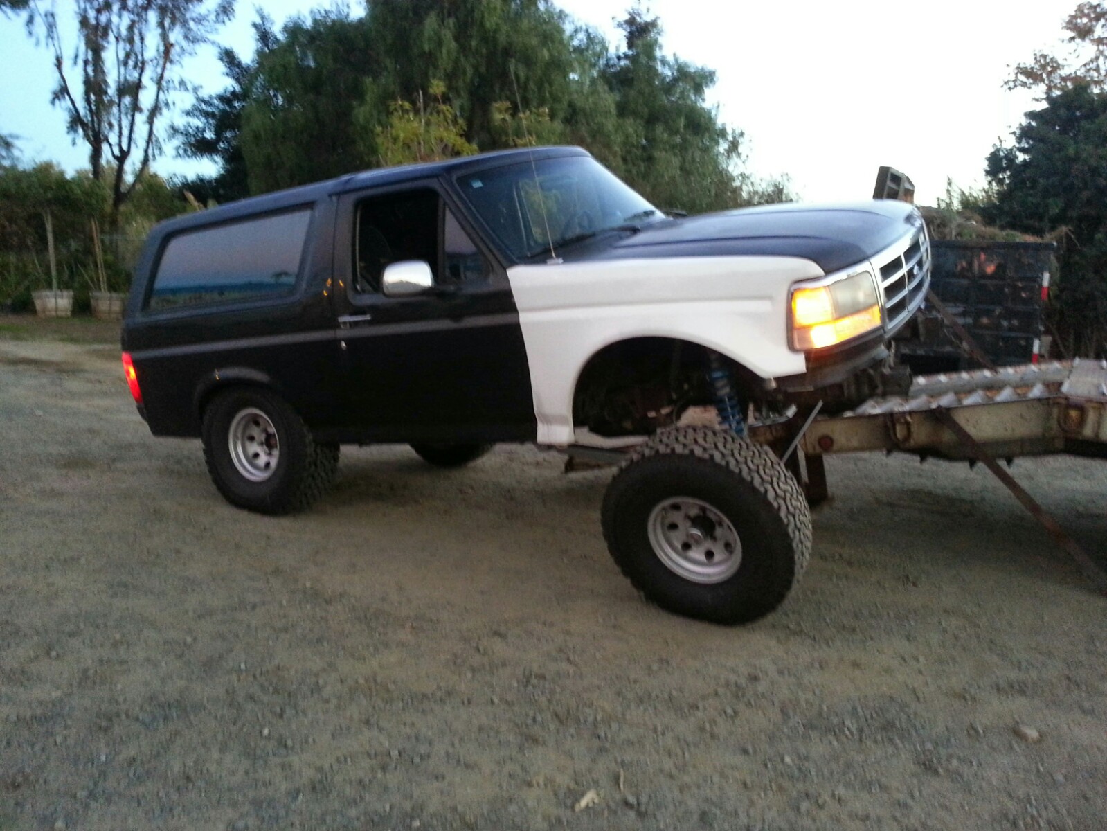

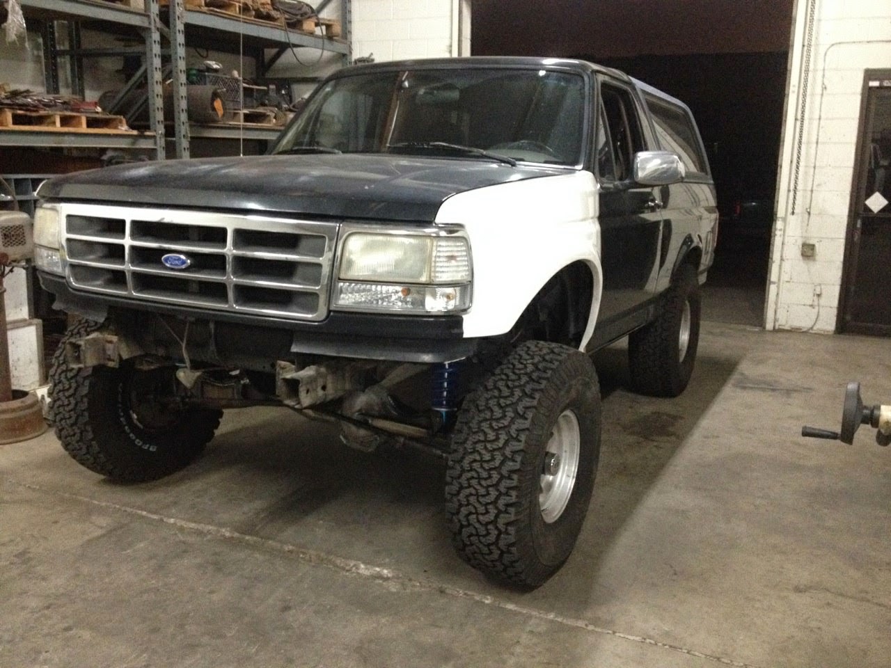

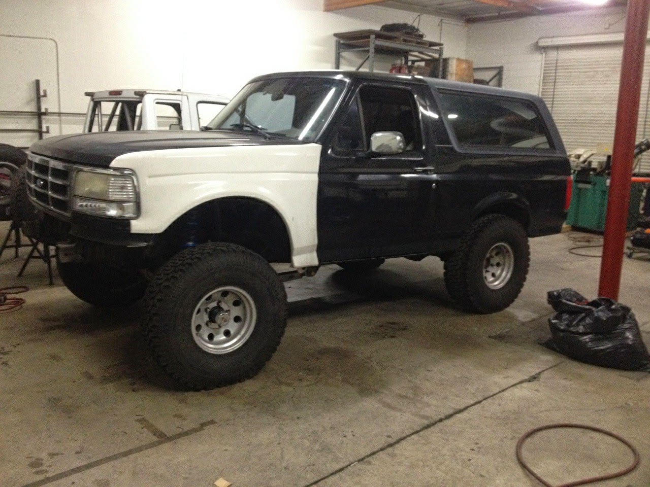

My bronco has been through many stages and hiatuses in the past 3 1/2 years, but is FINALLY getting the treatment it deserves! It started off as a 95 bronco 5.8 with just over 200K that I picked up for $2200.
Here is right after I purchased it

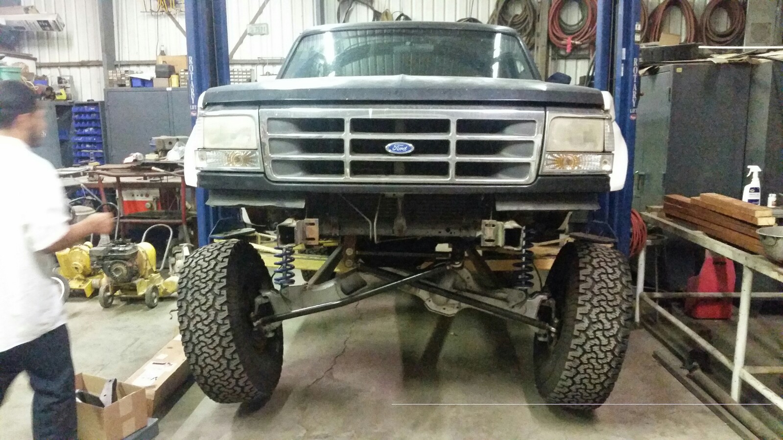

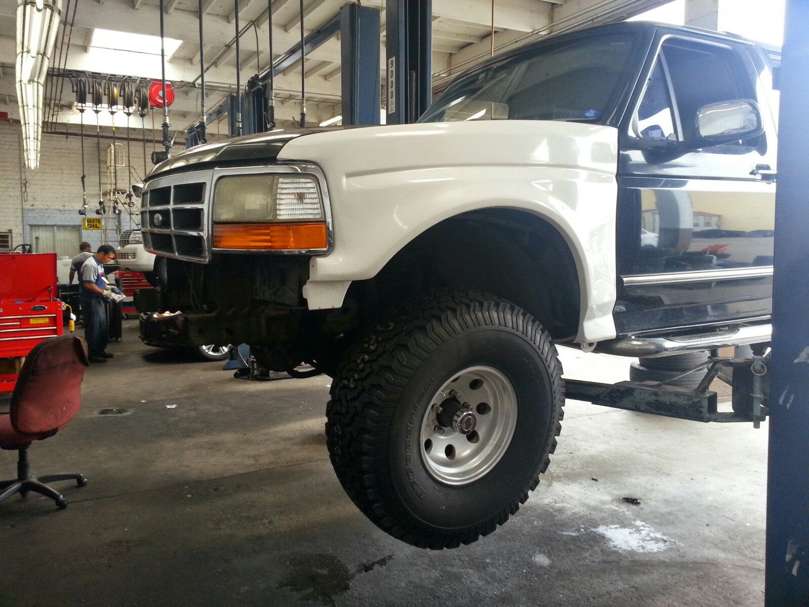

new 35" bfg a/ts and fiberwerx 4.5"+ fenders

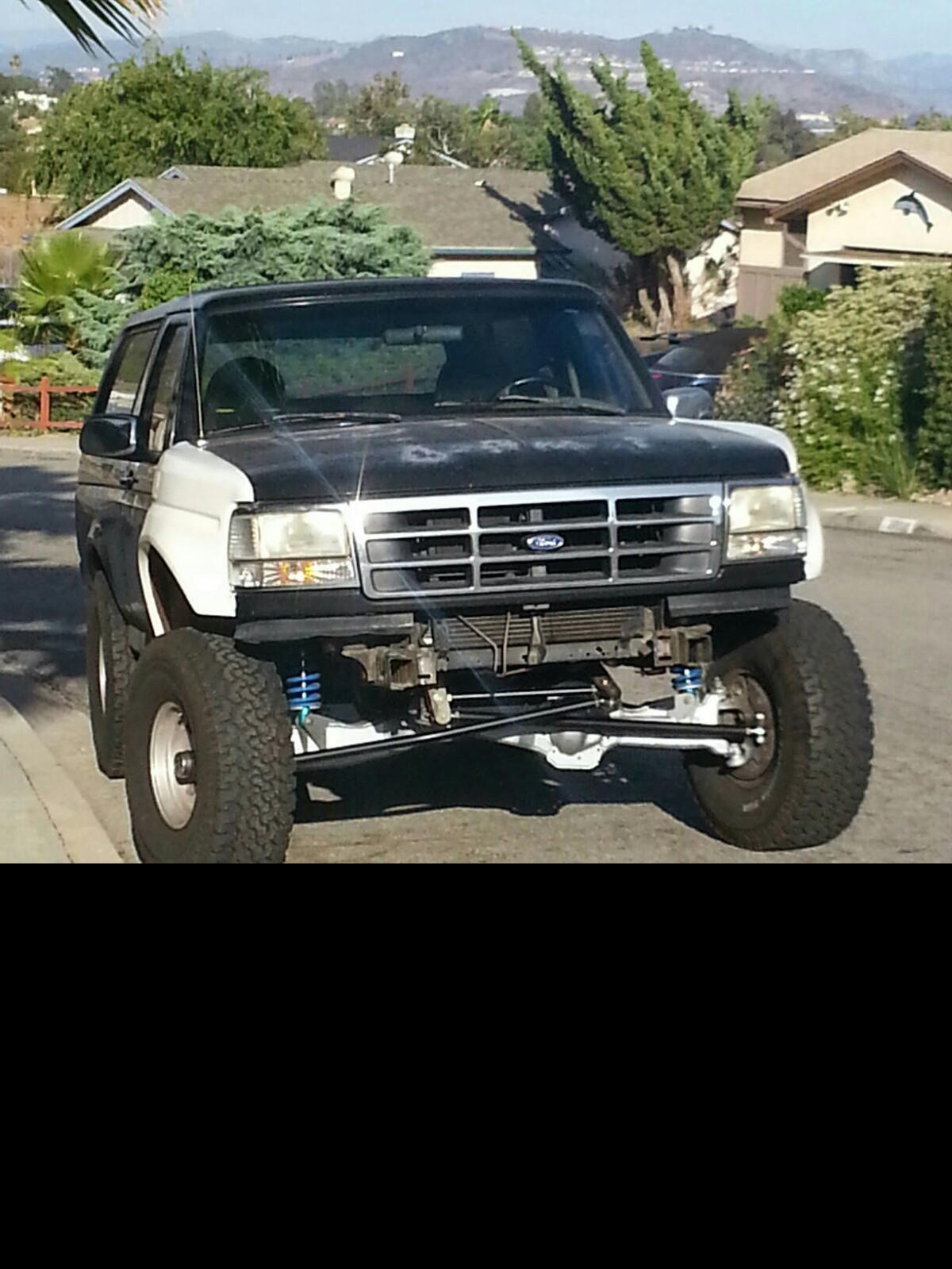

threat 4.5"+ beams and 2.5x14" king coilovers installed
some flex testing after a fresh coat of paint

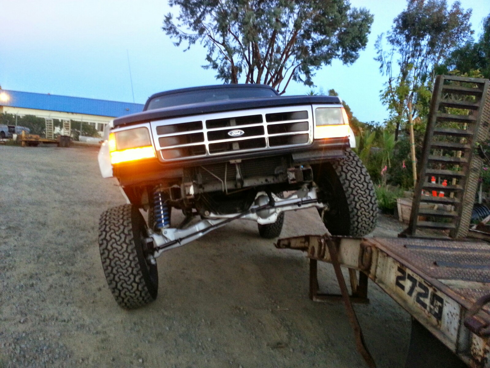

swing steering installed

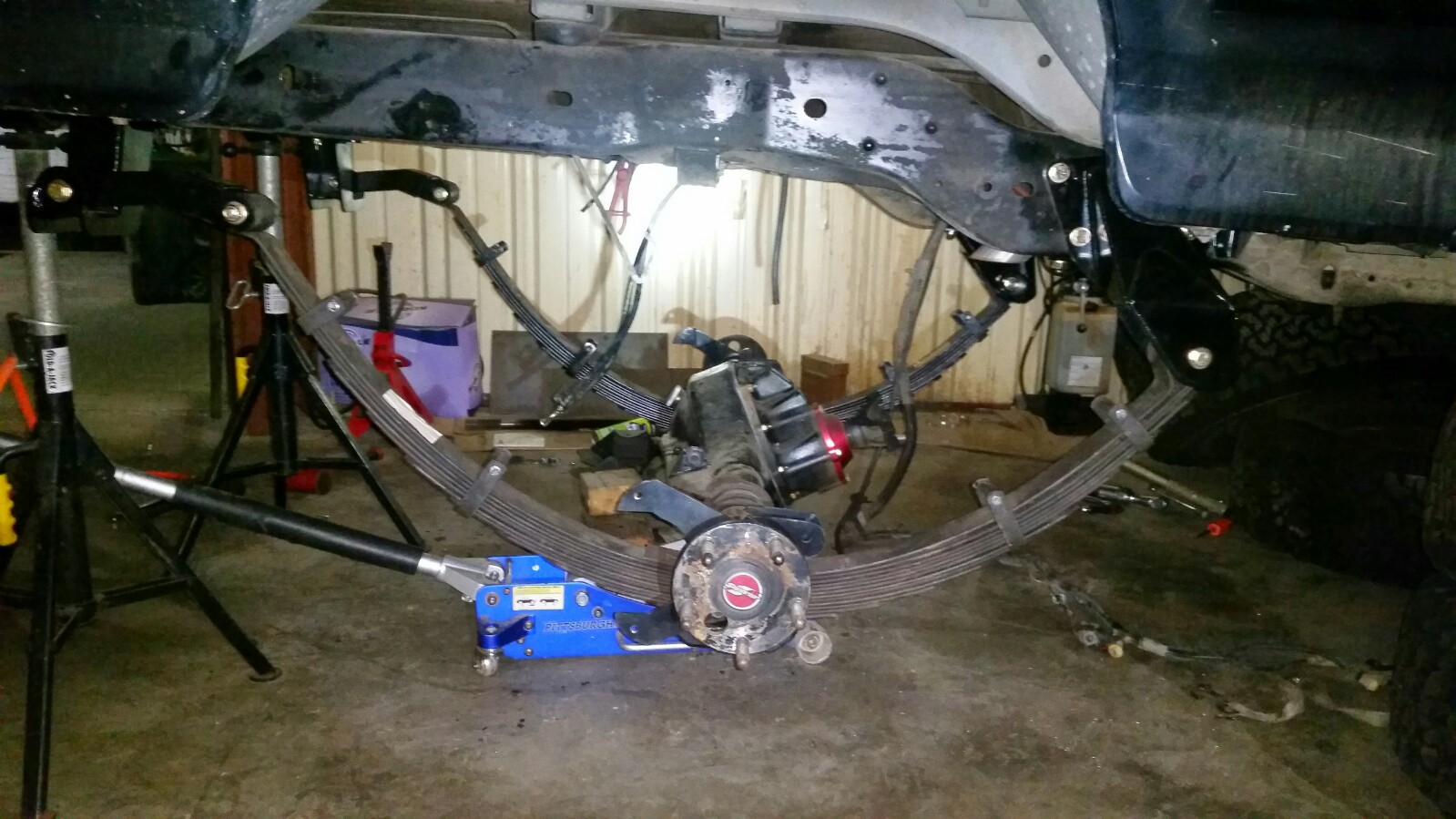

64" spring under kit being installed
richer racing sexy beef hangers before install
got droop?

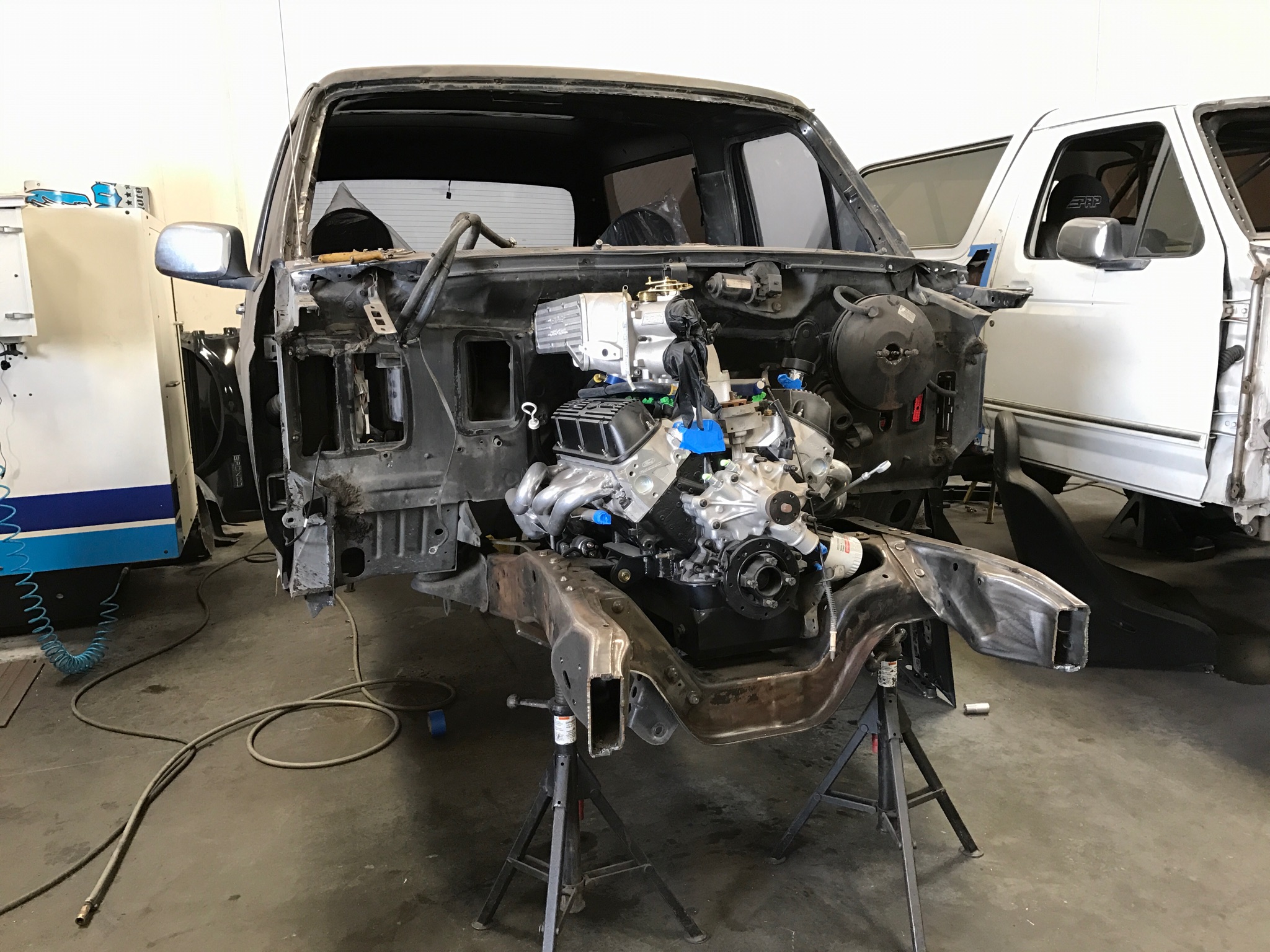

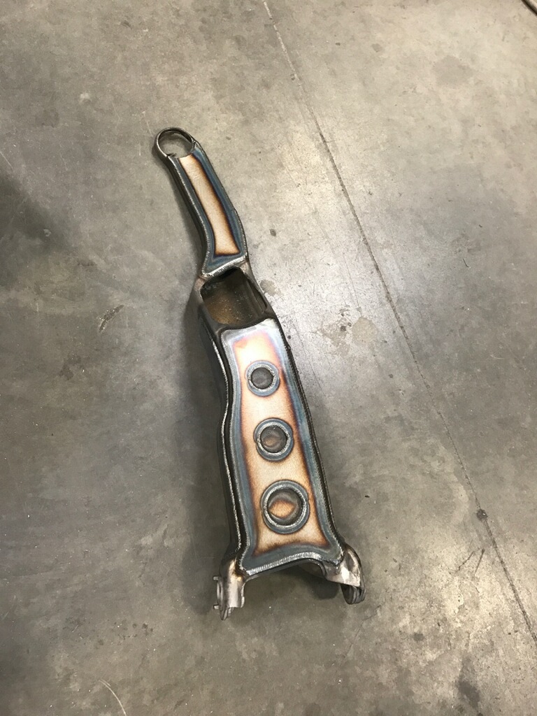

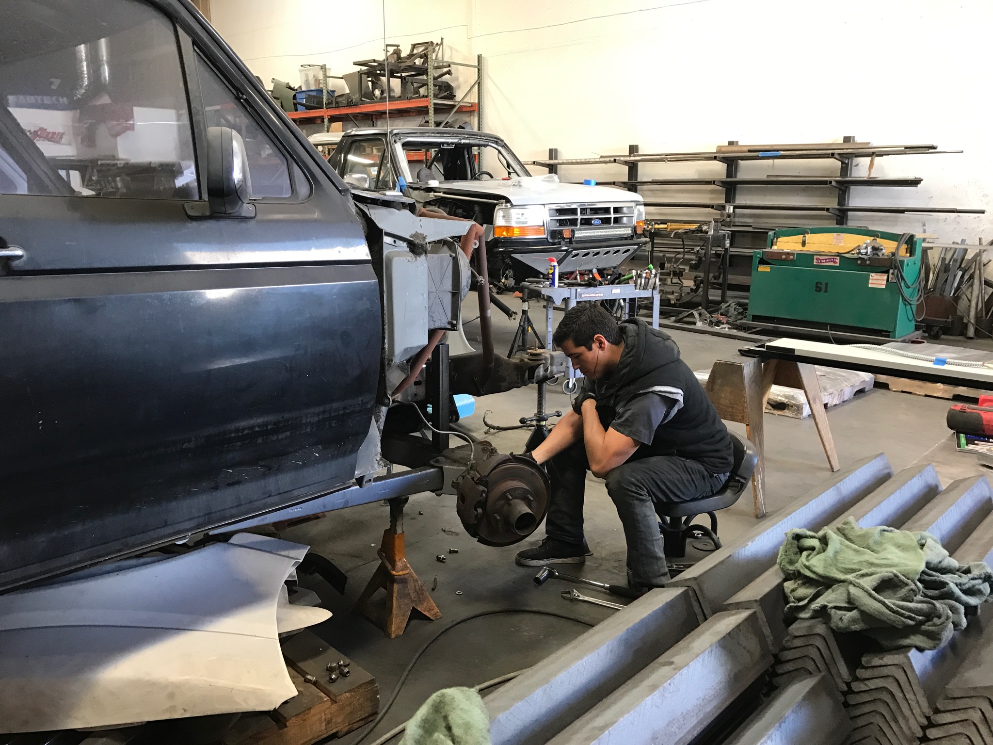

Cho rocking out! as the tear down begins!
new cho beams looking so fresh!
moment I have been waiting a long time for!! toooobs!!
and in typical richer racing fashion :lol:

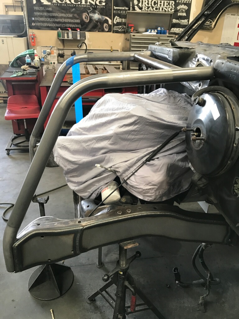

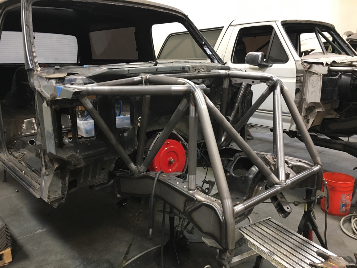

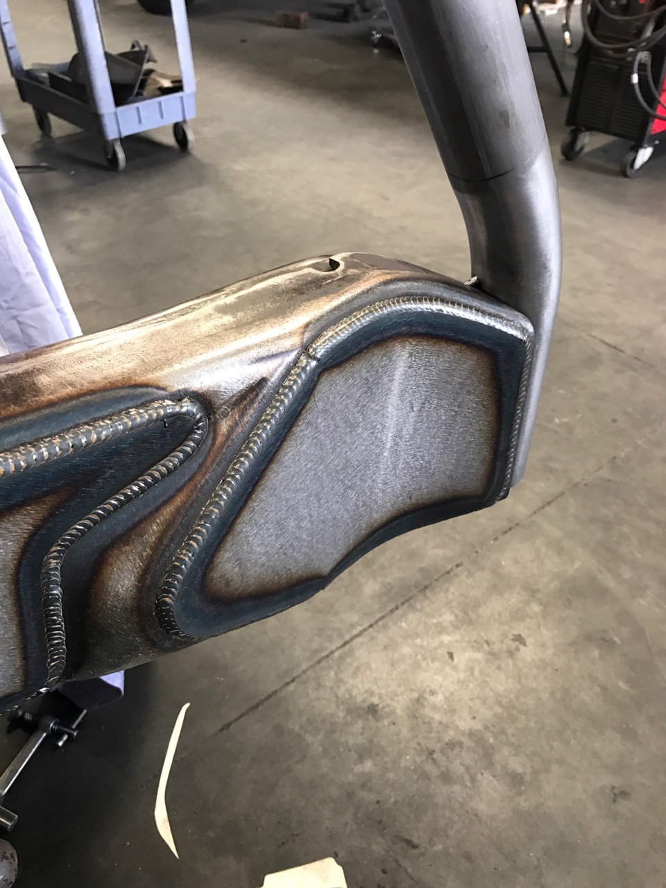

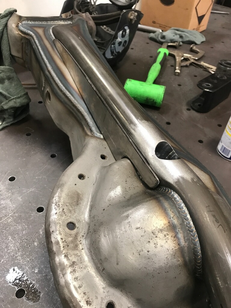

full outside frame plating

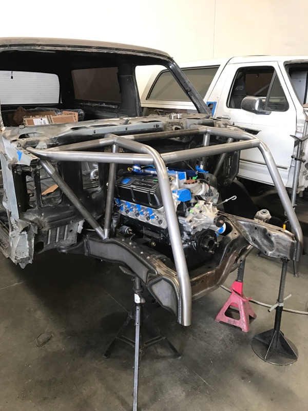

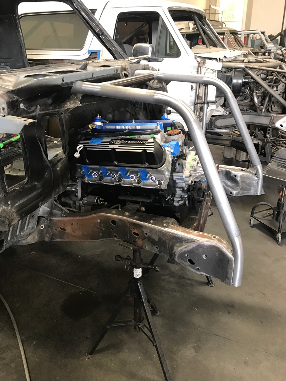

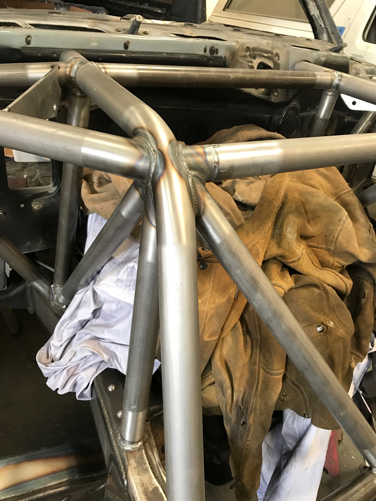

engine cage coming together!

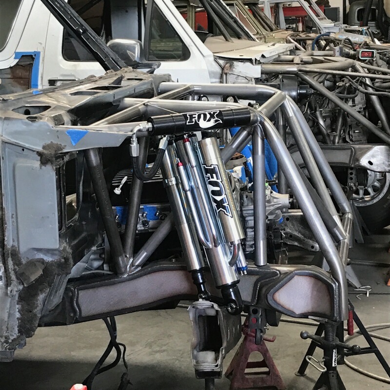

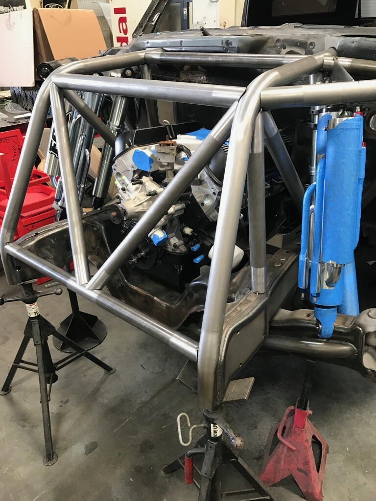

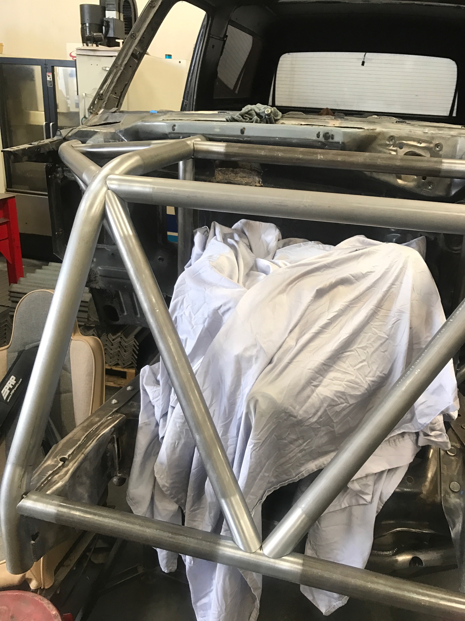

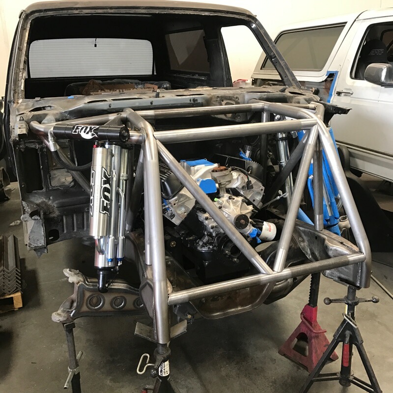

shock mount time! 14x2.5" fox factory series coilovers & 14x3.5" 5 tube bypasses

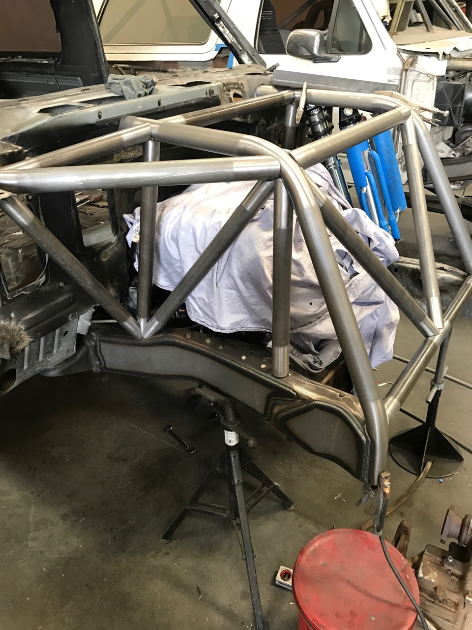

tube clamps installed and engine cage welded

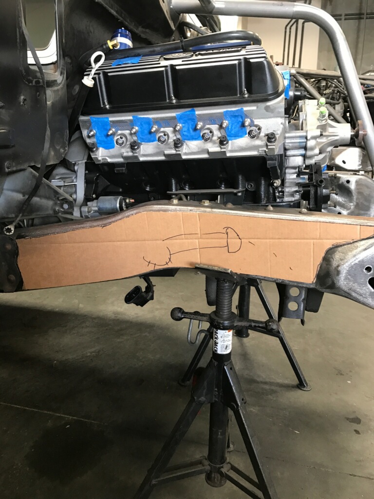

oh yeah forgot a couple. Initially thought we would have to weld tube clamps into the center "V" as well, but Cho said the motor came out easily after removing the oil filter.
