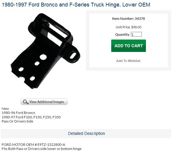

The lower right door hinge is sloppy and the door sags, so it has to "lift up" to close tight. First time I've ever witnessed this.....on the newest Bronco we've ever had. I would have thought it would happen on the left side first due to more use. Three other and older Broncos have had issues but not here.
In any case, has anyone tried the JBG repair kit on one of these? Love it if it works properly, but sometimes a bandaid is better left to the real part.
