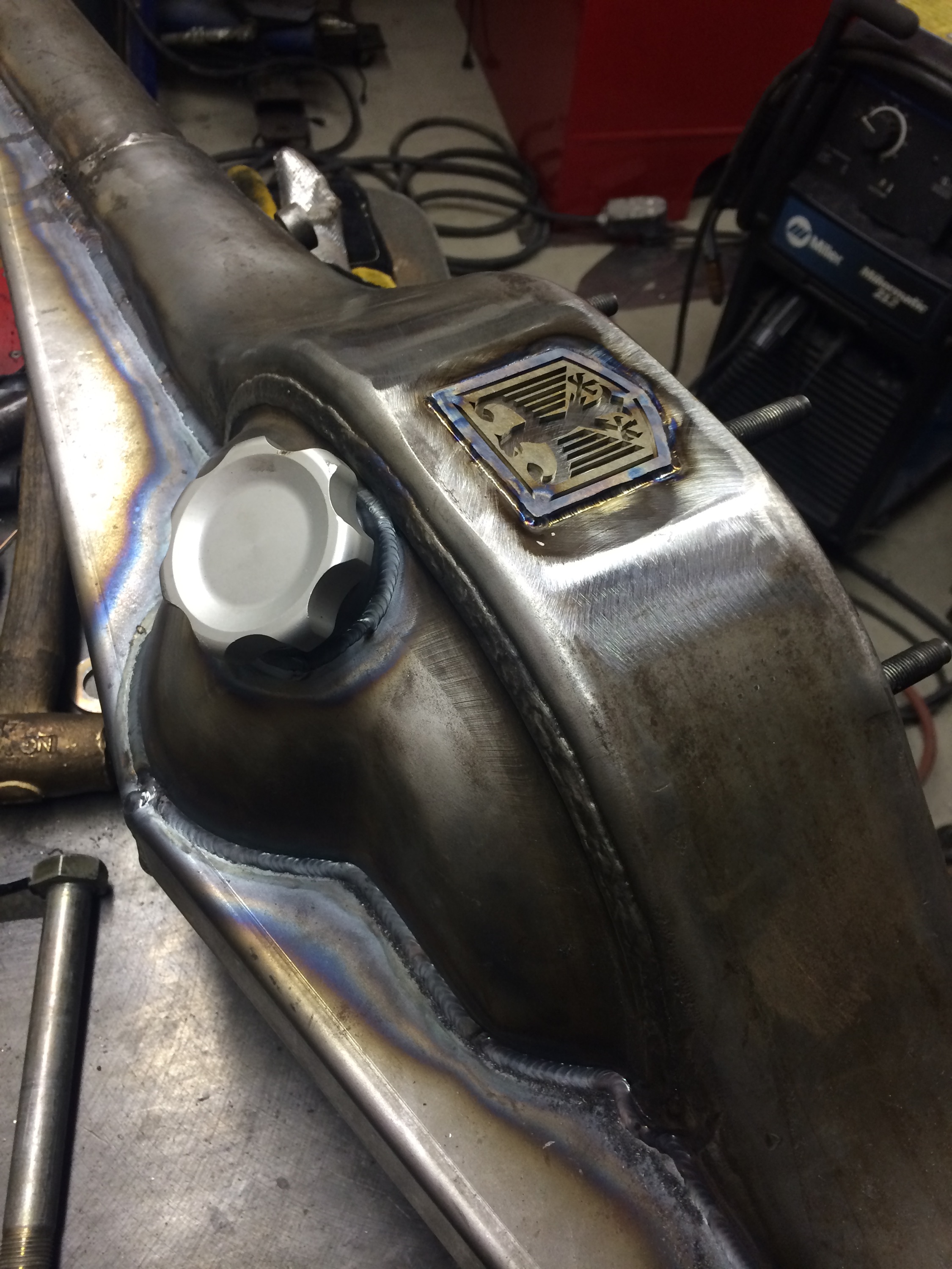

The next post goes out to Flight Industries for his work on my 9"axle!
The factory bronco 9" I picked up off CL; trussed by our very own Flight Industries!!!

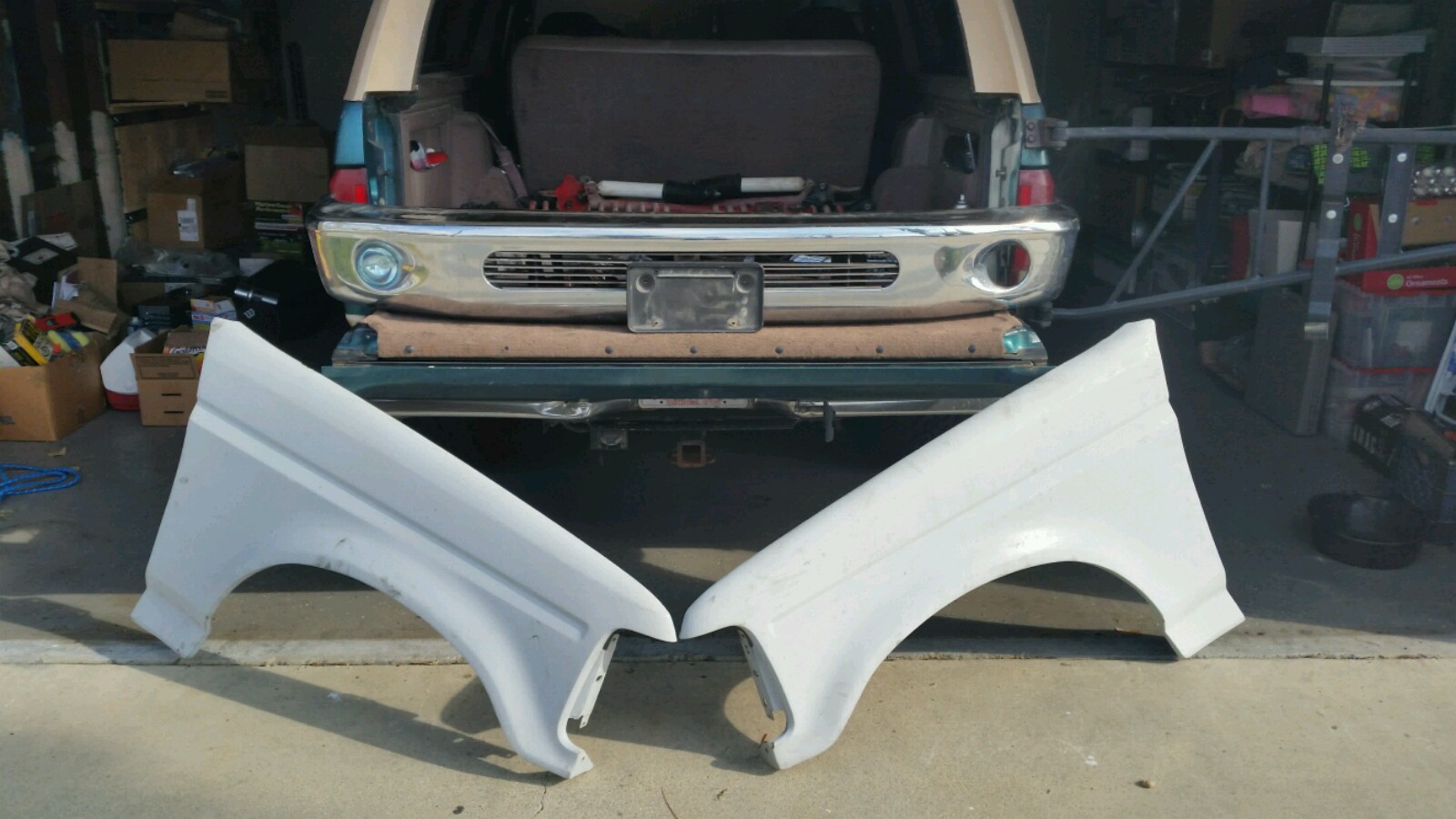

Stock with Autofab fenders. Thank CSdrums!

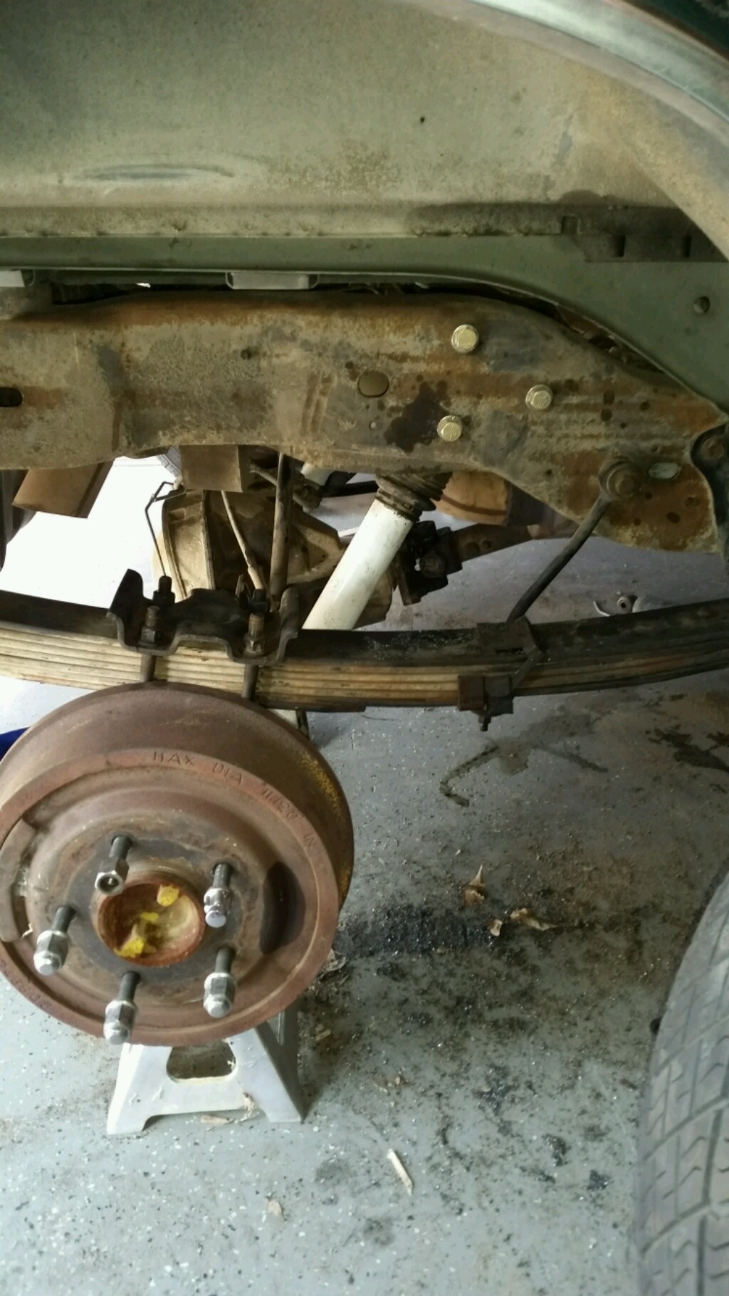

All set to pull the rear leafs.

Rear is done!
Rear is done!
Inder her own weight on the loaner rubbers!! Thanks again Keenan.
Almost completely torn down.
