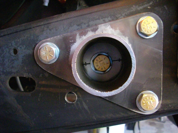

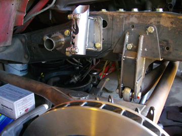

Here are some more photos of the progress. Here is a photo of the front mount for the shock hoops. I am working on rear mounts for the shock hoops and should have them done on Thursday. I also need to run a plate inside the frame to reinforce the area between the cross member and the first body mount under the floor of the cab. There are a lot of holes there and I am going to fill them in once the plate is in place. I will post a photo of what I plan on doing to give you a better idea.

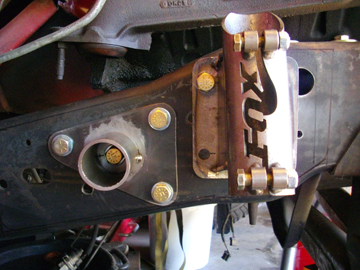

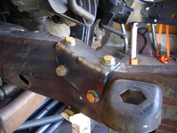

So I finished the rear mounts for the shock hoops. I think they came out nice. I made the plate line up with one hole that was already in the frame. Of course, it had to be drilled out to 1/2". Then I used a 2-1/2" long 2" diameter .120 wall tube and welded it over the middle hole. Should be strong enough. I also finished building the bump stop mounts and got them bolted in place. Everything is moving forward without too many snags. When I finish all of the brakets, I will weld everything up. I learned long ago to just tack everything first and do the final welding when everthing works and lines up. I will work on the brake lines for the front calipers next Thursday.

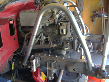

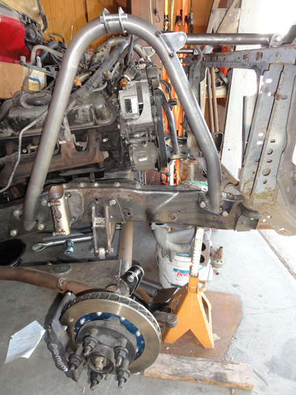

Started the shock hoops. They came out really well. I made the driver side first to clear the brake booster and steering. Then I matched the passenger side to the driver side. The fun part is getting the front of the shock hoop to fit the front mount. It has to be notched to fit the angle the tube intersect the frame. I made a mount for the shock so I could see where it would sit. That's why it looks so funny in the first photo. Don't worry, it's just temporary. Once the hoops are finished, I will work on the tabs for the top and bottom. The 3.0 triple bypass is not going to be used in the front, it was just the same size as the 3.0 coil over I am going to buy. The triple bypass is going to be used in the back.

I am making everything bolt on so things can be fixed if they break. I am only using the triple bypass for mocking up purposes. It is the same size as the 3.0 coil overs that I am going to use. The front will only use one shock per side. The back will have leaf springs and 3.0 triple bypass. Thanks Steve.

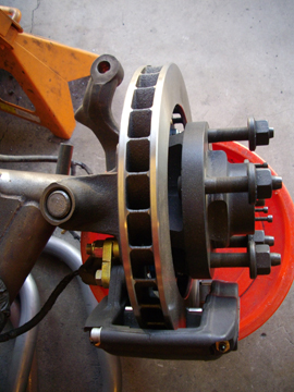

John at Autofab is making me Vessel fenders which are wide enough for the front end. I took my daughter with me today to work on the Bronco. We got the calipers mounted and the brake lines on the driver side. I also got forged alcoas for the Bronco. Need to get the rims sized for the larger hubs. Then I will get the tires mounted and then it will sit on the ground. I will take pictures of it next week.
