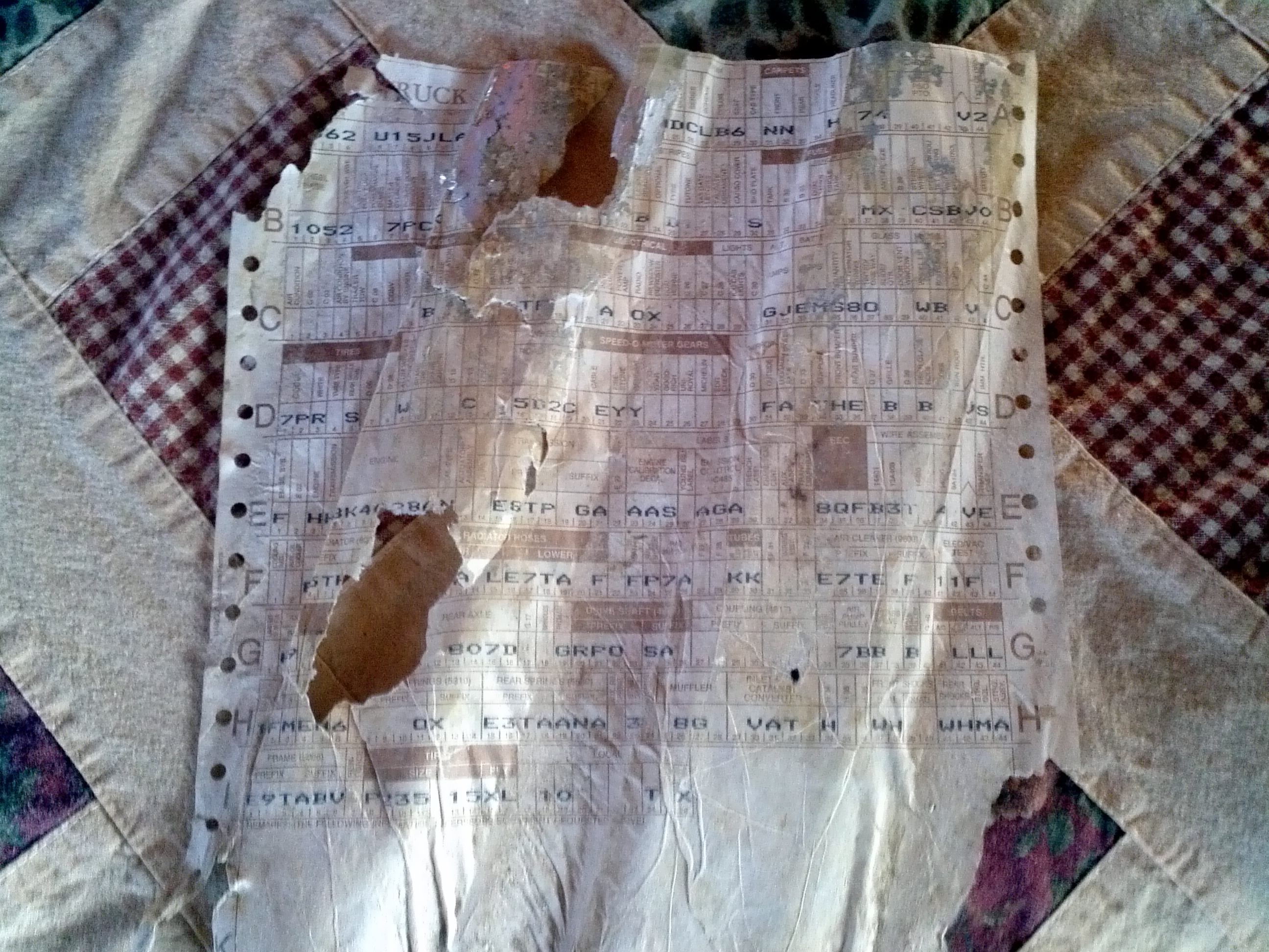

Took out my carpet and BOOM the mares 999 report now I just need to know what this means and fill in the blanks (or spend the $ and order a copy from Ford)

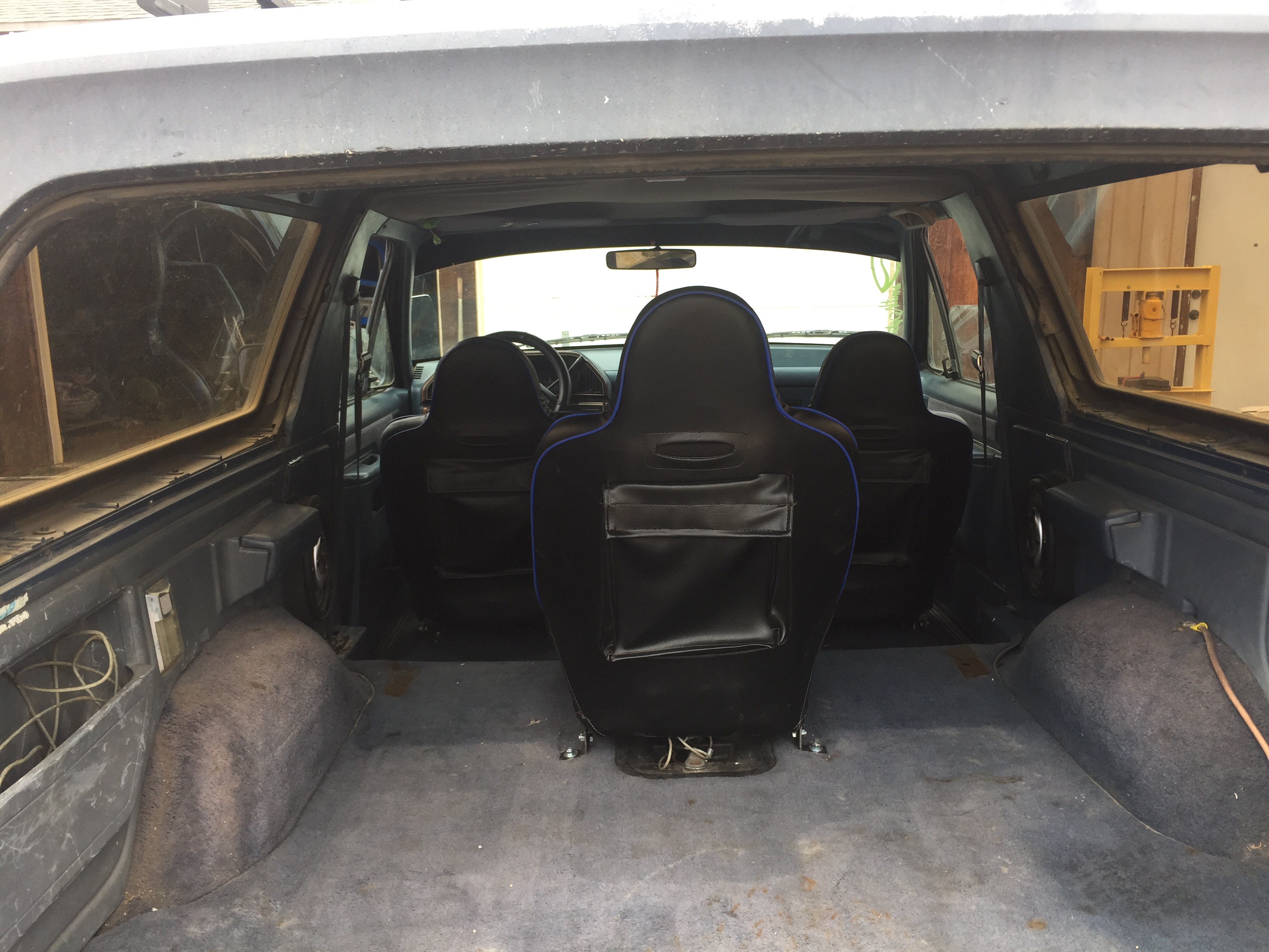

Picked up 3 of these for a song so I guess that makes the mare a 3 seater :shock: :lol: could use some ideas on mounting I'll also have the stock bench seat avb if anyone wants one
wookiee156
Posts: 96
Joined: Sun Feb 08, 2015 11:48 am
Bronco Info: 1988 full sise aka "The Blue Mare" soon to be prerunner / chaserig
Location: Big Bear
Re: the wookies blue mare
Post by wookiee156 »
Got the seats in temporary ROOM for activities :shock: :D

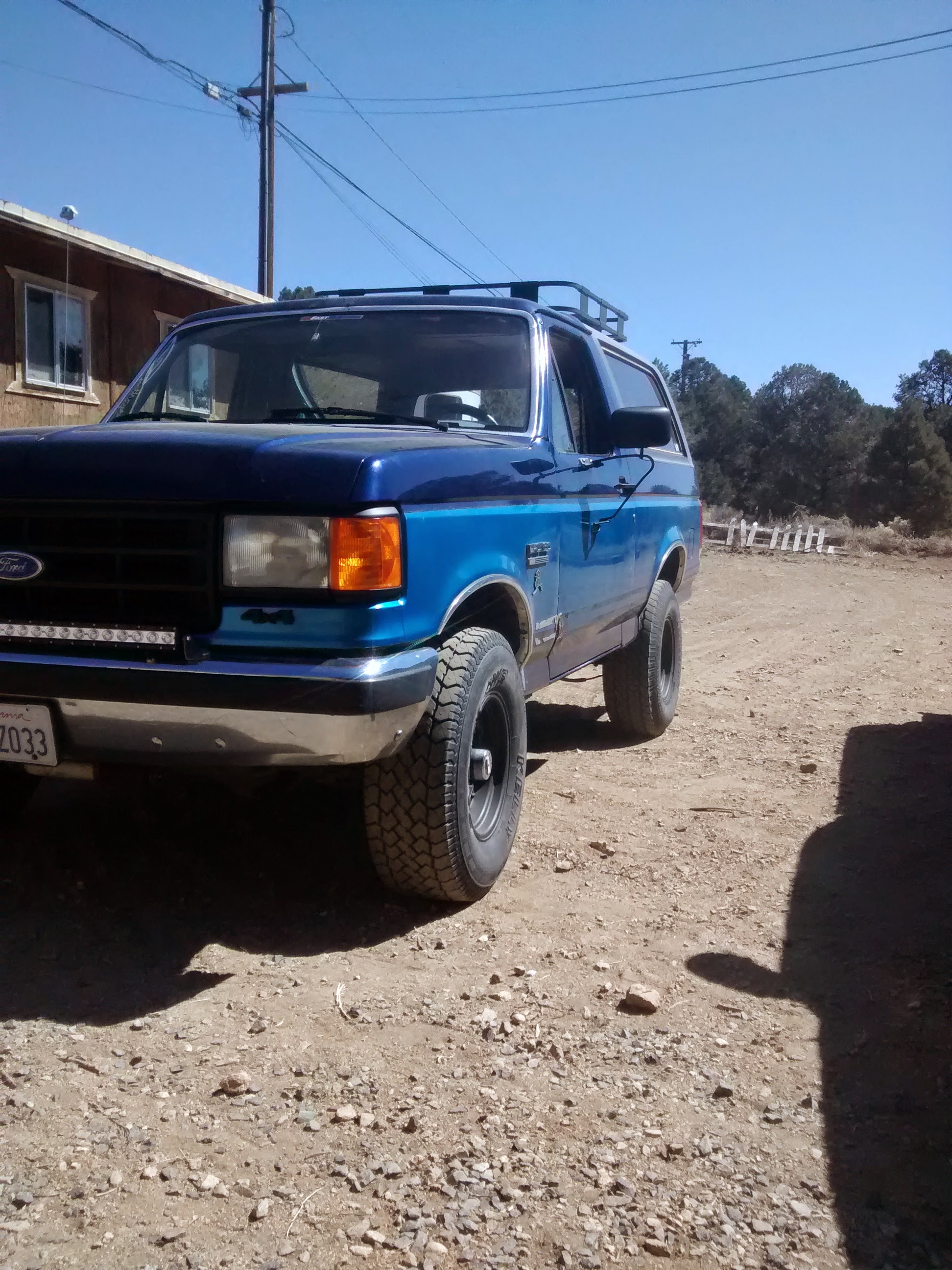

Soooo I knew this was going to take forever but I have done some things to the mare. I decided to buy a lowered Subaru and well that took time and $$ now it has a phantom misfire so time to make the mare live and get on with this project. Oh ya I was doing an update...
new things
33 bfg atk02
Big light bar on roof
Green strobes in grill
Siren (I do a lot of shuttleing on live bike trails)
Dust light
Harness
Subwoofer (gots to have bumps)
Green underglow ynot
So see I have been busy

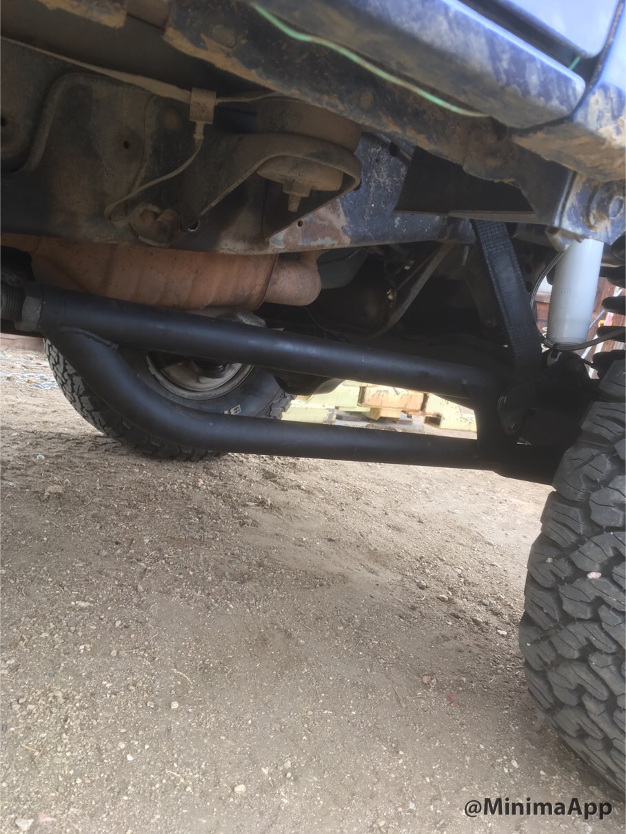

Update!!!! The teardown has begun and dam Alaska in the late 80s early 90s was harsh (whoever thought it was a good idea to use salt on roads needs to drug on salty roads and shot in all their joints then the head) but I dirgress paps and I pulled the front end apart this weekend and dam now I know why these shops charge so much for installation (especially with my dominant hand in a sling) anyway hopefully these pictures post any feedback on what else I need to replace while I’m at it would be appreciated

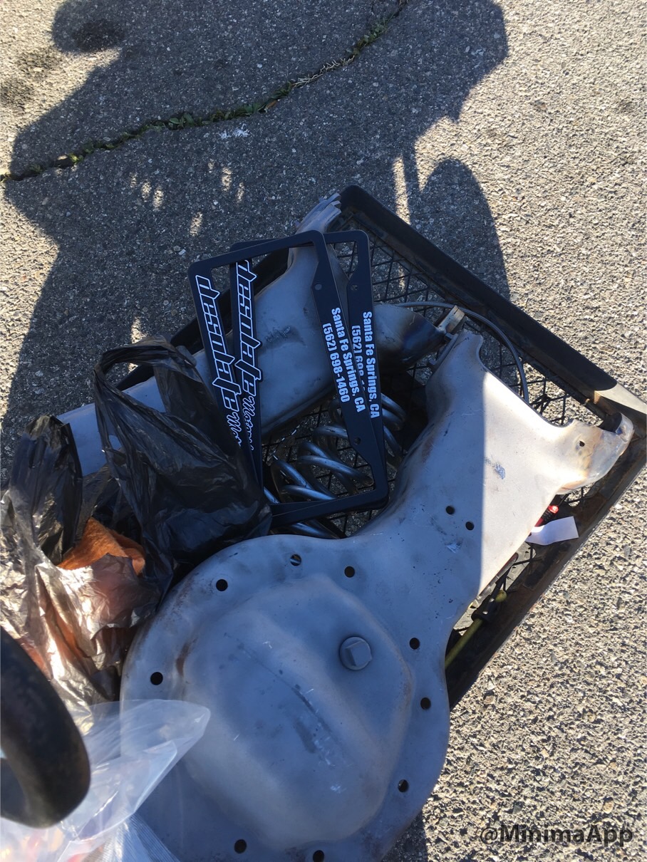

:D Woo hoo the swap meet was a success picked up the last few things that I needed to get her done hopefully I can get her back on the road before the end of March :D
Score thanks again Greg at desolate Motorsports
The gold foot had to go
Another score from the swap meet

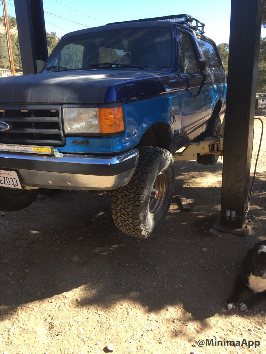

:lol: Well I got the mare back on the ground and just need to get it aligned and level the rear and then the next steps start #neverendes photos :D
Did I mention I like the way this came out
I really dig the valance

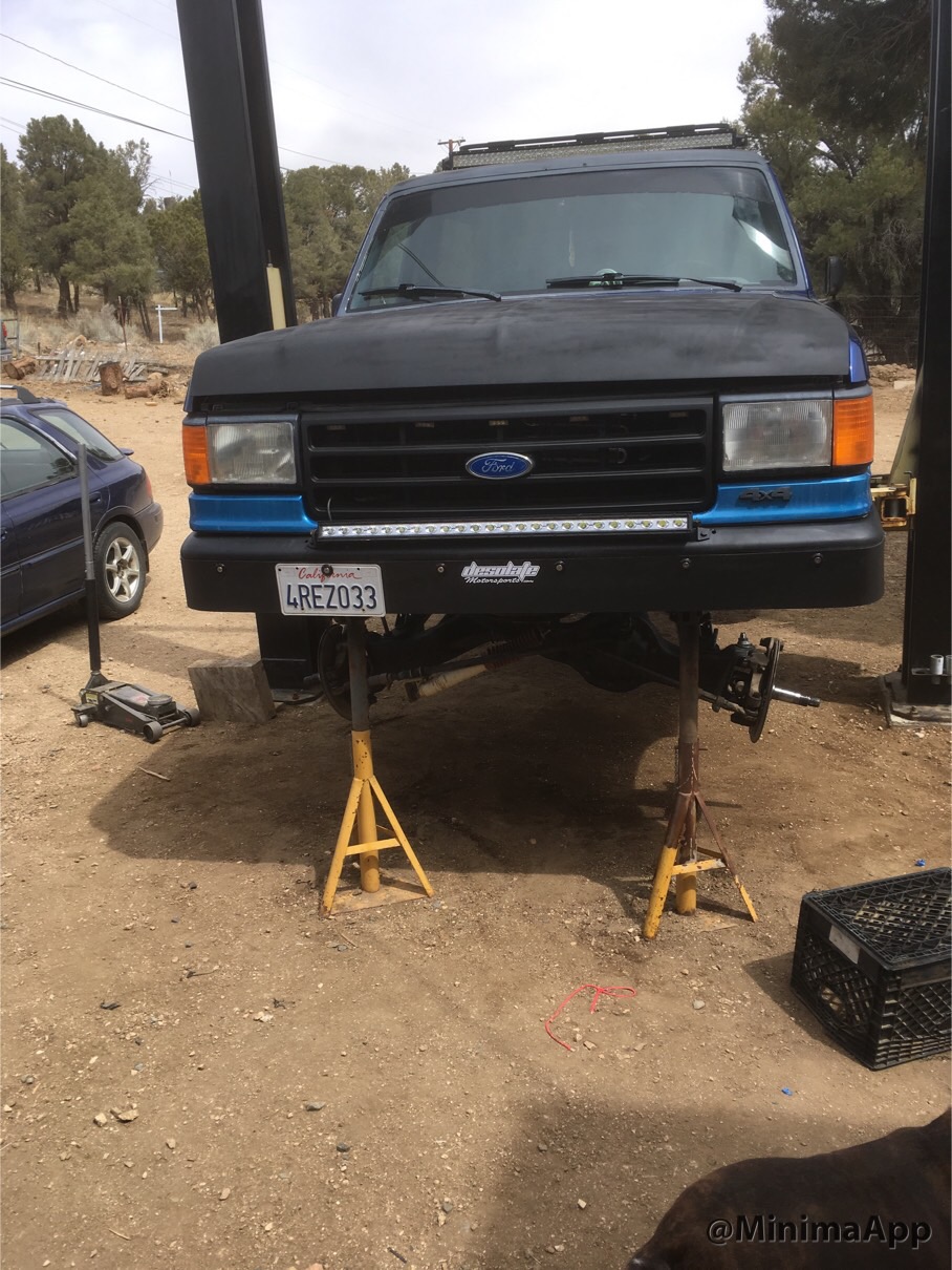

ya so this is what my local alignment shop charged me $100 to do and they tried to tell me that I needed to put drop brackets on my desolate c&t beams plus they say that -3degres is in spec ya little pissed!!
Called Greg at Desolate Motorsports and he took timeout of his day to help me out on the phone #bestbroncoshopever the best part is I flipped the cam and voila they match so I guess I’m an alignment dude any measurements from the peanut gallery will be appreciated
Ps I noticed a 1.5” difference in full droop between driver and passenger side cam that be my problem?
I installed this the other way he flipped it
The passenger side and driverside beams are different lengths so they will have different angles at droop. Although your shocks should limit the droop.
