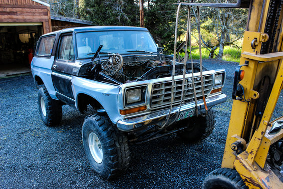

I got the go-fast bug from my Father (Archer66). Growing up in the back seat of his Bronco has me slightly attached to the old iron 78/79's. I fallowed his lead when I was 16 and bought a 79' of my own. Back then the only thing "going fast" was the money in my wallet and gas in the tank... so a "prerunner" style build was a little out of my league. I ended up with a run of the mill mud truck, 39's a 429ci and some half ton axles. It became immediately apparent that 1/2 tons were not up to the task of handling the torque of 429. After a grenaded 9" I forked out the cash for some 2003 Superduty 1-Ton axles. I'm lucky enough to have Jim Cole of Cage Offroad/Bloody Knuckle Garage as my brothers father in-law and close family friend, so I got a screaming deal on some radius arms/coils/coil buckets/dual shock hoops. Around the same time I had Gannin of "generation Transmissions" build a pretty bullet-proof C6 for it. Then I swapped a twin-stick Np205 in place of the chain drive Np203, and did a Sky shackle flip in the rear with a custom shock hoop, keeping them out of the tub. I ran it like this for about 6 months, made a few trips to the dunes and TSF and it performed awesome! On the last day before I shipped out for boot camp I was pulling away from a stop sign by my house and BANG! The engine sounded like a pair of boots tumbling around in a dryer, I shut it off and coasted into my driveway, got out to see oil shooting out of a hole on the oil pan... so the 429 was undoubtedly fubar. Unfortunately I have been stationed in Japan for the last 2 years so its been sitting untouched patiently waiting for some attention...

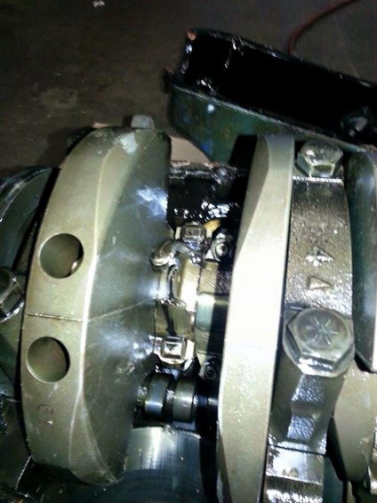

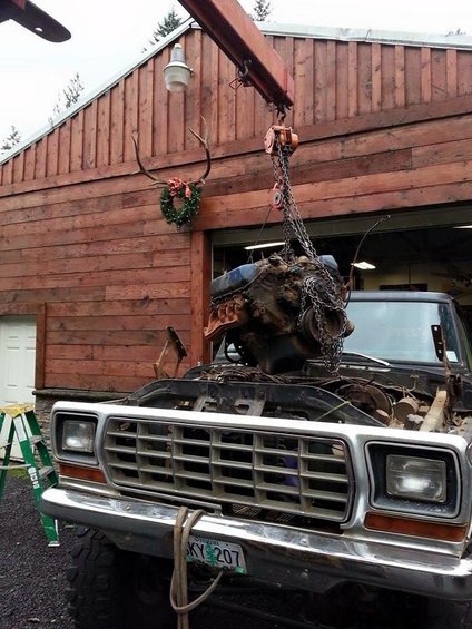

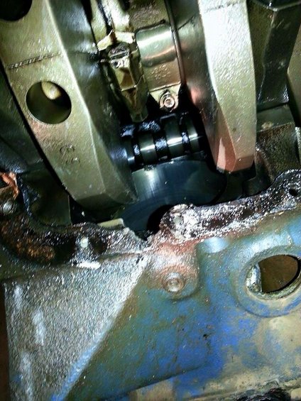

My Father was nice enough to pull the engine this week and asses the damage. Looks like a rod failed and took out part of the block on its way out. So my goal now is to have a pile of FoMoCo BBF goodies waiting for me when I go back stateside in April, and throw the motor together while i'm on leave.

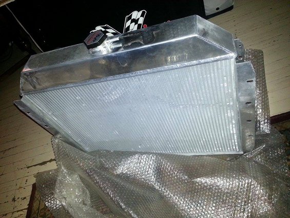

-4 Core aluminum radiator w/ electric fans

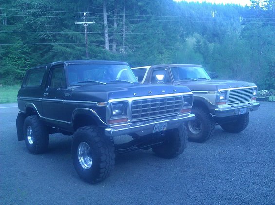

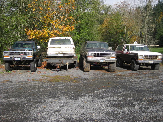

The man responsible for my addiction
When I first got it

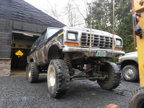

What brought upon the 1-Tons

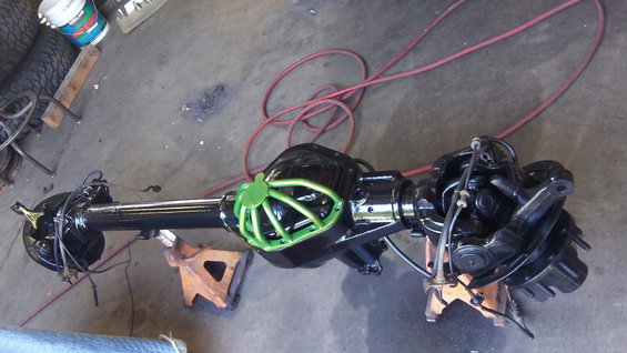

And the 1-Ton conversion

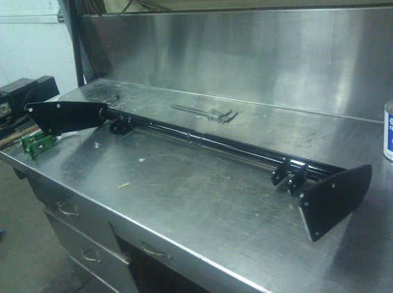

The rear shock mount

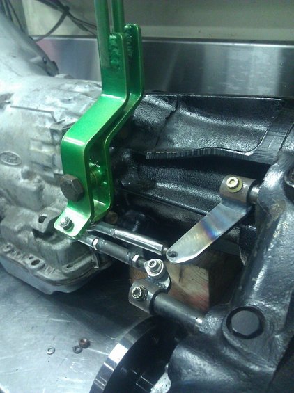

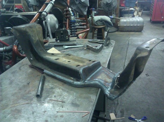

T-Case cross-member and driveline fab work.

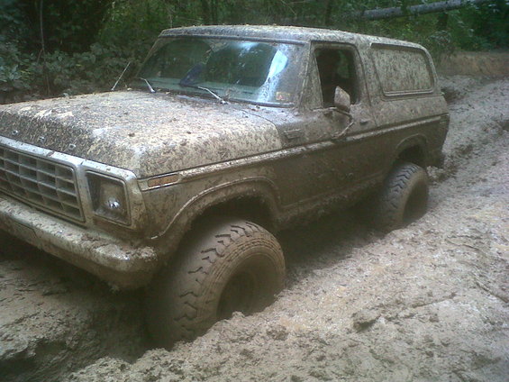

And out enjoying it!

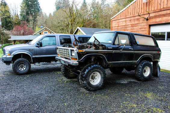

And finally... what that BANG was... :x :evil:

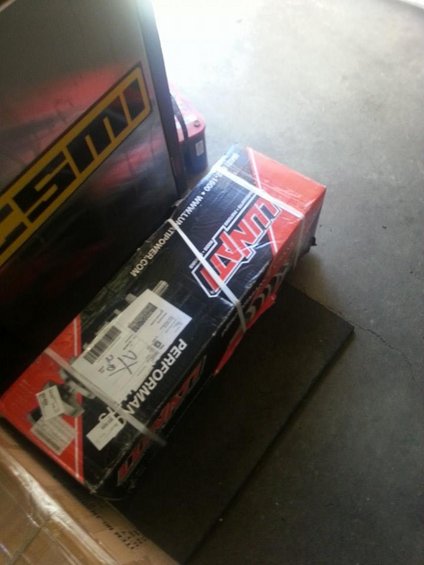

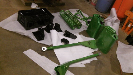

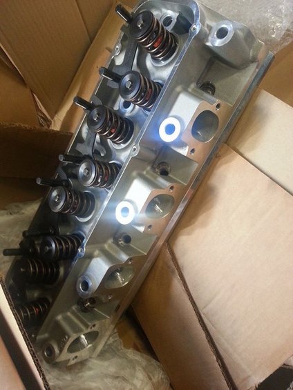

Theres some FoMoCo goodies showing up at my home stateside...

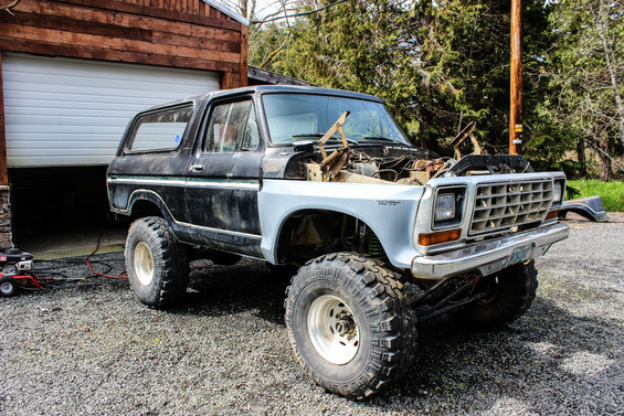

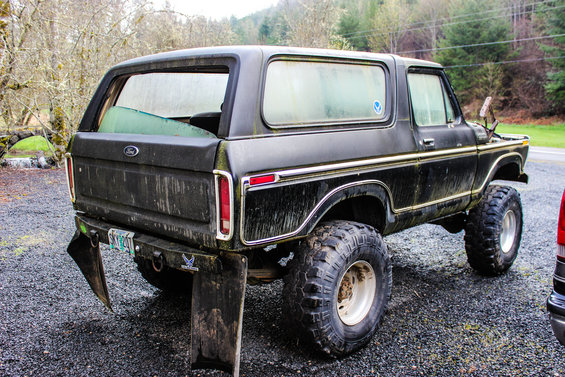

Well after 2 years i'm finally back home! It felt like Christmas came early this year coming home to a shop full of boxes... the Bronco was looking pretty rough, after sitting 2 years in the PNW. I took a pressure washer to it and knocked the moss off.

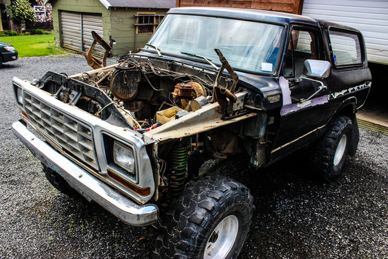

then I started the tear down for new fenders/paint

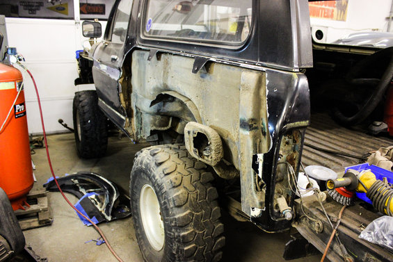

Then we laid out the plans for the rear quarters, and cut the stock quarters up... no turning back now!

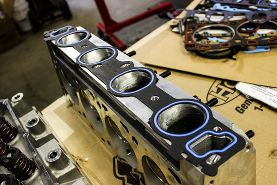

Then I worked on porting/gasket matching the Super Cobra Jet heads

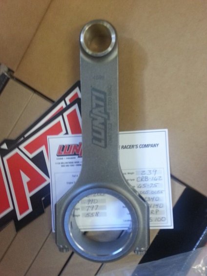

and a picture of the carnage from the old motor...
Should have the motor stuffed this weekend, and fired up next weekend!
Re: TRC's 79' build
Dang! Those rods! Nice to see you working on it.

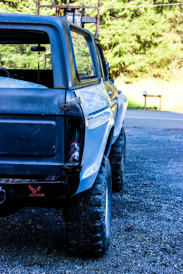

I haven't seen any other 78/79 with the rear Autofab quarters online, unless I missed it, which is very possible.
Couldnt help myself from slapping them on temporarily today to see how they look. I'm really happy with it. Should look good sitting 2-3" lower on 40's
Re: TRC's 79' build
