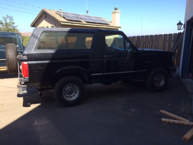

First off, its a 95 5.8 with MAF, 132k miles, new 31" BFG A/T's, interior is immaculate besides the seat bottoms, leather, power everything, and the E4OD. It was completely stock when I bought it with no signs of rust. It ran kind of rough and the rear axle was yelling at me going down the highway. Well, thanks to Randy (hobbyturnedobsession) he passed on an axle that is noise free and already installed. Thanks again Randy!! I did a full tune-up, plugs, wires, cap, rotor and coil and it runs like a champ now. I'm used to driving my truck, which i explained what I had done to it in my introduction thread, so this thing pretty gutless comparatively speaking.

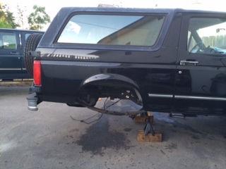

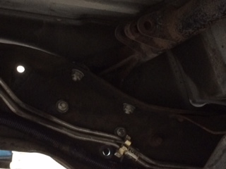

I have already purchased a set of used Nationals, Autofab upper shock mount, four doetsch tech shocks, and two-link kit from another user on here that posted it in the classifieds section. I figured while I had the axle out to replace it, I would install the upper mount since I had way more room. The install was a nightmare, the Autofab mount has mounting bolts that go through the top of frame as well as the side. It only located off of one shock mount bolt so I had to drill six holes, four of which had to go through the top portion of the frame. Of course I couldn't get a drill in there straight or from the top so I had to drill at an angle from the bottom so guestimations were in full effect. I got it in though and installed the doestch's. They are 13" shocks and at the stock leafs full drop, which I can push down more, there is only 9" of shock shaft showing and about 11" between the axle and bump. I'm gonna round down and say I could get 15" with the Nationals installed, maybe a bit more. Not too bad. Also have been looking at Kel-Fabs rear hanger and shackle, seems to be a good price and would help a ton with droop with the Nationals.

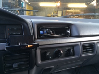

I put a new stereo in with a dock for my Sirius, getting new speakers, and will be either making a bock to fit behind the rear panel in one of the cubbies or put it where the center console is. I'm debating a tuffy console and building an extension to go to the dash as well. I'm getting a race radio from a buddy and I'd like to put it in the portion extended to the dash along with some gauges and switches and cup holders. I'd like to get a valve body as well to help the E4OD from grenading like my truck. Also have to clearance my drive shaft and build an exhaust. Mine is pretty rusty so I took it off. I think I'm gonna do a Magnaflow unless you guys recommend something else, I want it pretty mellow and just loud when I get on it. I had one my old Titan and loved it, so did my wife. I think I'm gonna run the exhaust out the side in front of the spring hanger and tire. The two link brackets hang low enough that it should protect it if I run into a rock or something. What do you like for exhaust routing? I will at some point also go to single swing steering, hopefully before something breaks or when the long side tie-rod bends. If the tie-rod bends then I can tell the wife that I am just replacing the cost so she won't mind, haha. And what gears do you guys like to run on a street legal rig? I know some say 4.56 and some 4.88. I'm leaning toward the 4.56 so I can have some decent street manners and still have bottom end for the sand.

- The beginning
- photo-3.JPG (93.76 KiB) Viewed 7865 times
- Axle out
- photo 1.JPG (33.95 KiB) Viewed 7865 times
- photo 2.JPG (36.4 KiB) Viewed 7865 times
- Upper mounts were a nightmare
- photo 3.JPG (24.08 KiB) Viewed 7865 times
- photo 4.JPG (38.34 KiB) Viewed 7865 times
- photo 5.JPG (34.46 KiB) Viewed 7865 times

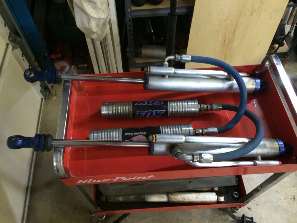

So I just picked up a pair of used Fox 2.5x12 2-tube bypasses for $500!! They need a rebuild and looked like hell when I picked them up but a little love from a nylon brush and some simple green have them looking pretty good. So know for the back I will need/want shackles and possibly a drop hanger and it will be done. Now I need to save my pennies for the front.
So for those of you that are running Fox's in the back, what valving are you running? I know fox doesn't do the standard shim measurements. I have read a lot run 8 compression and 12 rebound and start from there, but I don't know Fox's conversion for that. I could also call Fox sometime if you guys don't know.

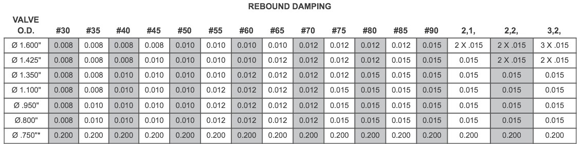

I found a chart for fox's. What valving would you do for other shocks? Was the 8 compression 12 rebound good? Or a different stack?

I hear. I'm definitely still interested in your front end when you're ready. And I could give john at autofab a call. He still runs under the bed and bypasses. I put the comparison charts up if anyone cares.
compression chart
rebound chart
compression chart
rebound chart

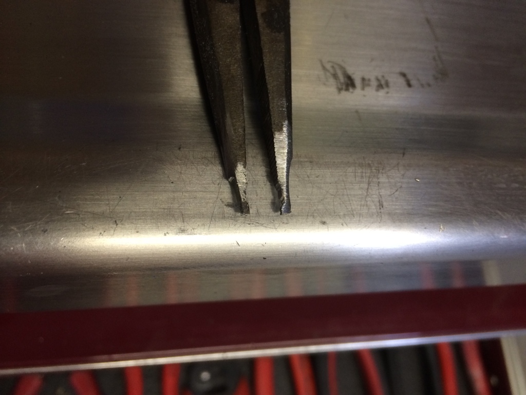

Got the bypasses rebuilt and scotch-brighted as good as I'm gonna worry about. Everything went good. Splurged on the viton seals too. Good lord the snap rings are a pain if you don't have the right pliers. I ended up modifying an old pair of needle nose it had laying around. Not pretty but worked better than the specific pliers.
And if you want a customer for life, send a coozie in my order and you got yourself one. Ha!
- Posts: 6028
Re: Nighthawk!
For my day job I modify tools constantly. Some tools aren't easy to locate quick or even available in a lot of cases and I applaud the ingenuity. Glad to see you made it happen.
