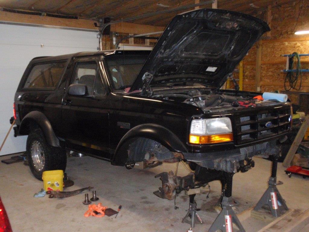

Now that the history is over; on to current state (don't want anyone to think that I have been sitting around doing nothing).

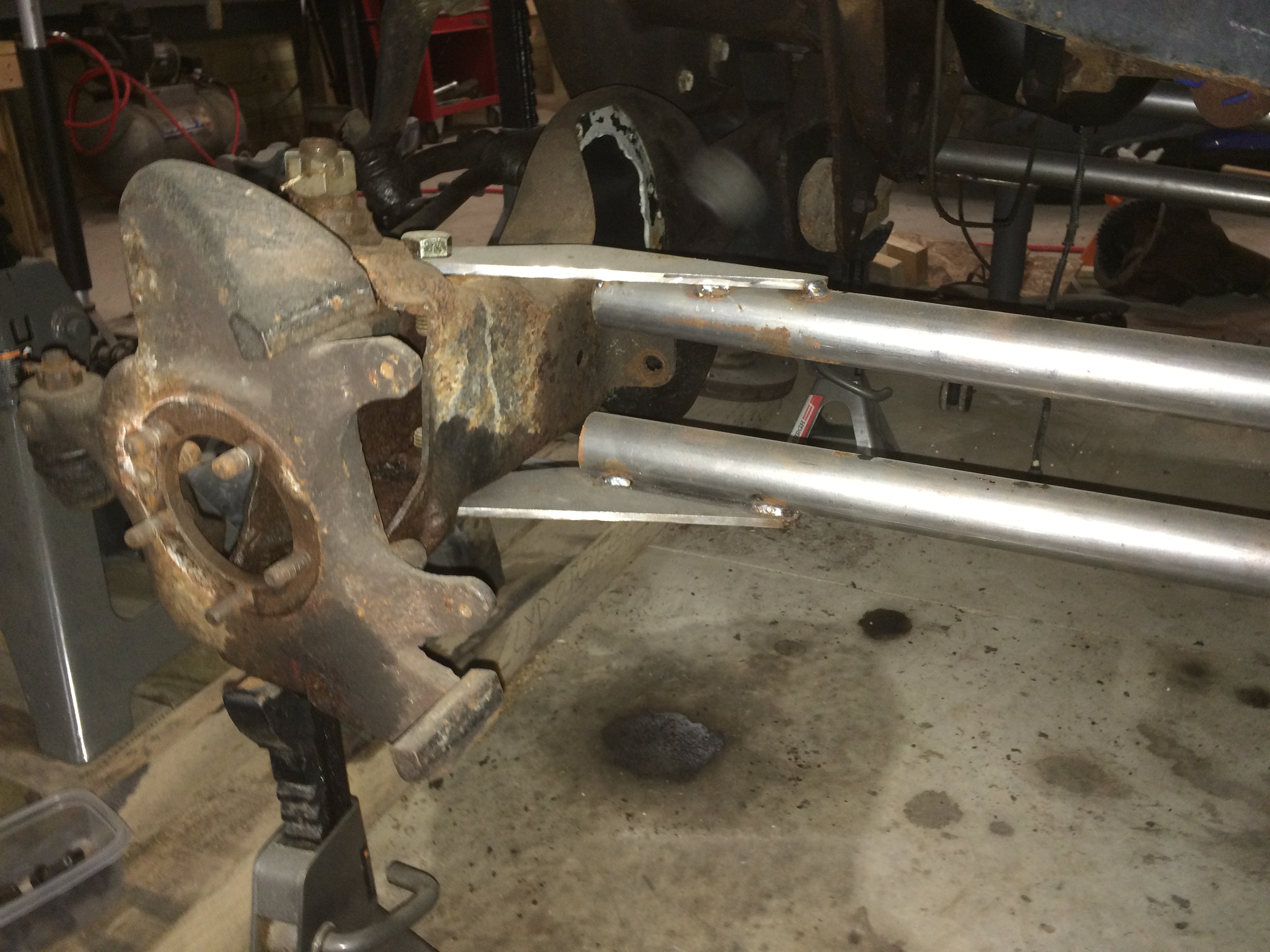

Here is the current state: Radius arm mounts fab'ed and tacked in place: Plates to attach the Radius arms to the beams. Thanks to jkrell for the dimensions that I forgot to measure because I was in a big stupid hurry: I stumbled across the King C/O's on race desert and they were never used and had a spring rate that I was happy to use; 400/450. When they showed up there were actually 250/300 and I figured that was way too soft. I called King and they were more than happy to exchange the springs for 350/500's as long as I paid shipping. I thought that was some impressive customer service considering I wasn't technically a customer of theirs. I am hoping to get the radius arms bent up and tacked together next week so I can cycle the suspension and get the fenders off. I marked the center of the hub with a plumb to the inner fender. It looks like I'm not going to be able to get the 2" forward move that I wanted. The pass side beam looks like it is going to hit the drivers side mount. Do you guys have any input on that?

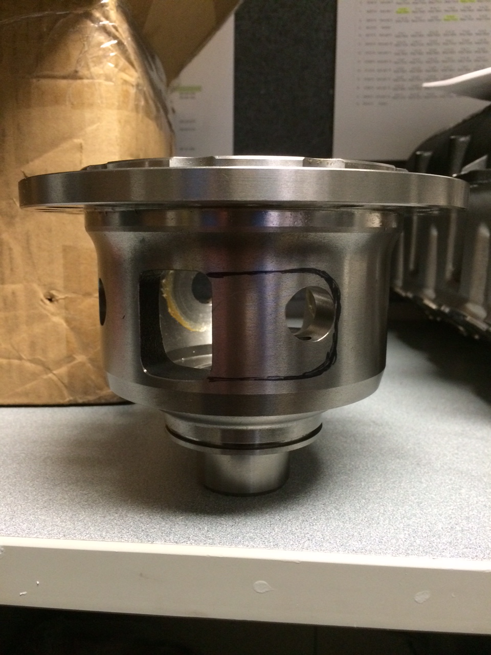

So it has been a whole year since I have posted anything here. School and work really kept me busy as well as a timing chain tensioner failure in my 07' Avalanche... It took 12 teeth off the cam gear and let the crankshaft go about 90° out of phase from the cam, it bent every intake valve and associated pushrod in the engine. Spent a little time on the snowmobile over the winter and now that school is over for the summer, I can get back to it again. Hoping to get it rolling and maybe to the dunes once this year with just the front suspension done, don't want to get too burned out. I have Radius arms loosely tacked together as well and thought I had a picture of those but will have to take one when I get home tonight.
- The area that will be machined away to allow the clip to be installed. This was a new 4-pinion e-locker but will be a 3 after the machine work is done.
- IMG_0041.JPG (334.22 KiB) Viewed 2405 times
- the clip on the F250 axle needed to be moved out toward the axle end about 0.150" to allow it to fit in the 3 pinion E-locker that's going in the front end.
- IMG_0023.JPG (341.79 KiB) Viewed 2405 times

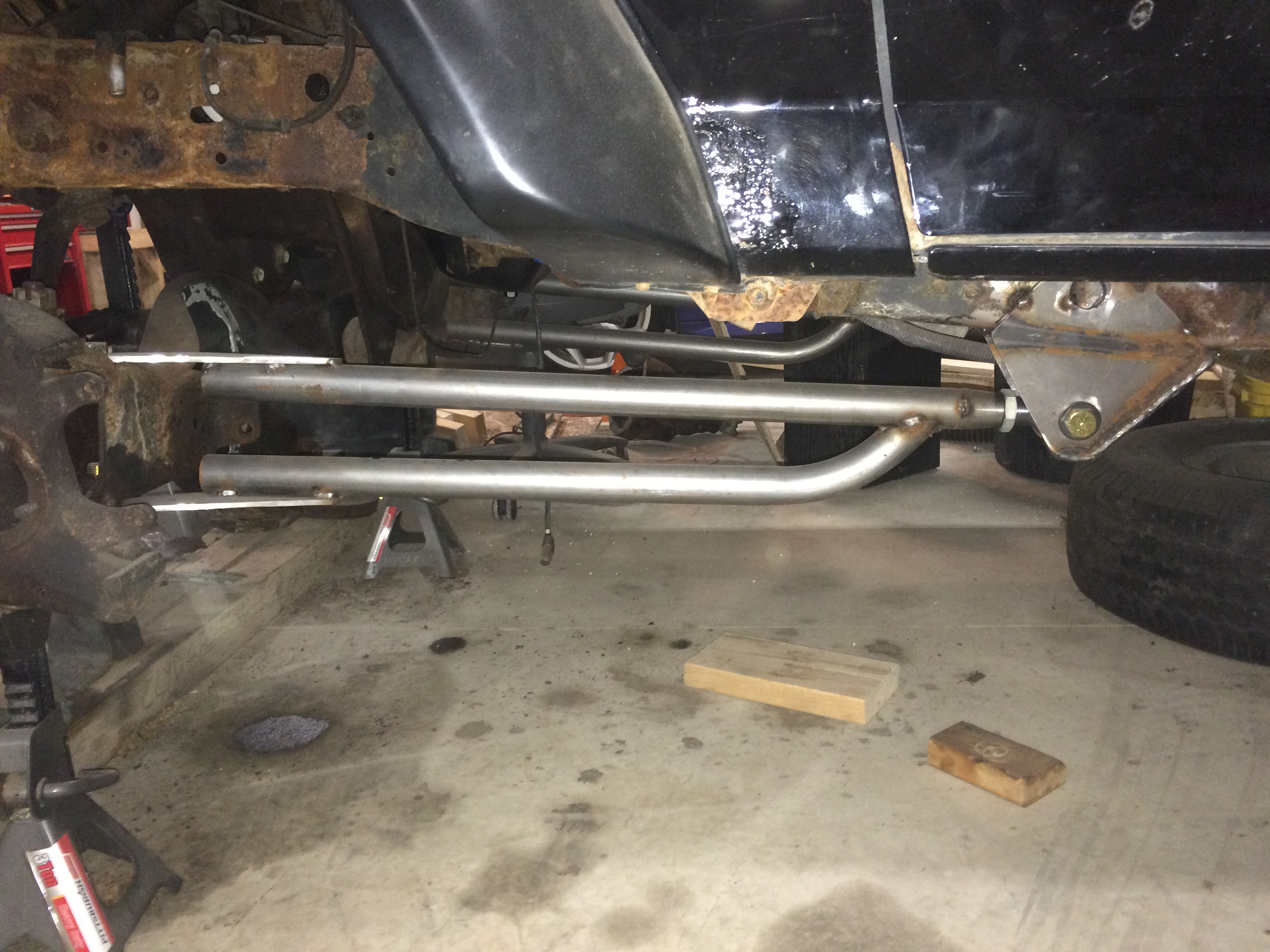

So I talked about the tacked together radius arms, pics are below. The intent is to put a plate that would cap the two tubes near the axle end and butt a gusset to this plate that would extend back to where the limiter strap is attached. There would be another gusset near the frame mount end but the arms will not be boxed. It seems like the only reason for boxing is to support against a twisting moment, I can't figure out where a twisting moment along the length would be generated from as long as there is no binding at the frame mounted heim joint. If someone knows or feels otherwise; please reply, any and all input is appreciated
- Heims end
- IMG_0046.JPG (1.7 MiB) Viewed 2384 times
- Axle end of arm
- IMG_0045.JPG (1.84 MiB) Viewed 2384 times
- The whole arm
- IMG_0047.JPG (1.88 MiB) Viewed 2384 times

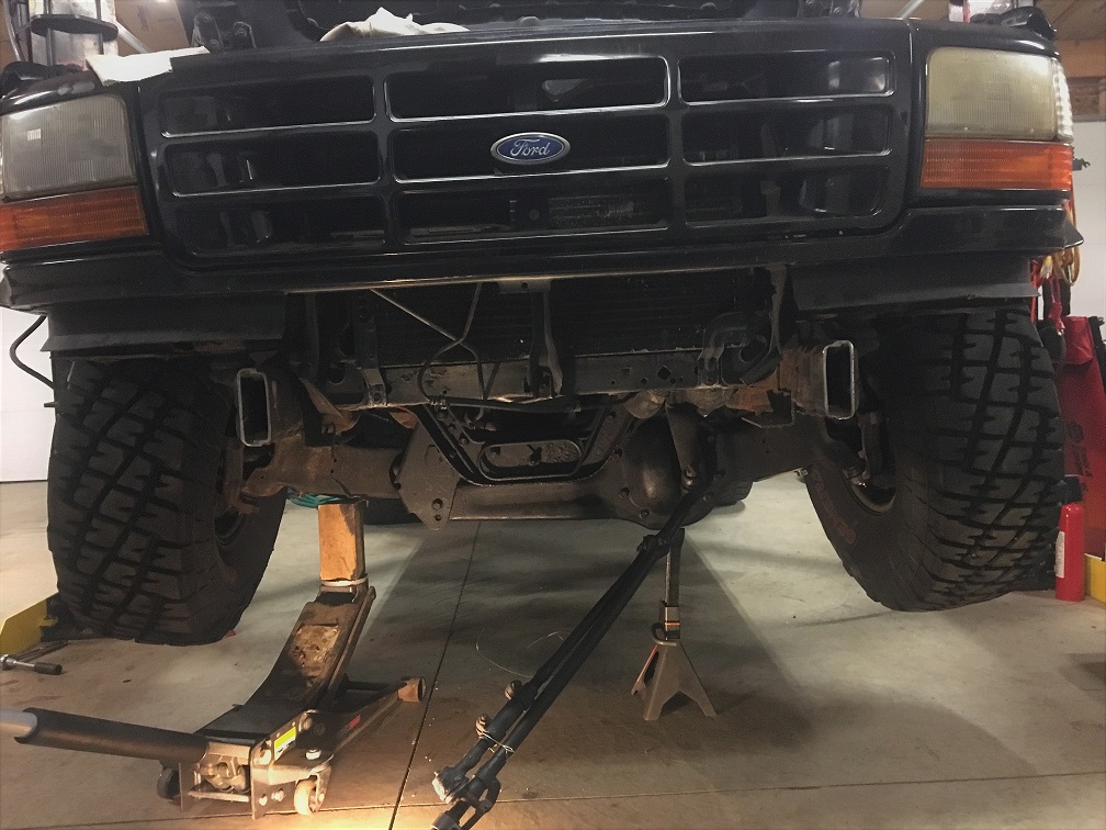

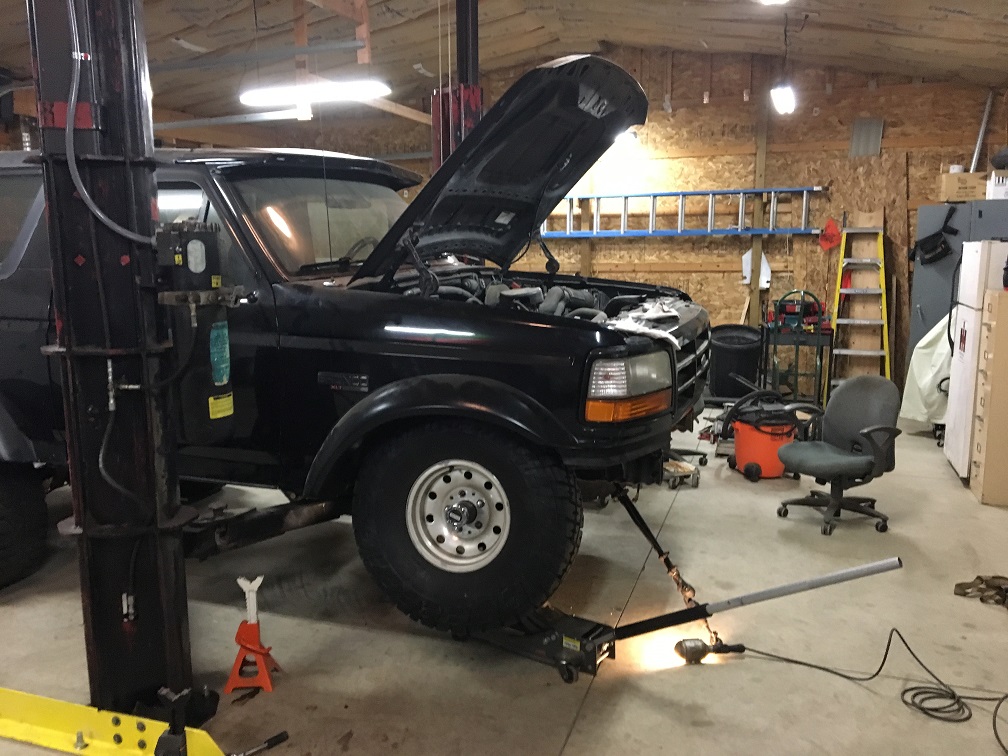

So I said it was going to be forever for me to finish this and I was serious...

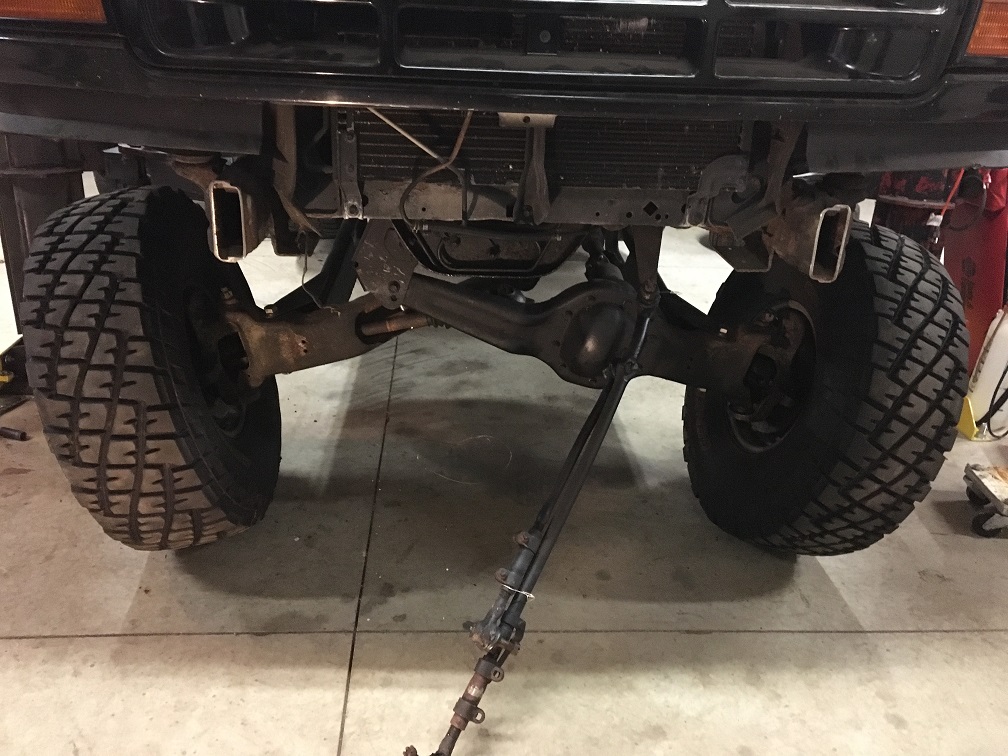

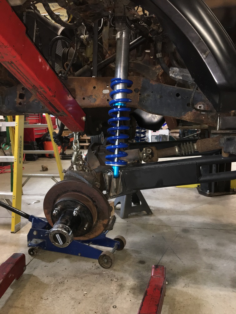

But there has been some progress recently. The radius arms are finished from a structural standpoint, lower shock mounts are tacked on and temporary shock hoops are in place for cycling purposes. It cycled 21 inches as a system but when each wheel was pushed through the full 21 inches independent of the other, problems arose. Particularly when the drivers side was at full droop and the passenger side was cycled toward full bump; the axle shaft would bind on the beam housing. I'm sure most of you guys already know this but I opened the window more and more and eventually decided to bump and strap the suspension travel to 18 inches.
See pictures below and please provide whatever input/criticism you have. Looking to get this as close to good as I can the first time!

Here are some Pics
- droop1 small.jpg (268.65 KiB) Viewed 2181 times
- bump2 small.jpg (262.1 KiB) Viewed 2181 times
- bump small.jpg (285.38 KiB) Viewed 2181 times

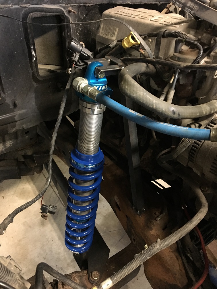

And some more of the suspension with the temporary shock hoops
- pass side hoop small.jpg (288.29 KiB) Viewed 2179 times
- Drv side small.jpg (325.19 KiB) Viewed 2179 times
- drv mount low small.jpg (270.22 KiB) Viewed 2179 times
