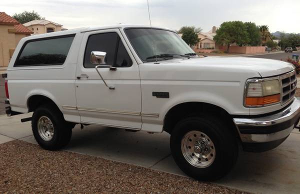

Ok, so if I am in the wrong place just put me out of my misery quickly. I want to set this truck up for day hunting trips in Az. The goal is to make the stock truck better for this. So, after what I have read.....I was thinking of rebuilding the front end and adding Moog CC824 springs. I have the Ford Alcoa rims (I think they are forged) which I want to keep. I was gonna run 33x10.50 to fit on those rims. Probably change the gears to 4.11s. Hopefully, install some kind of locker in the front. The truck already has manual hubs. The tires should weigh 47lbs and the springs are rated spring rate is 366 load is 1442. So, what I don't know is what shock to run and if this set up is as good as I think. From what I have read it would only take 1.75 degrees to align. I like to haul a$$ down these Az back roads to my hunt but, I need to keep the truck as a DD. I gotta get my kids to soccer and I want to go 80mph on the Interstate.
