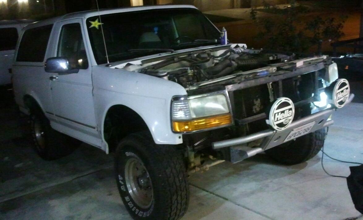

2000 bucks , with 136 k miles. Added a left over prerunner bumper I put on for temporary, then disassembly started.
2012-02-18 20.48.02-1.jpg (97.61 KiB) Viewed 7356 times

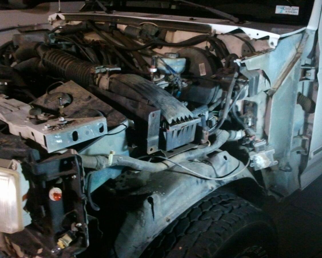

What a friggin mess! fabbed up some back yard specials to replace the quarter panels.
2012-02-18 20.51.03-1.jpg (116.62 KiB) Viewed 7355 times

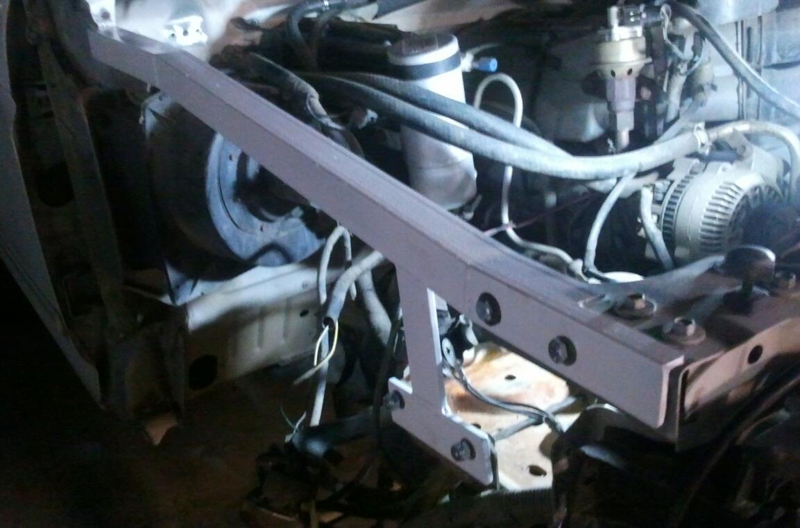

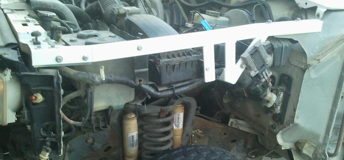

2012-02-25 17.16.24-1.jpg (68.01 KiB) Viewed 7352 times
2012-02-18 16.13.41-1.jpg (75.83 KiB) Viewed 7352 times

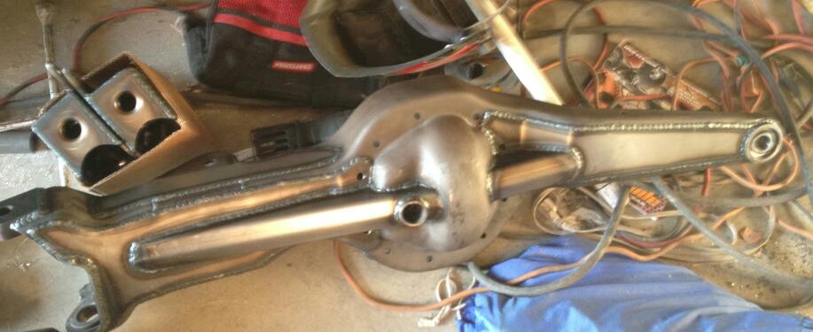

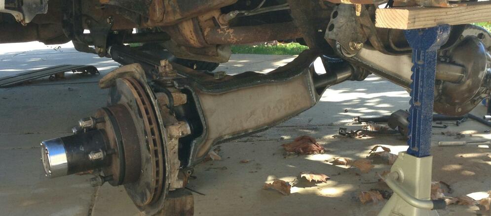

Next I added the bed sides, then parked it and stripped the front suspension. I sent the beams to dave over at threat and waited.... got the beams back.

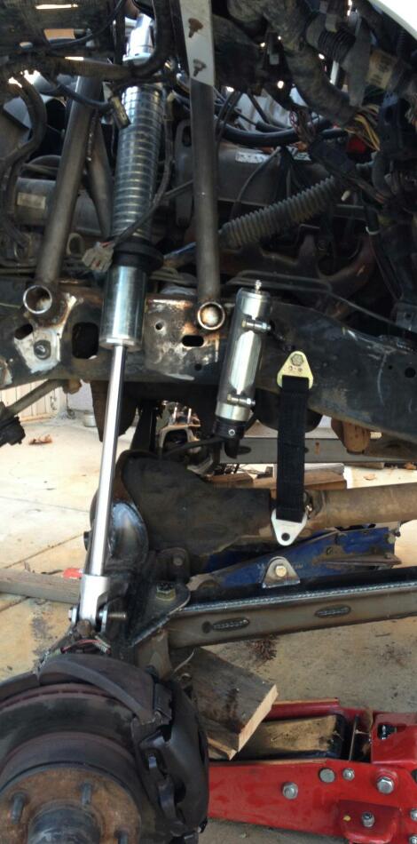

Next it got complicated... one of my asshole neighbors decided to call the city due to my bronco being on jackstands. Supposed child endangerment and a nice little wright up for abandoned or inoperable vehicle..... grrrr, anyway I made the ugly but functional coilover mounts after assembly.

I decided not to lengthen my own beams due to not wanting to deal with axel length issues.

....full tuck, I maintained full steering at full tuck and placed the coilover mounts from there.

Full droop

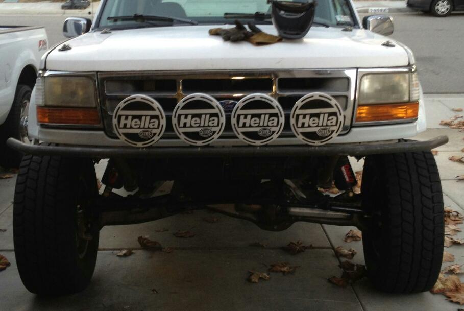

Next I put on the tires bled the breaks and drove it out of the driveway made a uturn and parked it, all to get city off my ass. Then once violation was dropped I started the front bumper.
Re: RMC's el hefe build.

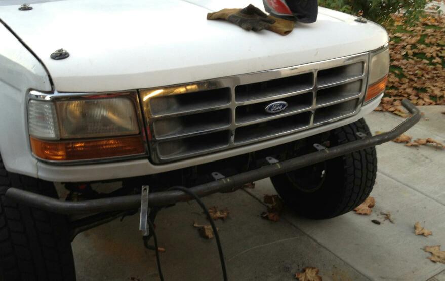

Bumper bumper

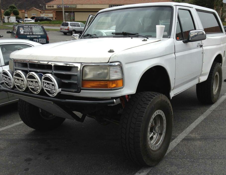

Front is choked at 16 from 18 3/4 from a 14inch coil over. Found the el jefe steeker at the local parts house, it made me laugh so I bought it.
Next up is going to be 37 inch goodyear mtr's and regearing it to 4.88, I also have recently purchased a set of deavers and some king 18x2.5' s ill post progress as I build it.
