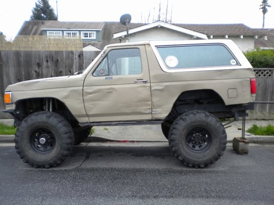

not like i needed another build thread, but i plan on spending a lot more time on this board than some of the others i have been frequenting. i'll start with the basic specs, throw in some pictures and update as i move along.
89 Bronco
351W, smog delete, homebrew AEM intake and true 3" exhaust, 9mm wires, MSD coil and cap
C6 with shift kit and cooler, manual shift BW1356, 5.13 diff gears
High Angle Driveline 1350 CV rear shaft, homebrew 10" slip 1330 front shaft
High Pinion Dana 60, Lock Rite, 35 spline cromo outers, stock inners/joints, MileMarker Hubs/S&N Fab drive flanges
GM 14 bolt rear, Detroit, Superior cromo shafts, Great Lakes Offroad cover
39.5 x 15 x 17" Interco TSLs, 17x9 Cragar soft 8's
14" travel shocks in front (Fox and Bilstein for now)
11" travel shocks in rear
Sky Manufacturing shackle flip, stock leafs
Rancho 4" lift 52" long K5 blazer springs in front
ghettofabulous cage
Crow harnesses
Lightforce 170s and Hella 500s
i will be strapping and bumping the front to 12-13" travel, and trying to get ~15" from the rear. still playing around with everything but that is the overall goal. right now, the front is limited to 8" uptravel before the axle truss hits the cross member.

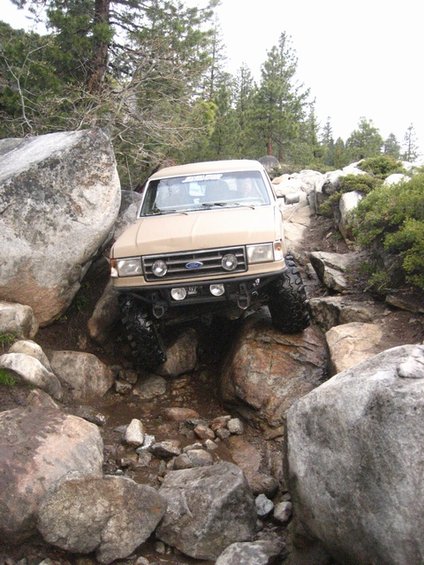

eiffel tower of the offroad world
no fiberglass fenders allowed in this neck of the woods...
Broncodawg
Posts: 711
Location: Bishop, CA
Re: Andys Magic Carpet
Post by Broncodawg »
Isn't that the old big sluice on the Rubicon? Nice ride!
magic carpet XLT
Posts: 145
Joined: Wed Dec 09, 2009 11:01 pm
Location: santa cruz
Post by magic carpet XLT »
Broncodawg wrote:Isn't that the old big sluice on the Rubicon? Nice ride!
yup, its one of many parts "you can't get a fullsize thru."

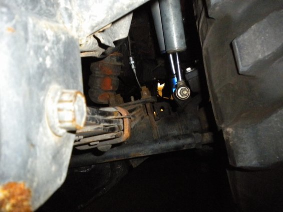

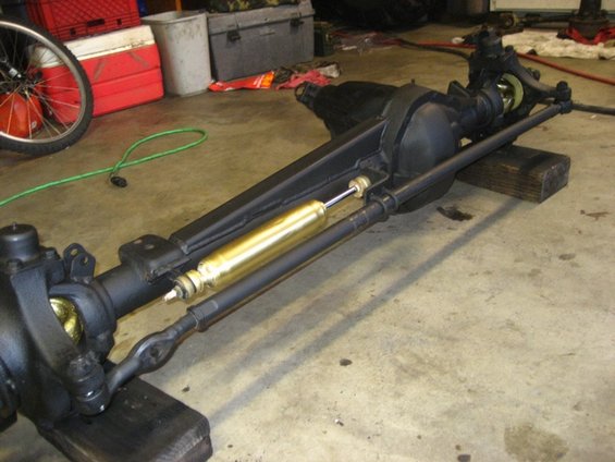

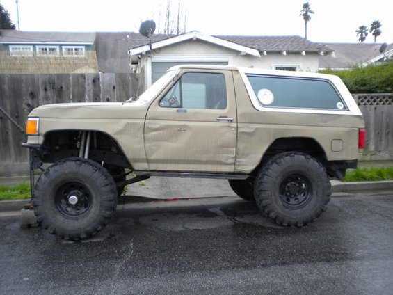

measured for limit straps. full droop in front:
full droop rear
travel numbers
~5" droop, ~8" up in front
~7" droop in rear, unknown up in rear (probably about 7")
i still need to stiffen the front up a little bit, it blows thru the travel too quickly. another leaf and more comp valving/less rebound should do the trick. i'm going to follow a tip from steve and swap the valving around in my fox shox from 50/80 comp/rebound to 80/50. hopefully less rebound will let the front end stay higher in the travel instead of packing up and more comp will obviously keep it higher as well.

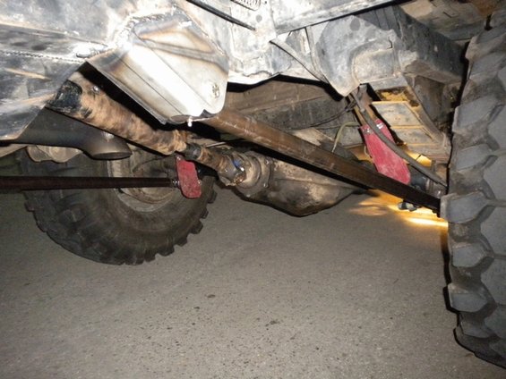

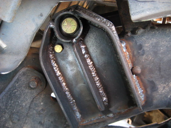

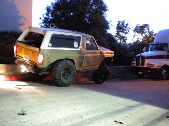

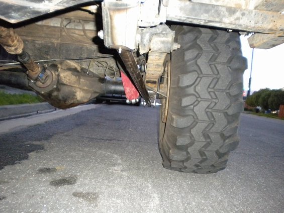

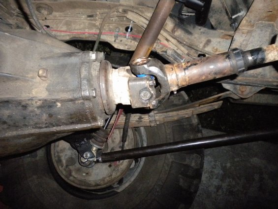

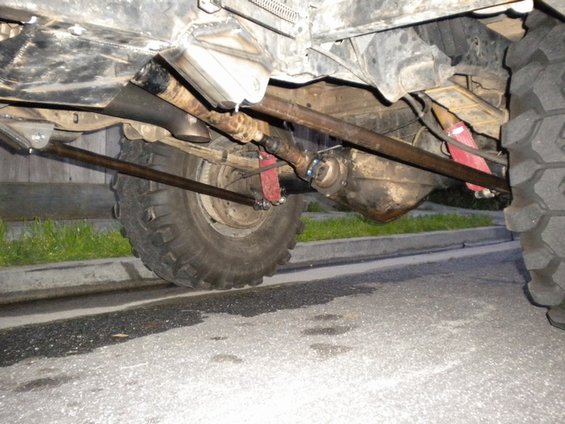

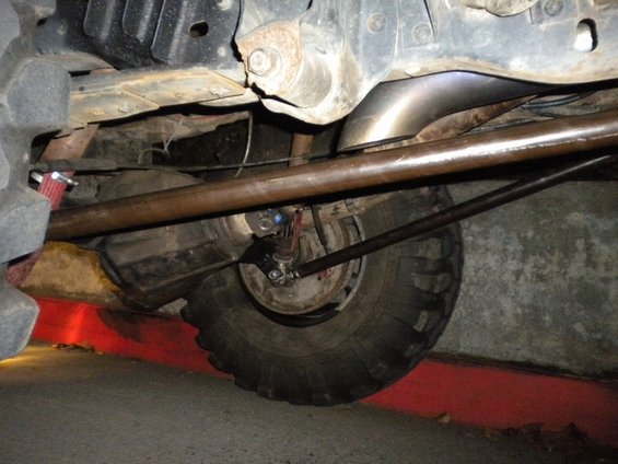

realized i haven't gotten any ramp pics in a while, so here is some loading dock fun from today. built a 2 link and it works excellent. way better road manners, less body roll, no more axle wrap or wheel hop turning blah blah blah i could go on for days. its getting real old reading thread after thread of people who think leafs don't flex...:haha
ride height
articulating
pinion angle at articulation
front springs
still a few inches of bump before full stuff

good call on the valving steve. i swapped the foxes to 80/50 with a couple .010 shims below it to act as a flutter stack and the front feels a lot better. looking forward to testing it in the desert.
